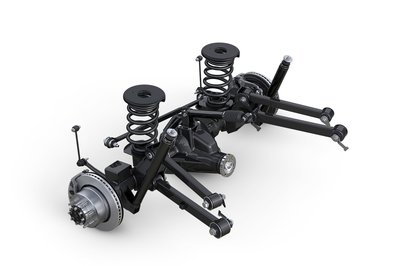

I grew up in an era where nearly all trucks had leaf springs front and rear. The use of a front sway bar started with the introduction of coil springs on HD trucks in the front. Sway bars became mandatory for the front once coils were used on the front of trucks. Only the heavy duty trucks got sway bars in the back. Yes shocks can help control sway, but lean is an entirely different story. Now the PW has coil springs in the back and no sway bar.
This lack of a sway bar combined with soft coils for articulation is where I think the issue really is. Air bags will help a ton, likely as much if not more than shocks alone. If you put on an OEM 2500 sway bar from the same year as your coil suspended truck along with air bags you likely will see things improve immensely in the towing and hauling department but it will kill your articulation. They should have put a sway bar disconnect front and rear on the PW. Then if we wanted to have heavy payloads we can put on air bags.

Re: 2014 Power Wagon Payload Capacity
Post by olyelr » Sat Nov 21, 2015 9:51 am
These two photo's I found on the internet show a sway bar.

My 15 has a rear sway bar stock. It is interesting off road with the front one disconnected you can feel the rear one working. I am planning on quick disconnects for the rear one. I do not see much of a reduction in articulation in the rear, those wheels drop right out of the fender well!
I do not see how you expect shocks to fix this problem. The difference is the springs, and not just because they are coils. The regular 2500s use coils and are rated for over double the payload of the PW models. I see two choices. You can swap out coils from a regular 2500 and probably use spacers to keep the ride height at PW levels or, you fit auxiliary air bags and set them according to the load. The stock shocks should work just fine. If you wore out the stock shocks by overloading the springs and found an improvement by changing shocks, those new shocks are on the same borrowed time. The spring rate needs to be increased to handle the additional load.

Well that photo explains why I didn't see one as it is all hidden by the axle if looking from the front of the rear tire at the suspension. That is a very small diameter sway bar, I bet the HD 2500 is bigger in diameter. Springs or airbags is about the only option for more payload. I think that I would look into airbag options if it were me. Either way you can't have everything in one package, you must sacrifice somewhere.
