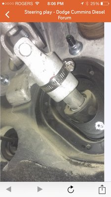

Hey all took a video if the intermediate shaft after the steering column. It appears it is a dowel encased in rubber holding creating a rubberized buffer between the two shafts this video was taken with the engine off and not very much force allows the bushing to deflect a lot. A guy on cummins forum decided to install to pieces of trimmed rubber hose around the dowel and then used a gear clamp around the whole thing to keep the rubber in place. Hope this helps anyone chasing down loose steering feeling. http://youtu.be/eRr9QF0w5_U

That very well be what my problem is, next on my list was the gear box but will check this out now. My steering is predictable but does have more play in it that I would like.
Edit* I just checked and, oh yeah, I have enough play that the pin has worn shiny spots on both sides of the collar. I will be correcting this situation this weekend.

Awsome will let me know how this goes! I'll be trying something similar also. I know while my trucks off the input to the box has a small amount of play but I was surprised I had this much deflection in this joint as well.

Is this with the stock steering shaft ? If so, then this may only be a temp solution. I used this to correct that issue & have not looked back since: http://www.amazon.com/Borgeson-951-Stee ... B004A675IA
The stock shaft on my truck was a 3 piece unit. Each piece was rubber isolated from the next. A REAL issue when rubber gets worn or cracks & dry rots.

I haven't forgotten about this, I tried a few different scrap pieces of hose I had laying around and dont have the correct size. One day I'll stop by a store and pick up a piece.

I was thinking about just cutting the hose vertically and rolling it inside there till she's good and snug.

Nice the pin might just be the fourth gen trucks I know dodge replaces those a lot for "loose" feeling in the steering as well now
Can also machine a small bushing up to place on one of the two spindles and hold it with a hose clamp and it will fix this weak point also

A couple of weekends ago when I was running switches through the firewall I noticed the "pin" through the steering shaft was off center. As I wiggled the wheel the pin moved from side to side. It took quite a bit of force and I could feel the rubber isolators dampening the movement. Something about it didn't seem right so I went ahead and used airhose to center the pin. The steering never felt loose persay but it did feel dampened. There is now less movement which should be less wear in the steering later.

I bought a short $10 air hose from Amazon and it fit perfectly (tight fit). I only used about 6".

Thought this thread was dead. Early on I used this:
TEKTON 46332 3/8-Inch I.D. by 3-Foot 250 PSI Rubber Lead-In Air Hose with 1/4-Inch MPT Ends, $8.49 & amazon. Cut the ends, saved them for later, & pounded in about a 4" piece with a small plastic mallet.
