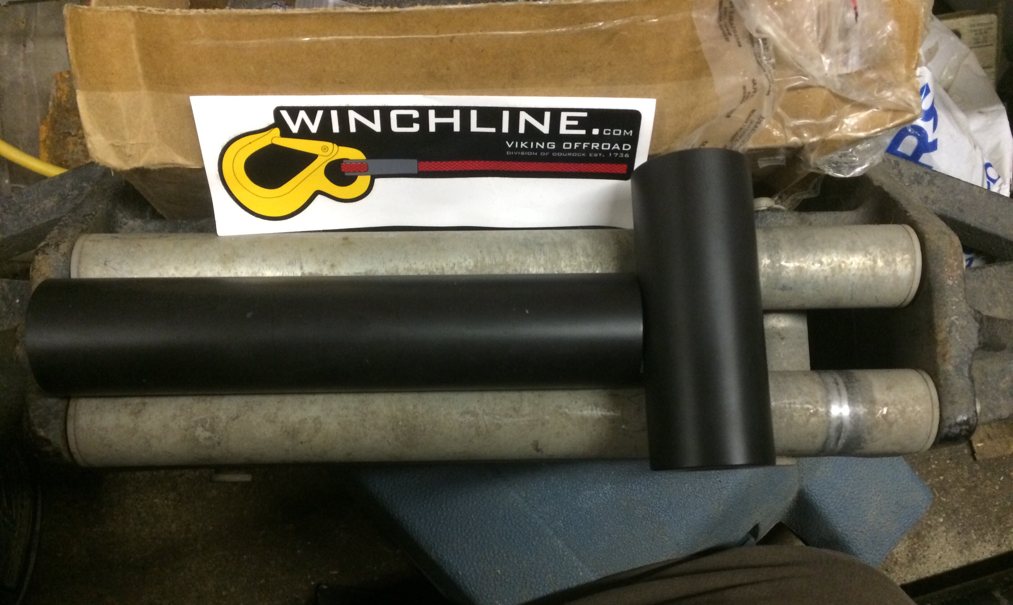

Hey all, I just purchased a synthetic line for my winch and I'm wanting to swap my stock chewed up steel rollers for some oh so smooth delrin pieces. There's a low volume/prototype friendly plastics machining company in town near me that I'm going to contact to make them as they're not available for our application already. Is there any interest from others for this? I would imagine that unit price would be less the more pieces are produced. I'm going to break out the tape measure and dial calipers and get on the horn with them probably next week. If there are any takers post up here. I'm doing it for myself for sure but saw an opportunity to give back to the community on this one, so maybe we can get a group buy going or something? :winchmob:

I bought a set of delrin rollers years ago. The closest size I could find. They never worked. That was in 08 though. I ended up just wrapping my steel rollers in electrical tape. They weren't gouged though

The delrin rollers I bought were the ones made for warns cradle for the m15000. They seemed closest. Nope. Too short by 1.5" on the horizontal and almost 3/4" vertical.

I apologize. Earlier I was going off of memory that apparently was wishful thinking. The long rollers were way to short and the short ones needed to get cut down. These were the ones recommended for the warn m15000. They obviously don't work

You could use one, but you would have to modify the mounting bracket or make an adapter to secure the hawse fairlead to the OEM cradle. The OEM rollers are built into the cradle.
Re: Delrin rollers for factory winch
Post by Colibri » Mon Aug 10, 2015 9:05 am
