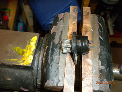

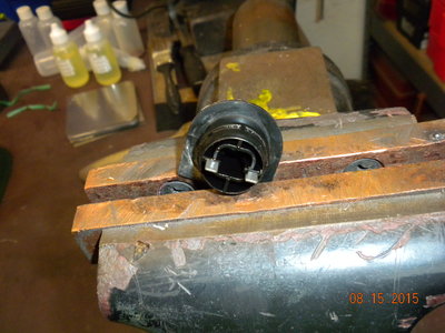

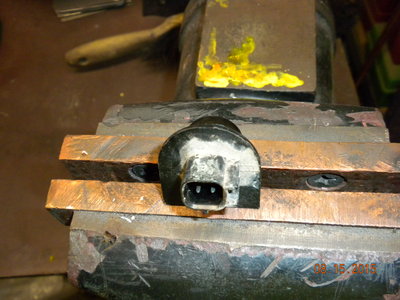

I just changed the sensor on my PW yesterday myself. Cost me $2.68 for it. My sensor has been out for about 2 years. LOL. There is no way to clog that sensor. What it is, is a conductivity probe with 2 metal tabs sticking out. How it works, is that when fluid is making contact with both tabs. It basically closes a circuit. When the fluid is not making contact with both tabs. You get the low level light (open circuit). I had to have the sensor on my '13 Grand Cherokee replaced a couple months ago. And the dealer told me it was from using the orange fluid. I've only used one jug of the orange in the GC. That was just before the sensor failed. I've always used the orange fluid in my PW, and that's been about 7 yrs.

This is what the sensor looks like.
