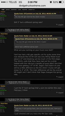

So I have been none too happy with my Carli springs as some of you know. Supposed to be a 3" kit and I only am 2.25" ish over stock. I've been told I'm crazy. I'm tired of the ride from these as I hit the hard coil rate going over a stick. Well I just found a post on dtx that made my decision. Tonight I am ordering thuren coils. Snapshot of the post below

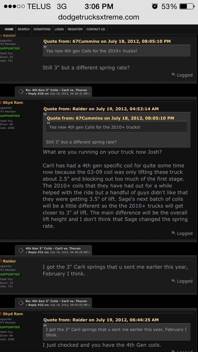

Neal,nts007 wrote:So I have been none too happy with my Carli springs as some of you know. Supposed to be a 3" kit and I only am 2.25" ish over stock. I've been told I'm crazy. I'm tired of the ride from these as I hit the hard coil rate going over a stick. Well I just found a post on dtx that made my decision. Tonight I am ordering thuren coils. Snapshot of the post below
That was my post on DTX.
I was explaining that the Carli 3rd Gen (03-09) coils only gave the heavier 4th Gen trucks around 2.5" of lift as opposed to the 2.75" of average lift that they gave to most 3rd Gens. So Sage made the expensive decision to develop a 4th Gen specific coil. This has nothing to do with the 03-09 coils that they built. I was asking the poster what coils he was running because early on a lot of 4th Gen guys were running the 3rd Gen coils.

Fair enough George. If I took that out of context I apologize. The way I read it was that the 03-09 coils were only netting 2.5" over stock. But then the reason I only have 2.25" over stock makes even less sense. And why my coil is so crooked.
