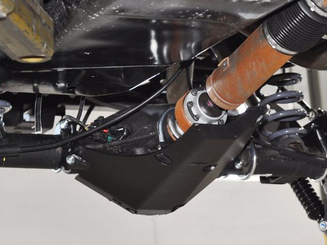

The differentials appear to be vunerable. What is a good choice for protecting these?

Mercenary Off Road can build additional skid plating & differential covers. DT ProFab & Dodge Off Road build stout differential covers as well.

I am pretty sure I'm going to install the purple cranium diff guards. I like the open design as they won't trap mud and water so much

Take a look at the DTProFab. It has one huge advantage over the PC rear guard - increased oil capacity.

After taking my PW off road for the first time this past weekend, I realized the importance of front and rear diff protectors. I looked at the DT Profab and then found AEV's protector with a skid plate, unfortunately from their website it seems that they only do that one for the Jeep. Anyone else might have a diff protector/slider for the PW? It seems to me with my rather limited off-roading experience that the slider would be a worth while sacrifice to losing the 1" or so of clearance to gain the ease of the diff sliding over a boulder vs. hitting and grinding the diff lip.

Todd at Mercenary does great work and is a good guy. He is where I got my bumper. For a diff gaurd, I have been very happy with the Carli guard, it has taken numerous hits with only some scratches to the finish, easily saved me more in repairs than it cost to purchase
