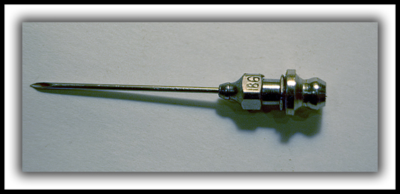

When taking your truck to the dealer make sure the front dive line cardan joint gets lubed. I took my truck for an oil change, the idiot kid lubed the carli ball joints which are not lubable on a stock truck but didn't even know about the cardan joint !
I will never trust the dealer again. :box:

I had to go buya special grease fitting just so I can grease it! I went and asked the dealer about where it is and the service person said there isn't one... So went in back and asked the head mech and he showed me on a new driveshaft. What a PITA!

Yes it is a pain. I've seen where someone used a paint marker and marked it. Otherwise I jack the front end up and put it on jack stands so I can turn it

It's really not to bad, just get a needle attachment for your grease gun.
I would grease mine every oil change before getting free spin hubs.
The one on my 1994 Dakota failed twice in 270,000+ miles even when lubing every oil change.

verdesardog wrote:It's really not to bad, just get a needle attachment for your grease gun.
This is probably a really dumb question how exactly does the grease fitting on the front driveshaft work? I picked up a needle attachment this weekend and was able to locate the fitting on the driveshaft, but I could not get the grease in there for some reason. It would just squirt all over the outside of the fitting. Is it supposed to push in or anything like that?

You should be able to push the little ball in a bit and the grease should go in, it'll be messy either way

You need a needle that is rigid enough for a pretty hard push. I got mine from Tractor Supply.
