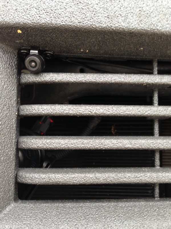

Im thinking about adding a camera and maybe sensors on the front of my truck and was wondering if anybody has done this yet? I dont really like the license plate frame camera and am looking for a more permenant mount. Any mounting ideas for the camera ? Thank's

I have a lockpick and added a front camera. Just a cheapo off amazon. Just search for 12v camera. Really nice when your nose goes way in the air while wheeling.

Re: Adding a front camera and sensors
Post by 04Ram2500Hemi » Tue Jan 27, 2015 6:33 pm

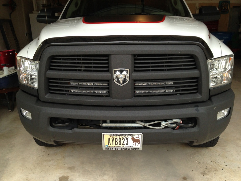

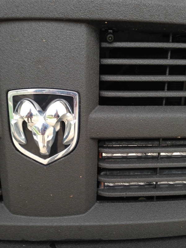

I didn't do the sensors but I did the camera. I didn't tilt it down as far as I could have to show the bumper because I had planned on getting a different off road bumper, but I've kind of put that on hold. Hopefully this helps you a little.
Post by dogcar3 » Tue Jan 27, 2015 9:03 pm
That is exactly where I put mine.
Post by 04Ram2500Hemi » Tue Jan 27, 2015 10:22 pm
dogcar3 wrote:That is exactly where I put mine.
We're you able to angle yours so you can see the front of the bumper?

04Ram2500Hemi wrote:I didn't do the sensors but I did the camera. I didn't tilt it down as far as I could have to show the bumper because I had planned on getting a different off road bumper, but I've kind of put that on hold. Hopefully this helps you a little.
That's where I was thinking about putting it and was wondering if it could be connected to the stock video screen. Was that difficult to connect? I really dont want another screen on the dash. Thanks for tour help and idea's.
Post by 04Ram2500Hemi » Wed Jan 28, 2015 10:10 am
I bought NAV-TV so that I could hook the camera up to the screen. It also opened up all the Nav features so I can actually use it while I'm driving. It's pretty simple to use. I push the power button twice and the backup camera comes on. Push it a couple more times to shut off the back up camera and turn on the front camera, and then a couple more pushes puts it back to the main screen. The backup camera still comes on when I put it in reverse, but if I'm towing something and want to double check the load because I can't see something while I'm driving I can activate the backup camera.

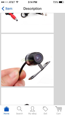

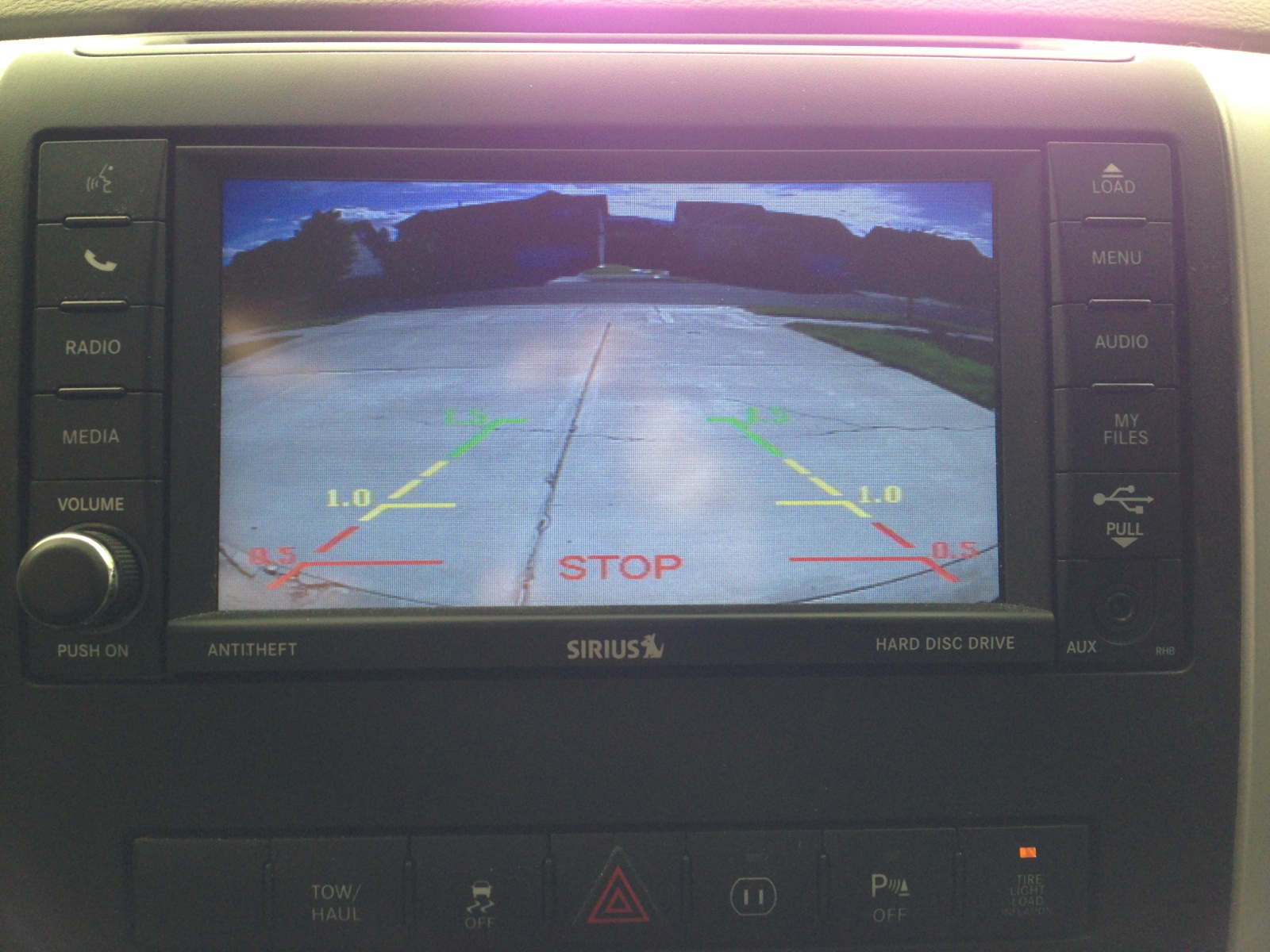

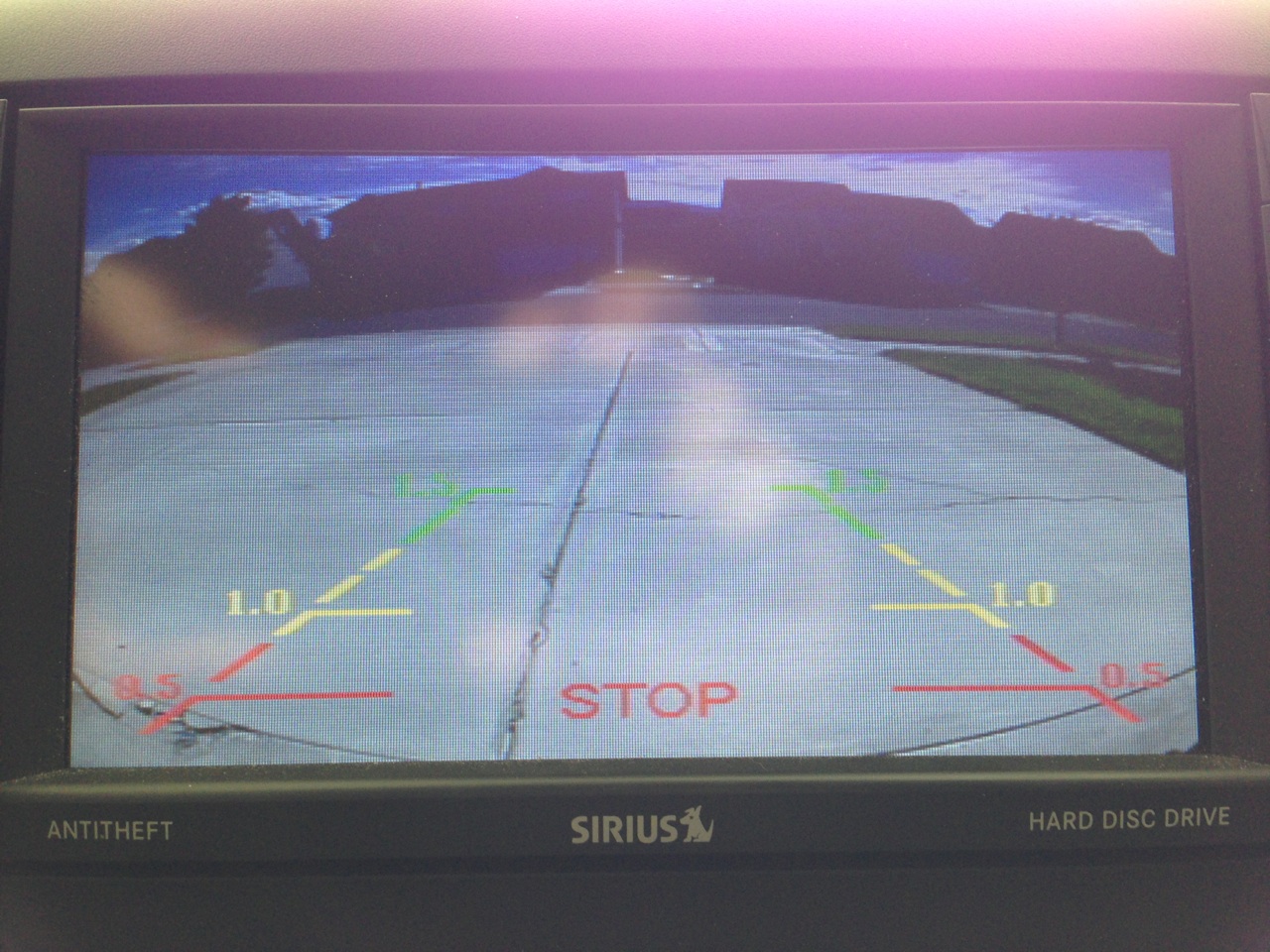

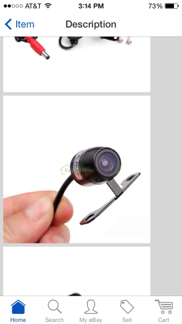

Ok I have a question. I have a lockpick and installed a front camera today but the image is backwards. Sounds like not a big deal but it is really strange when you're turning left and the image goes right. Especially if your using the camera to avoid an obstacle. Does anyone know how to reverse the image??
dogcar3
Posts: 261
Joined: Thu Sep 20, 2012 4:55 pm
Post by dogcar3 » Sat Feb 21, 2015 2:32 pm
What camera did you get?
2012 Beast.
autogateman
Posts: 183
Joined: Thu May 01, 2014 11:15 pm
Location: Maurepas La
Post by autogateman » Sat Feb 21, 2015 4:14 pm
I bought one off of eBay that looks to be the exact one they sell. I think I may have to buy one that can be reversed through the camera.
