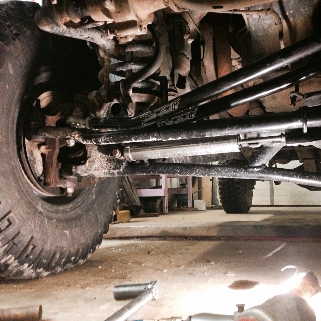

I've done the Carli ball-joint, Dynatrack freespin hubs, and RCV axle mod.
There is a thread over on DT about what I did.
I've abused the crap out of it too with NO problems.

That's the ticket RustyPW. Very happy with those mods on mine also.

The dynatrac bj's and some decent u joints may save your wheel bearings. also maybe add a grease zerk to the bearings. Free spin is ideal and will obviously extend your u joint life if you leave it free spinning also save some prop shaft wear too. As for the front end bending-don't smash whoops and jump it if it's your DD.
