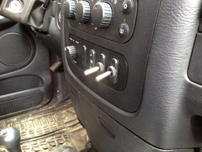

Hey guys I know this is a late update but I just hard wired my lockers and converted the sway bar to manual. I was tired of all the back and fourth working and not working....
Re: swaybar disconnect
Are you happy with with the manual stabilizer? Did you know how to wire the lockers or did you use some of the info/instructions from the site, or elsewhere? I think I want to hard wire mine but I'm not crazy about doing the wiring myself. I'm definitely not a mechanic. Can do some simple stuff but I'm a little wary of wiring. If there are simple instructions somewhere I'd appreciate you pointing me to them. Thanks.

Hey I found the disconnect works great! You turn the knob all the way in hop in the truck and back up and listen for a pop. Almost instantly is disconnects to reconnect turn it all the way out hop in the truck drive around a little bit and you will here it reconnect. I've also attached another useful link for the hardwire details. It's pretty straight forward where you decide to ground it is up to you. I grounded both locker connections using one of the pre existing grounding bolts by the battery.
http://www.dodgetalk.com/forums/showthr ... ost4632642

Well...I got about 3/4 of the way through wiring my lockers and ran into a slight problem. I found the wiring harness that contains the rear locker wires, found the yellow with white source wire but when I tried to locate the yellow with gray wire I'm not seeing it. I admit I'm somewhat color blind but the wire that was wrapped closely to the yellow/white wire looked a little purple-ish gray.
Is the wire I'm looking for light gray or dark gray? I'm hoping someone says it looked purple-ish to them also.
