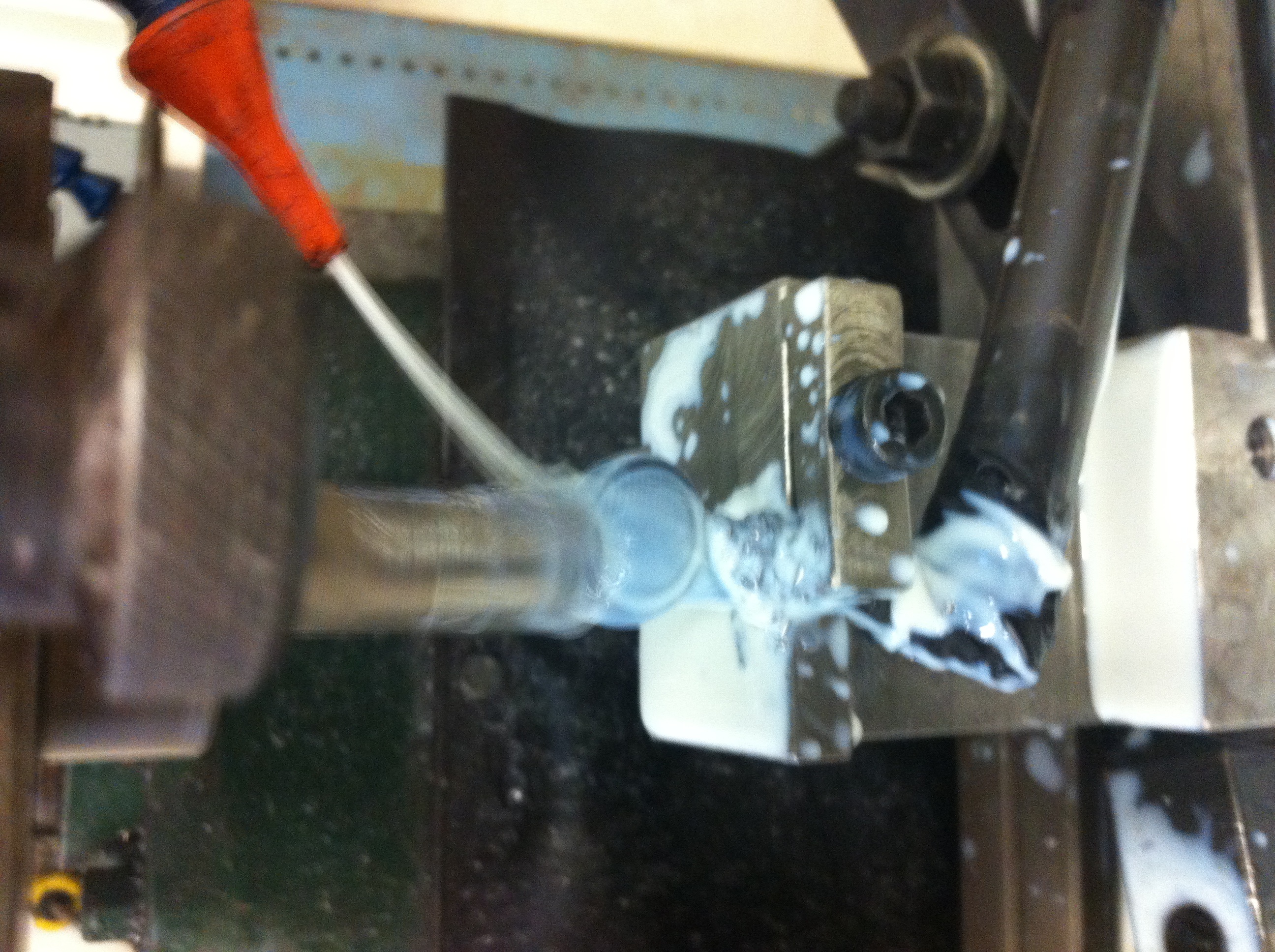

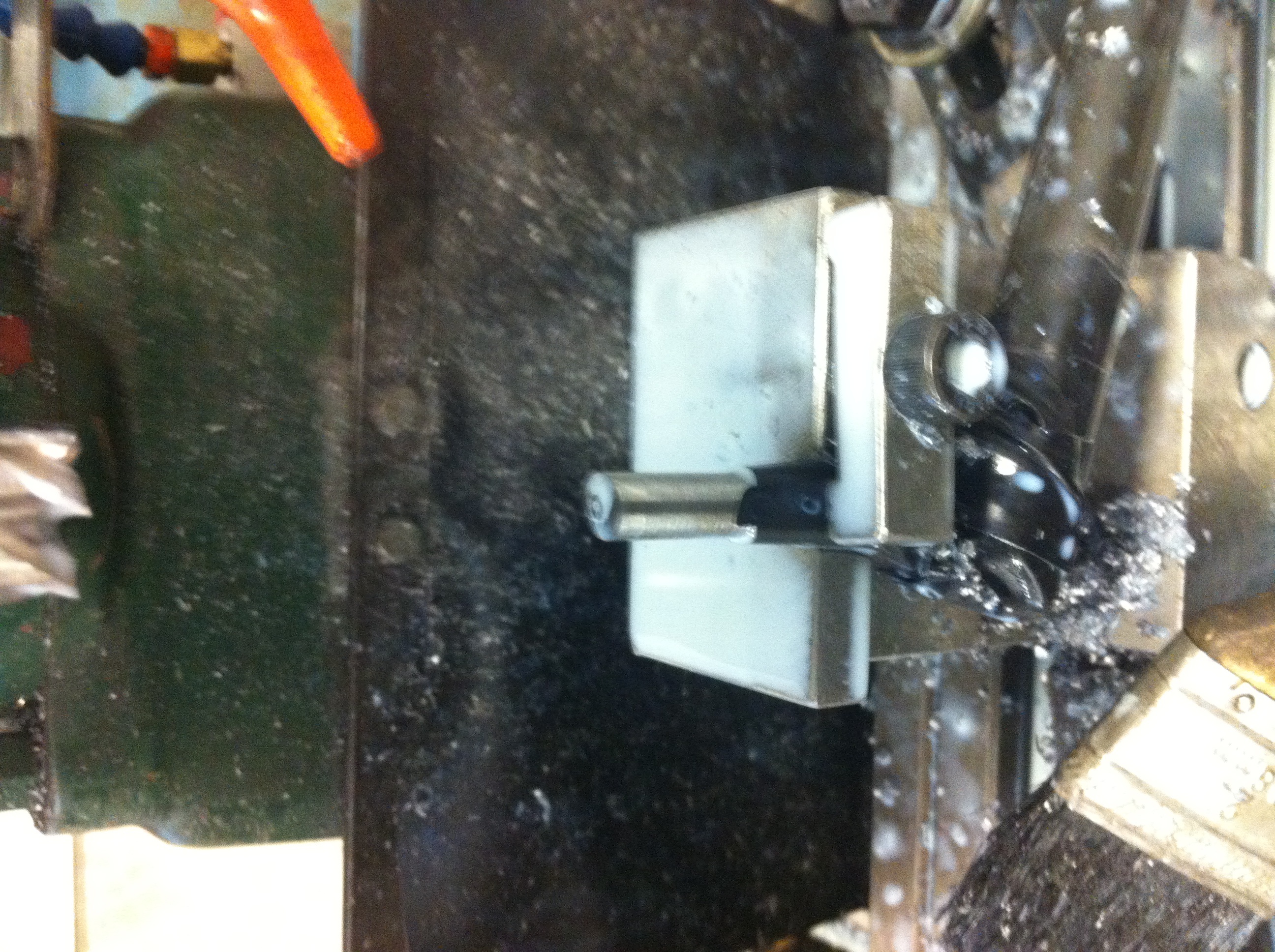

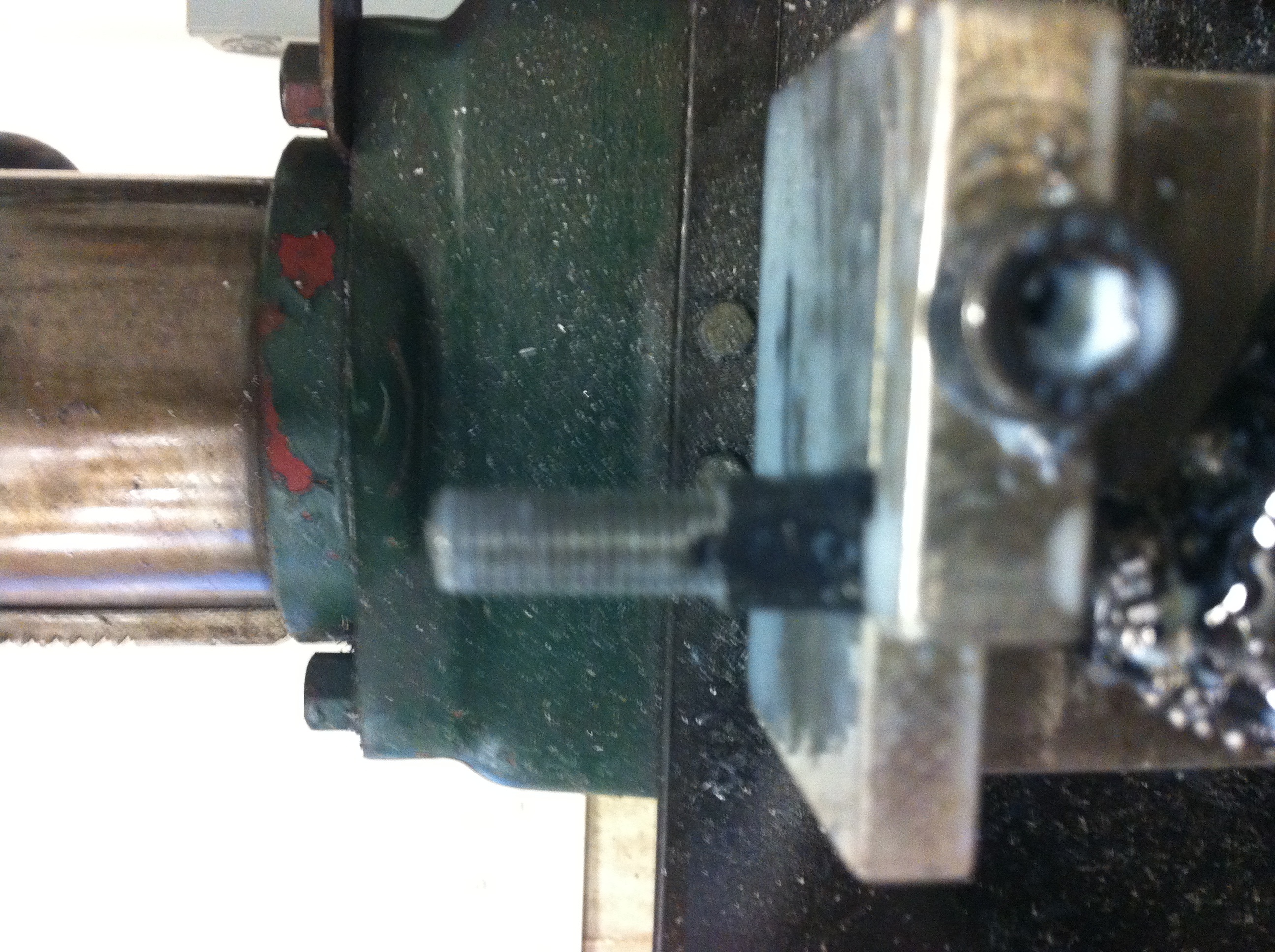

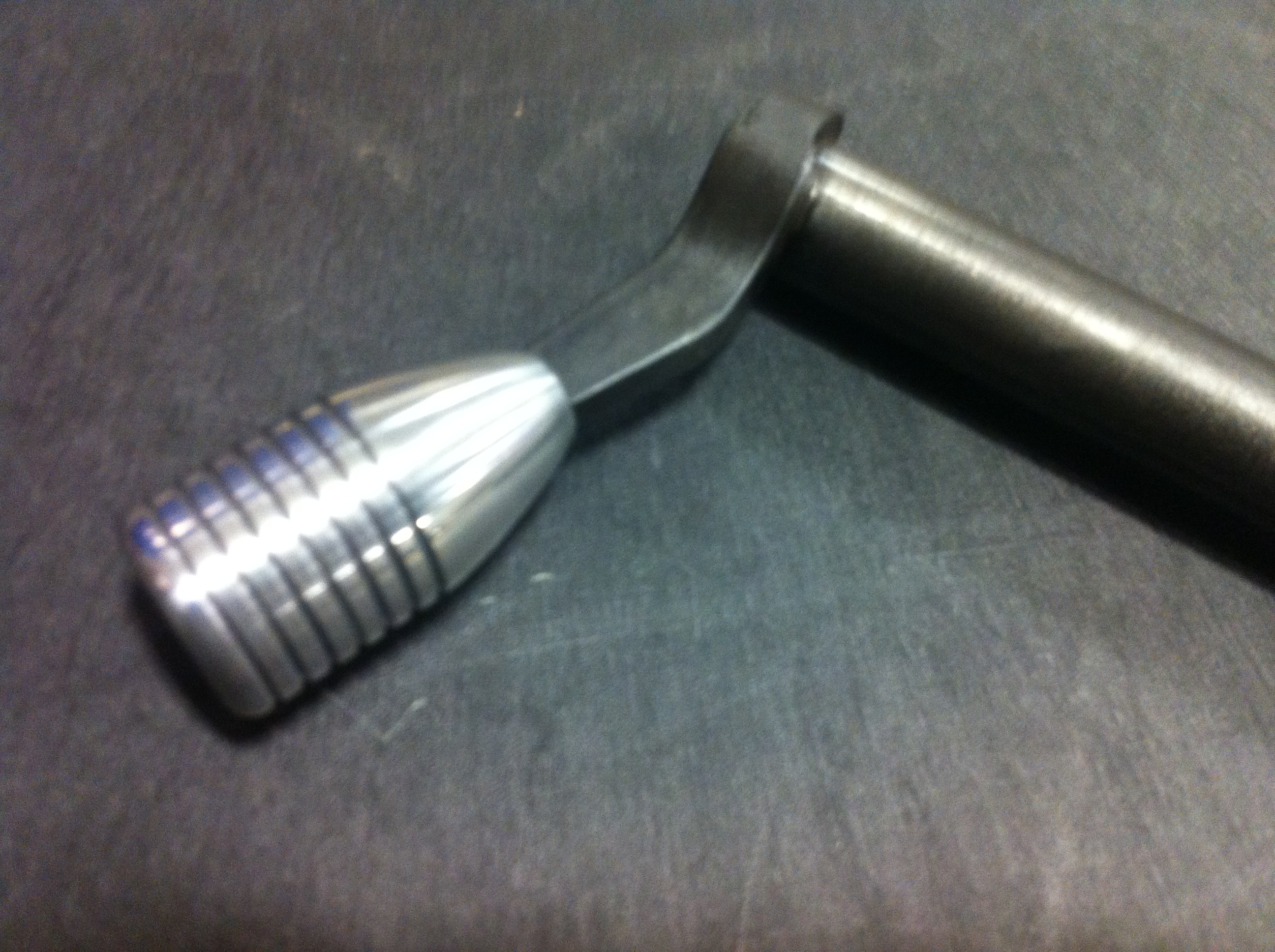

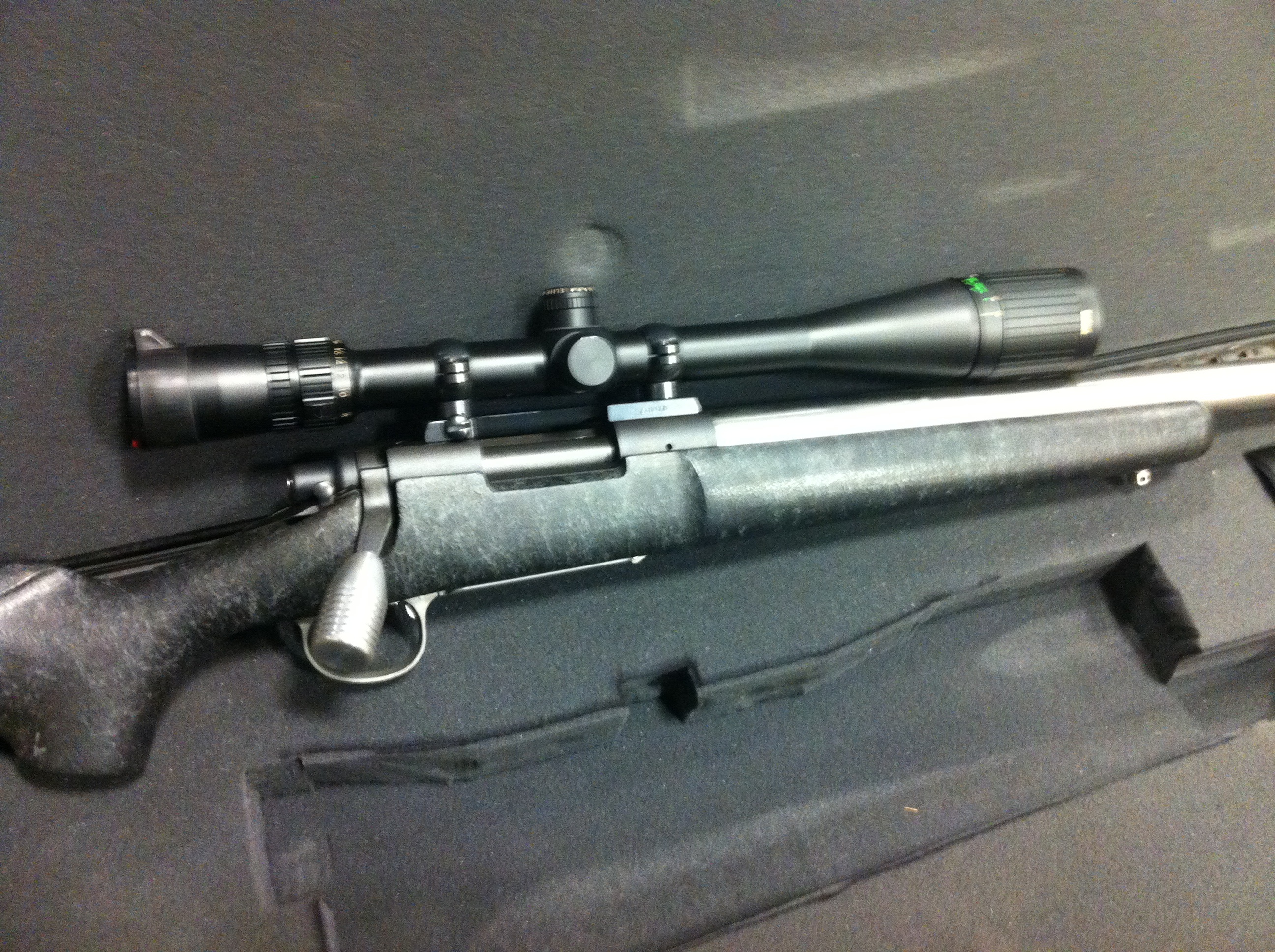

I know this is not a Power Wagon related thread just wanted to share what kept me busy yesterday.
Removing old knob with hollow endmill
Removed
Threaded
Knob was made from scrap 1" solid 6061 aluminum
Now my Remington is finally totally custom no piece is factory or not modified
