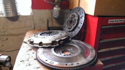

**UPDATE**
Problem found, pressure plate failed (Collapsed?), now I am talking with Chrysler/ram because it is a mechanical failure....and from the look of it has been bad for a long time/possible day 1.
They said it looks like it might have been slipping for a while and I may never have noticed it due to the gearing this thing has.
T.O.B. is noisy as hell and the flywheel is done as whell...I am hoping Chrysler/Ram will help me out on this.

Thanks for the response, I am really hoping Ram comes through and covers it under warranty so I am only out $150 deductible. If I have to pay (which I plan to fight tooth and nail if need be) I really think it would be better to go centerforce (more heavy duty).MSparks909 wrote:Finally responded to your PM 08. Sorry I was a little late. Hopefully Ram will work with you on the pressure plate issue. Still gonna run the Centerforce? And the Centerforce guys told me the exact opposite thing...they said the noise was because of the weights. At idle there isn't enough centrifugal force to spin the weights outboard, so at idle they rattle. Push in the clutch or increase the RPM's and the noise goes away.
Funny about centerforce's response being different, the guy told me they put the clutch on a lath and ran it 150RPM and they made noise, they bumped it to 300RPM and it went away is what they told me. He told me there more of a chance of hearing gear roll over in the trans that the clutch making noise.
For the cummings set up but still
http://www.southbendclutch.com/images/c ... notice.jpg
http://www.valairinc.com/performance/G56%20terms.html
I can say my tranny has always been loud, we will see if its the same after a new clutch or not, I have come to accept the noise being normal as long as it does not get louder/show signs of failing.
I am beginning to think the clutch has been bad for a while causing the intermittent issues with 3rd and 5th synchros (clutch not disengaging), gonna have them document this so if I have still have issues with the synchros now/down the road its documented (might not having anymore issues with 3rd/5th with a clutch that works).

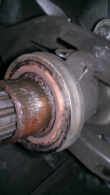

AHHHHHHHHHH, is that a nylon bushing in that last pic ?
- 08TwinStickPW
- Posts: 274
- Location: Ulster County, NY
Re: WTF happened to my clutch?
Dealership has my back 100%, they told Ram there are no signs of abuse and that they feels it's may have been bad from day 1 and that there was no way I could have prevented this (confirmed by Ram saying the same thing back to me). The person handling my case ar Ram called but I missed it due to work, hope to hear from them tomorrow.TwinStick wrote:X 2.BigMike wrote:I hope the do, for your sake. Though more than likely they'll state it's been abused or neglected, etc...
The last pic is the throw out if you can believe it lol, just covered in lots of material/rust lol.
