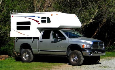

vector1 wrote: And my last question is how a 1200lb slide-in camper will behave over the new rear coil suspension? Many thanks.
Welcome vector1, the simple answer is 1200lb in a 3/4 ton truck should not be a problem, leafs or coils. But " behave " is so subjective, there are no simple answers.
So far I've owned a 1992 FORD Ranger STX supercab 4x4 with a FOURWHEEL pop-up camper ( no pics ), 1996 Dodge Dakota 4x4 with a Northern Lite hard side camper and now my 2005 PW/ Sun-Lite hard side. Reading your posts on what you want to do is very similar to what I do, except my PW is also my daily driver without the camper. I travel alone and at times push myself further than I should, over the next hill just to see what's over there and the PW hedges my bet for success on getting back to pavement.
IMO when building a dedicated truck/camper you can make many suspension modifications to handle your wants or needs.
