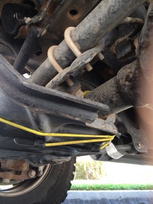

Bungee cords. Sheared off a couple bolts on the skid. Strapped it up for the ride home.

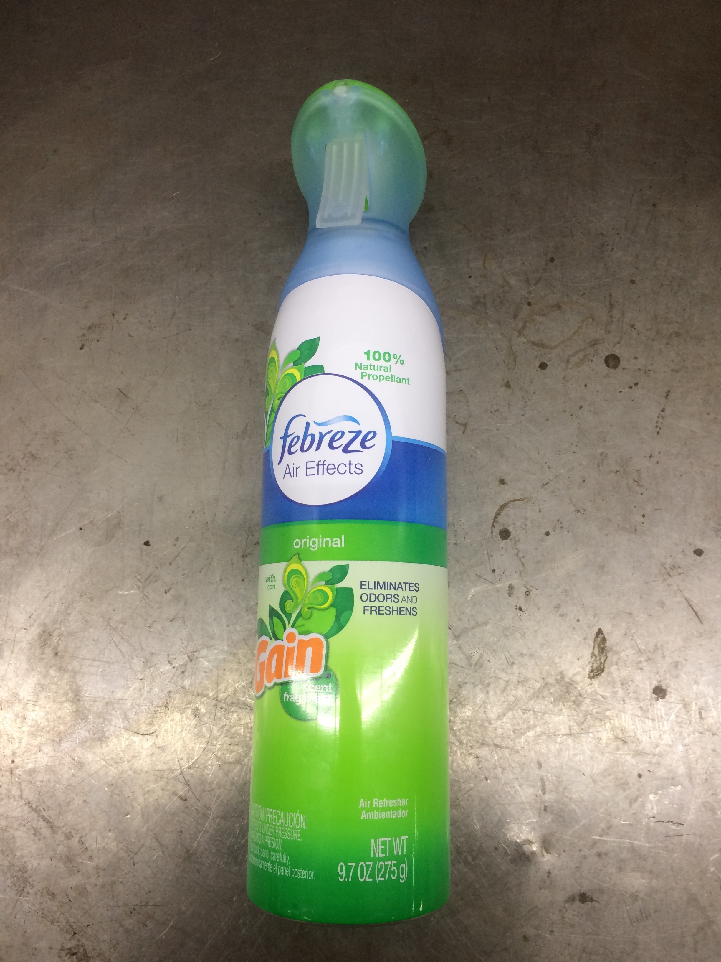

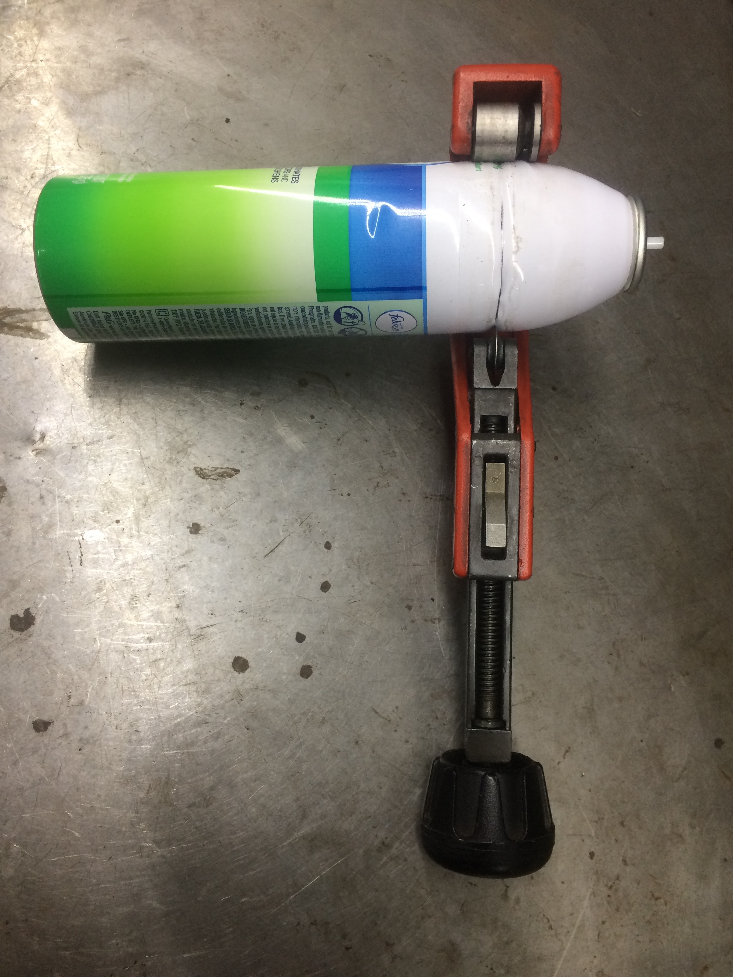

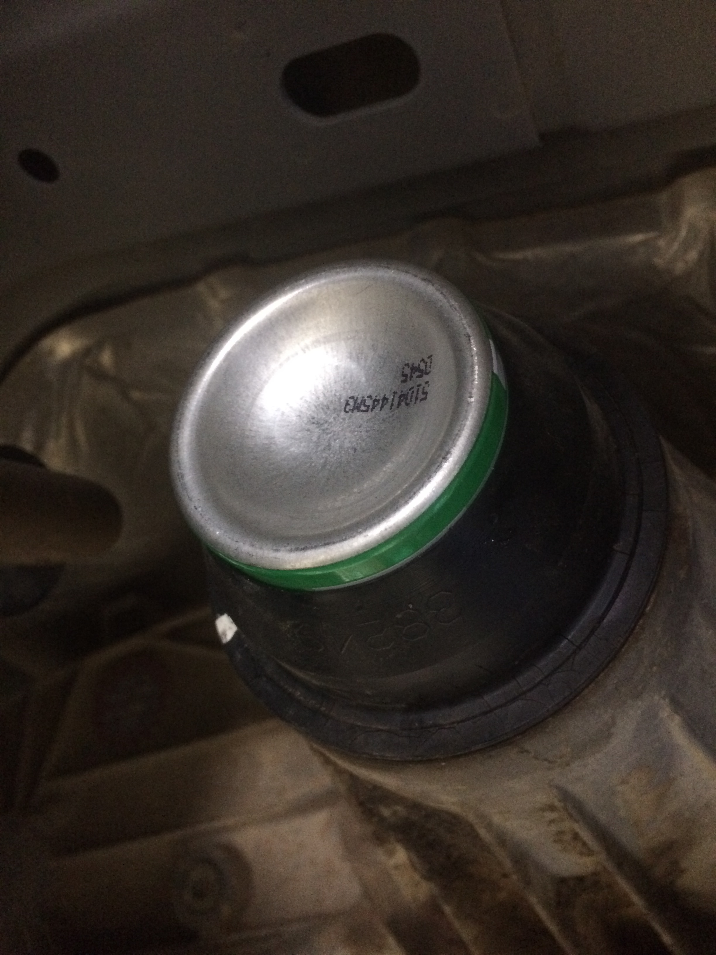

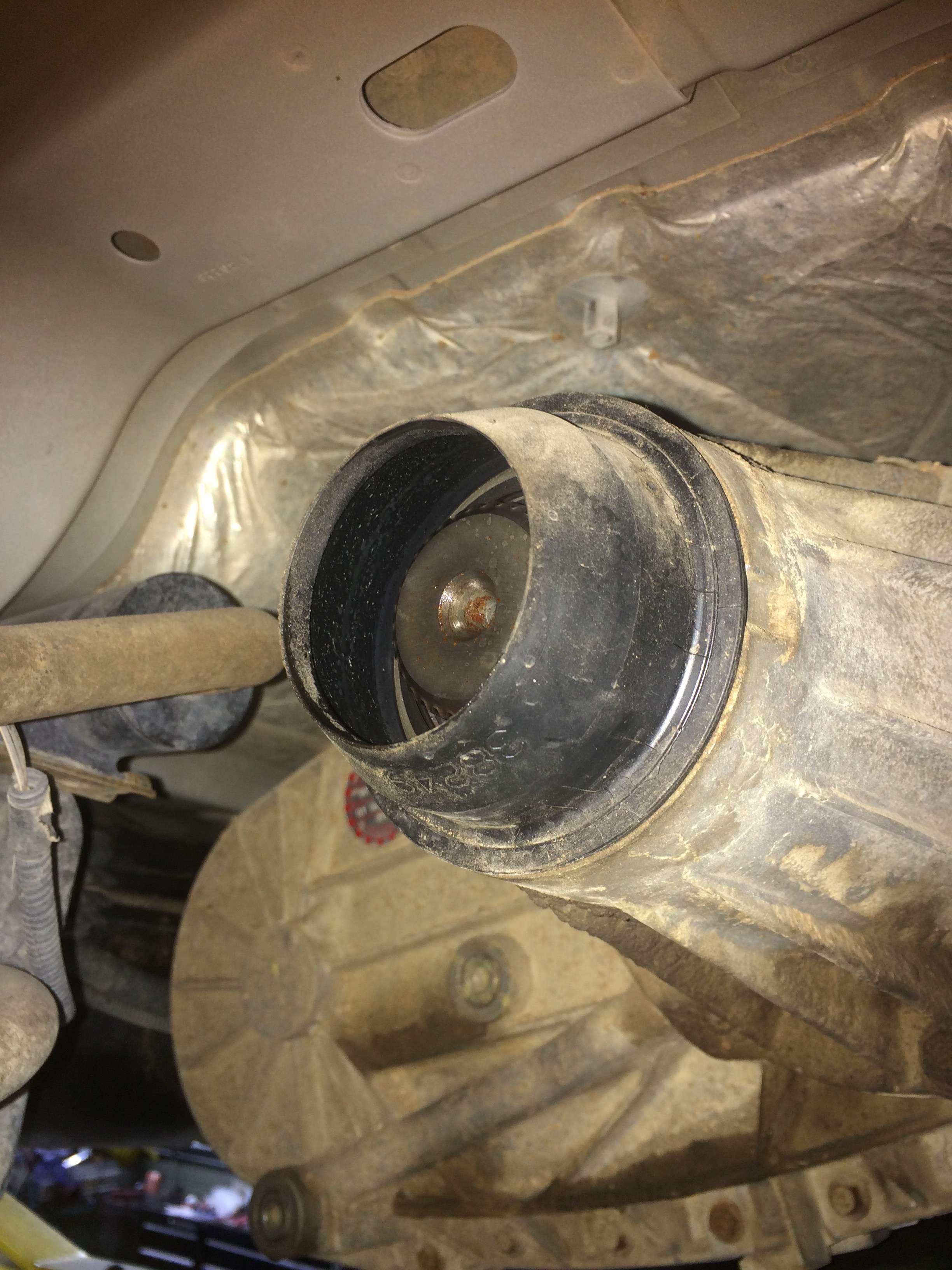

The Poor Man's Slip Yoke Eliminator in a Can.
Reading this old thread got me thinking and this is what I came up with.Pit Slave wrote:With the slip yoke, all you would need is gear oil and a cap plug to seal the end. I'm a little surprised that this method is not talked about.
The slip yoke on my NP271 measures 2.300". So I started measuring different things around my house and shop.
Now I'm a little better prepared if my driveshaft decides to pretzel on me so I can get back home.
And as an added bonus my tool box smells clean and fresh!
