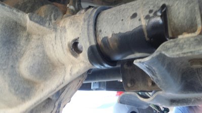

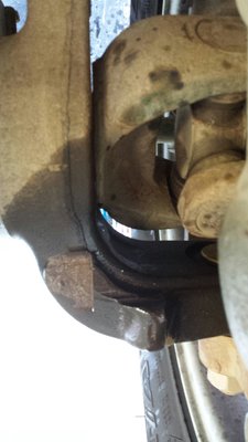

This morning I noticed few drops of oil on my driveway under my truck. When I got home this evening I crawled under and found two leaks. Both are on the passenger side of the front axle. The one causing the drips is the end of the passenger side axle. Oil has leaked down over the lower ball joint and down on to the tire. The other leak is where the passenger axle tube meets the diff housing. Its a little seepage nothing actually dripping at this time. I went on a light trail ride a week and a half ago and knocked the front diff. Would it be possible that the hit to the diff would cause failure of the seal at the end or this just happened on its own? Anyone had this happen on their truck? Calling the dealer in the morning to bring it in, hopefully the extra money I spent on the warranty pays off.

Well just heard from the dealer. Apparently the weld between the diff housing and the axle tube broke and the passenger side tube actually rotated slightly. So now they are ordering an entire new front axle assembly. Cant wait to hear the time estimate to get that delivered and installed.

You can see in the the first pic the plug weld is missing and fell out.

Even hitting the diff shouldn't cause that I don't think. (unless he was going very fast at the time, and I'd say a busted plug weld would be the least of his worries at that point!!!) I hit the diff plenty of time on my ZJ's puny dana 30 and didn't have any issues. It looks to me like a manufacturing defect.bones wrote:I would say that definitely could be related to hitting the diff.

Looks like a bad weld. Never got enough heat to the tube and diff housing to stick.Pit Slave wrote:You can see in the the first pic the plug weld is missing and fell out.

Yeah I agree that the diff hit was not the sole contributor to the break. I was going under 10mph and the rock only hit the lower lip, probably only a quarter to half inch made contact with the diff. Also the wheeling trip was almost two weeks ago and I checked the entire under body when I got home and didn't notice the damage to the weld. But I guess it's a good thing I brought it in and am getting it replaced. Just hope it doesn't take a long time to get the new axle in.

Where the tube goes into the diff housing. Alot of people will weld the tube to the diff housing there, all the way around. Thinking on doing this myself.

You got a bad plug weld that fell out from the lack of penetration. The other plug welds on the axle tubes is now questionable too since the axle tube rotated.I would fight them. Lawyer if needed.
