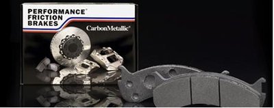

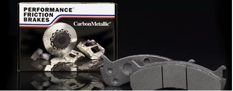

I had the same problem and put on a set of EBC Greenstuff pads on OEM rotors and still squeaked.
Then I put on a set of Performance Friction Z-Rated pads (made from carbon metallic, not semi-metallic, not ceramic) and have gone 60k without so-much-as a single squeak and they stop better than the OEM pads. The best brake pads I have every owned.
I got them from O'Reilly Auto Parts for about $85.99 a set and they came with a life time warranty which means free replacements as long as I own the truck. Can't beat that.
