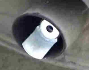

Thanks! Here's a close up, pretty trick custom job...
- Rodeoflyer
- Posts: 515
- Location: Conifer, CO
Re: exhaust
Haha is that the 'oakland style' exhaust whistle? Rofl

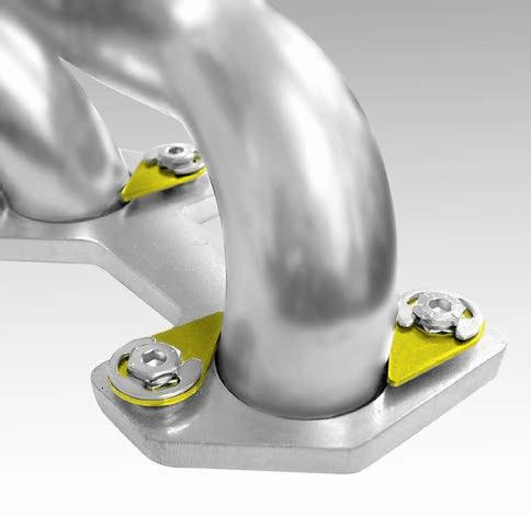

Don't know about the jba's but I've had to do several broken exhaust studs on these trucks, a right angle drill easy outs and kroil will make your life exponentially easier. For putting stock manifolds back on stock hardware is the way to go, mopar has slightly updated it to hold up better. Do not attempt to use srt exhaust hardware for stock manifolds. If you're really ambitious stage8 fasteners makes locking exhaust hardware that is head and shoulders above anything else. Runs about $60. Totally worth it for headers, not sure I'd bother for stockers though.
https://www.amazon.com/Stage-MOPAR-Head ... B000QDX8LE
