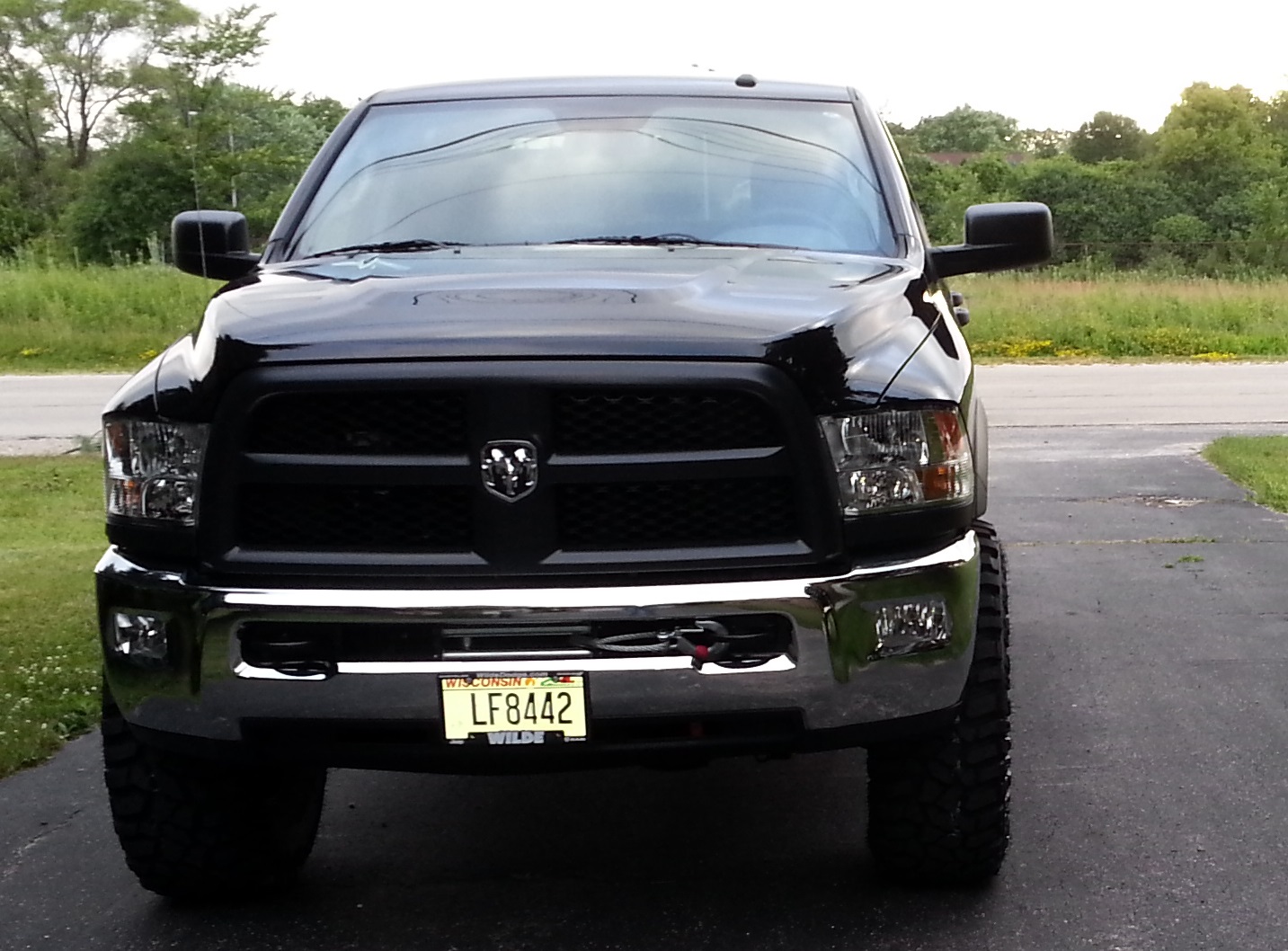

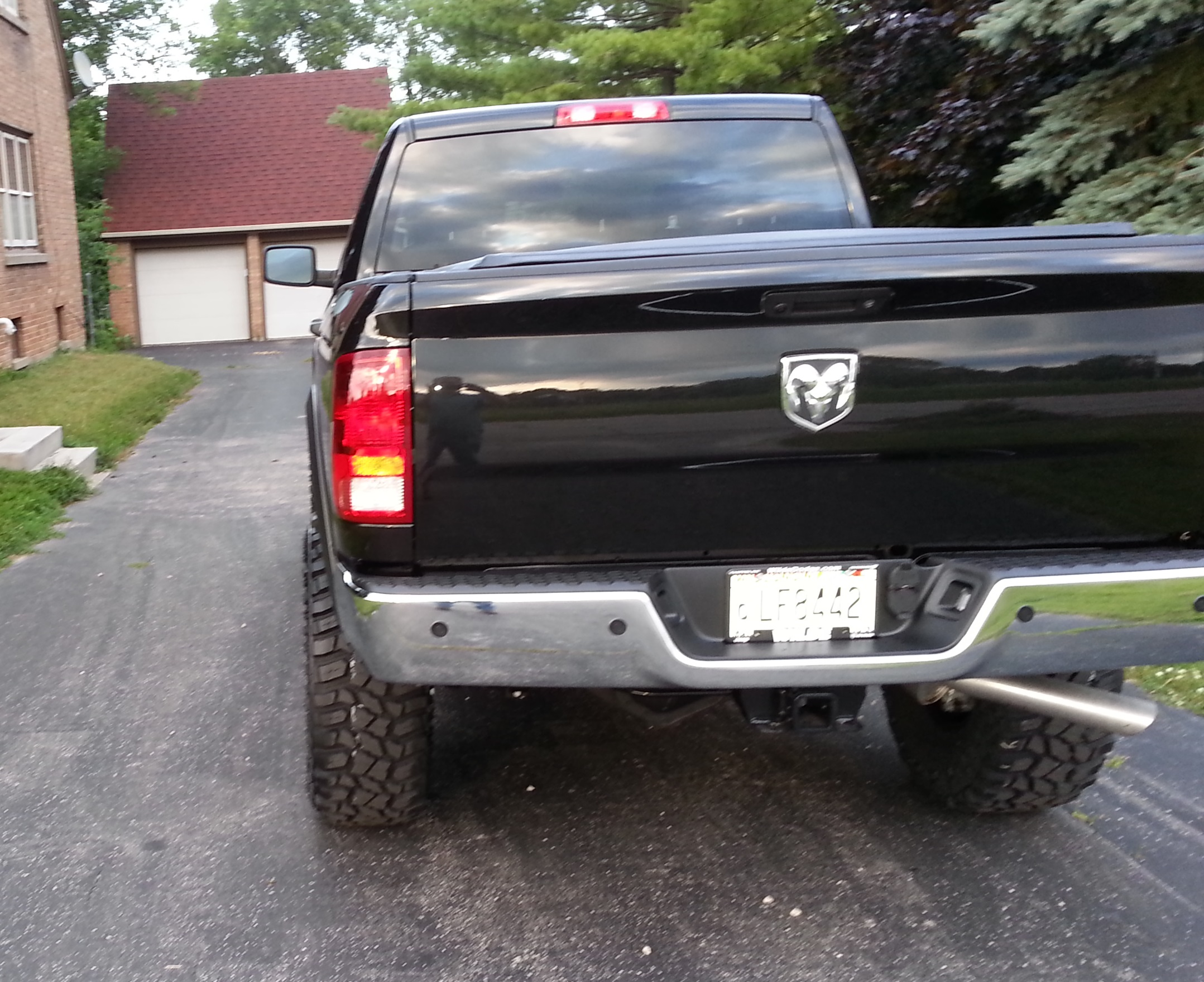

37's are the new 35's
Re: 37s
Finally ! !
Look Awesome man, told ya, the PW is made for 37's....
And I'm not a fan of Toyo's but I do like the looks of those, not too aggressive and looks like they'll be road worthy.
Re: 37s
Looks great! I'm glad to see these tires on a wagon finally. Those will be my next tire purchase as well.

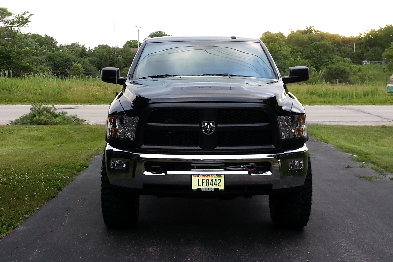

New wheels and tires installed. Tested to 80 MPH for vibration, looks good so far. Reinstalled the factory flares.
Decided to stick with factory flares over the RC flares. The factory flare installation just seems much more durable, even though I wish it had a little more coverage. Note: you will need 5 feet of tape for each front flare.
The tires I selected are fairly wide. Cooper Discoverer STT Pro 37x1350x17LT. I could have gone with the 37x1250x17LT, but those were 8 ply and only .3 inches narrower on overall width, so I opted for the 1350 and maintained the 10 ply.
The wheels are AEV Katla 17x8.5" with 6" backspace. With this combo I only have slight rubbing at full lock. The only modding I did was the pinch weld trim, fender liner reshape with a heat gun, and trimming of the lower back edge of the front fender liners.
The deep backspace helped quite a bit, as you can see in the down facing picture of the rear wheel well shot from above the fender. The fender flare manages to extend over the full tire, although only at the top. It seems the front of the truck is narrower or the fender flares up front have less coverage, as the front tires do protrude a little. I apologize for the oddball picture from the rear. Looks like it was shot in a fun house. I was trying to show the left rear tire from the back in relationship to the side of the truck.
