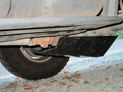

Maybe something like this is closer to the mark?

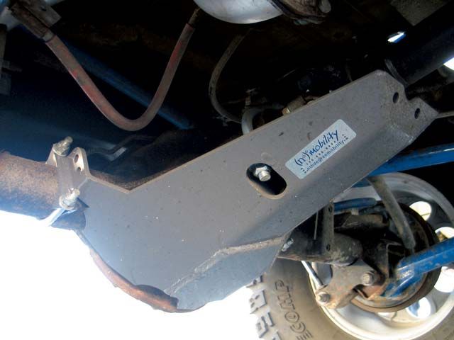

But, I'm sure some folks would keep going until it's more like the second pic! :lol:
Pretty good design!
If you just can't stop until everything is covered!

The first picture is more what I was thinking. However, that second one is definitely more on the mark, especially on some of those Blue trails at Rausch!! And it will protect the trans and transfer case, which is something else our trucks lack.
I wonder what something like that would cost? The only drawback is when you have to work on something underneath. You have to take it off each time. Needs to be adapted if one has rock rails, too.

AceMan wrote:The first picture is more what I was thinking. However, that second one is definitely more on the mark, especially on some of those Blue trails at Rausch!! And it will protect the trans and transfer case, which is something else our trucks lack.
I sent Cam at Iron Pig a copy of the first photo....he said they can definitely do that and he likes that design. I have to measure the diameter of the axle tubes and shoot that to him. I also told him that I would like to see the back part extended a bit and curved up slightly to protect the diff cover. As far as doing something like what is shown in the second photo.....Man! That would be pretty expensive! Plus, if you were to use heavy gauge steel front to rear, all of that would add a significant amount of weight. I had a similar (not THAT extensive) array of skid plates under my '79 CJ. They were built by Iron Pig, and had little doors and access points to service the drive train. It was nice, but it did add a good bit of weight to my Jeep. Do you happen to already know what the diameter of our axle tubes are?

Post by TwinStick » Thu Jun 21, 2012 1:35 am
I like that design too. I think our axles have 20-25lbs more steel in the pumkin area, than a reg 2500. But anyways, that first pic is what i invisioned, it would help to get over the rocks by being smooth/er & also protect the vulnerable pinion/u-joint/d-shaft area. :rockon: I'm all for pic #1. :cheers: If they could just extend it an inch more towards the rear, to cover the vulnerable diff cover lip, that would be GREAT !!!

Post by Ken G. » Thu Jun 21, 2012 9:56 am
TwinStick wrote:I like that design too. I think our axles have 20-25lbs more steel in the pumkin area, than a reg 2500. But anyways, that first pic is what i invisioned, it would help to get over the rocks by being smooth/er & also protect the vulnerable pinion/u-joint/d-shaft area. :rockon: I'm all for pic #1. :cheers: If they could just extend it an inch more towards the rear, to cover the vulnerable diff cover lip, that would be GREAT !!!
Yep...that's exactly what I relayed to Cam down at Iron Pig. It'll be extended a bit and slightly curved up to protect the diff cover. I also like the idea of using the big u-clamps, instead of using the diff cover bolts...that way the gasket and seal won't be in danger of being compromised. It'll also allow for easier servicing of the diff. :)

Post by FirerescuePW » Thu Jun 21, 2012 10:20 am
I like it. The u-bolt idea is what I had in mind. I didn't want to use the cover bolts. If you drop hard onto the guard, you risk loosening cover bolts. If a u-bolt loosens it won't cause a leak. I think I may be in, too, depending on the time frame.
