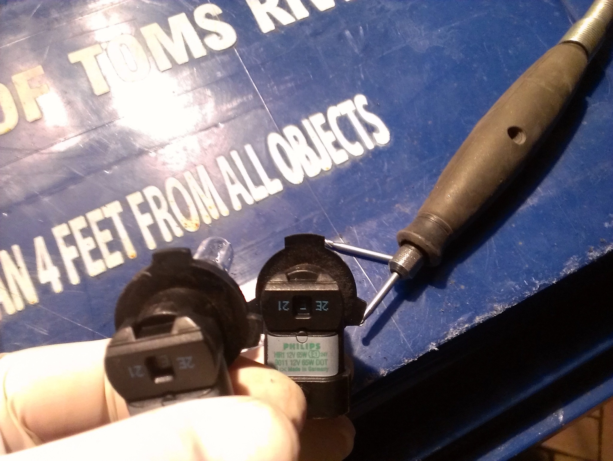

Well I installed the 9011 bulbs...improvement yes...install ...simple and quick...I used a dremal to trim it...here's some pic..thanks for the tip neotech

WOW W2dodge. Man that is an awesome pic comparison. I dont think even hids could match that in stock housings. plug and play. Glad you were able to find the bulbs. Welcome for the info.
