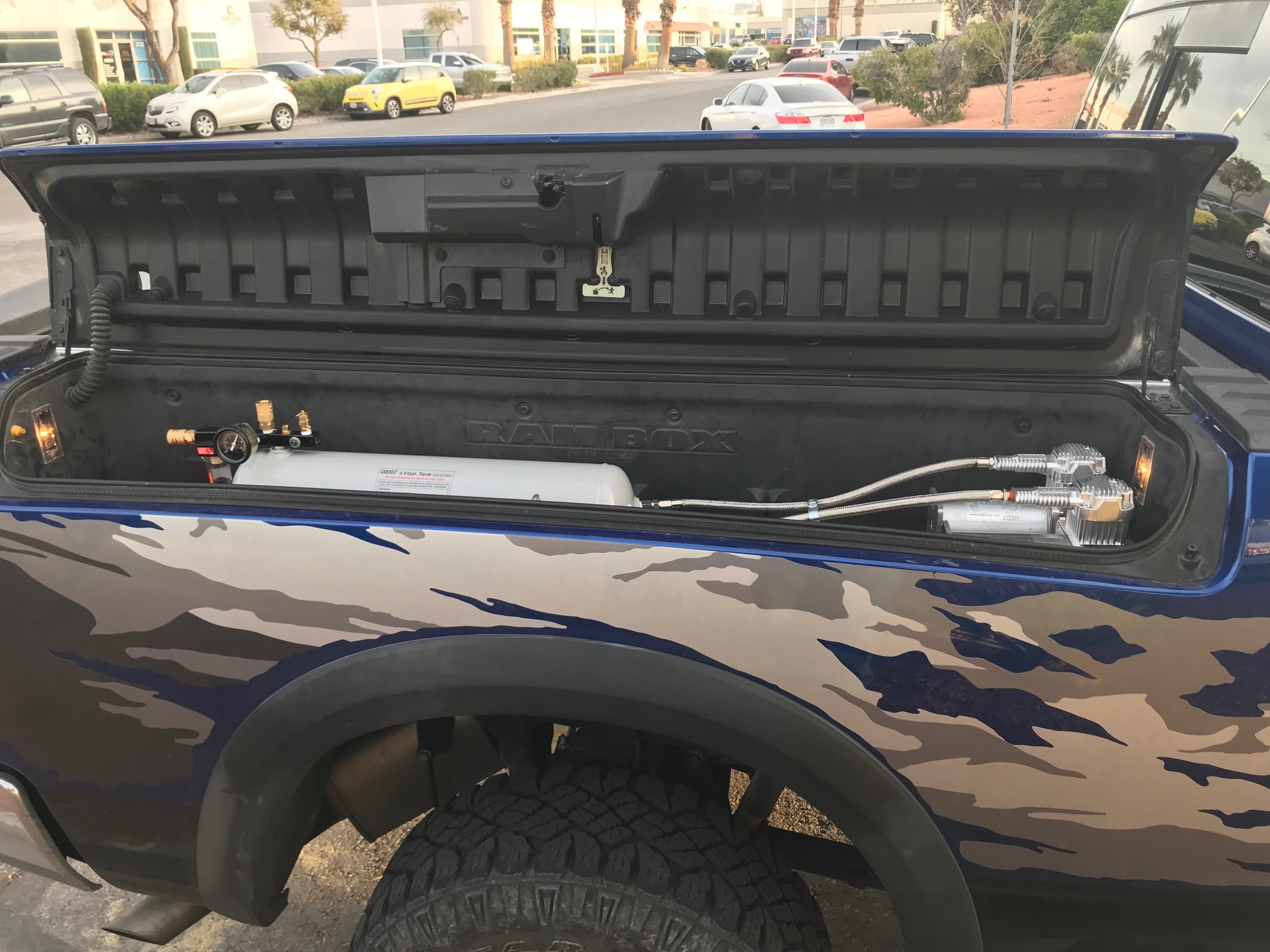

I used to have a Viair 400c mounted in a .50 Cal ammo can. It also contained a 25'air hose, 15' power cable with 50AMP quick disconnects. This made it nice and portable and fit the RAMBBOX nicely. For Christmas, my wife got me the Viair Heavy Duty OBA Kit (400C, 2.5 gal tank), so I decided to rebuild my old compressor and mount both compressors and air tank in the passenger RAMBOX. While I was at it, I plumbed in my airbags and added an in cab control paddle switch and gauge for the airbags. The two compressors are fast and I like it so far.

Post by PWJouster » Tue Mar 13, 2018 1:50 pm

TJ02Gopher wrote:
Fri Jan 19, 2018 11:08 am
i pretty much want to mimic this setup..
any info you could pass along as to the best way to mount the hardware within the rambox? im not sure what lays beneath the box, and what the best supporting member is.
i want a setup just like yours, dual compressor and tank, tank to OBA fill and deflate system.
air chucks at all four corners mounted near or on frame, utilizing whips to connect each tire individually to the system. front and rear tires separated on different Ys to a multi way valve. you can fill all four at once, and front or rear separately for bias PSI.

I've been using two Viair units for awhile attached to a wooden base that I cut to perfectly fit into the pocket in the back of my rambox.
I air up both sides at once usually.
Just used a simple Anderson style connector to the battery so it's always ready to go.
