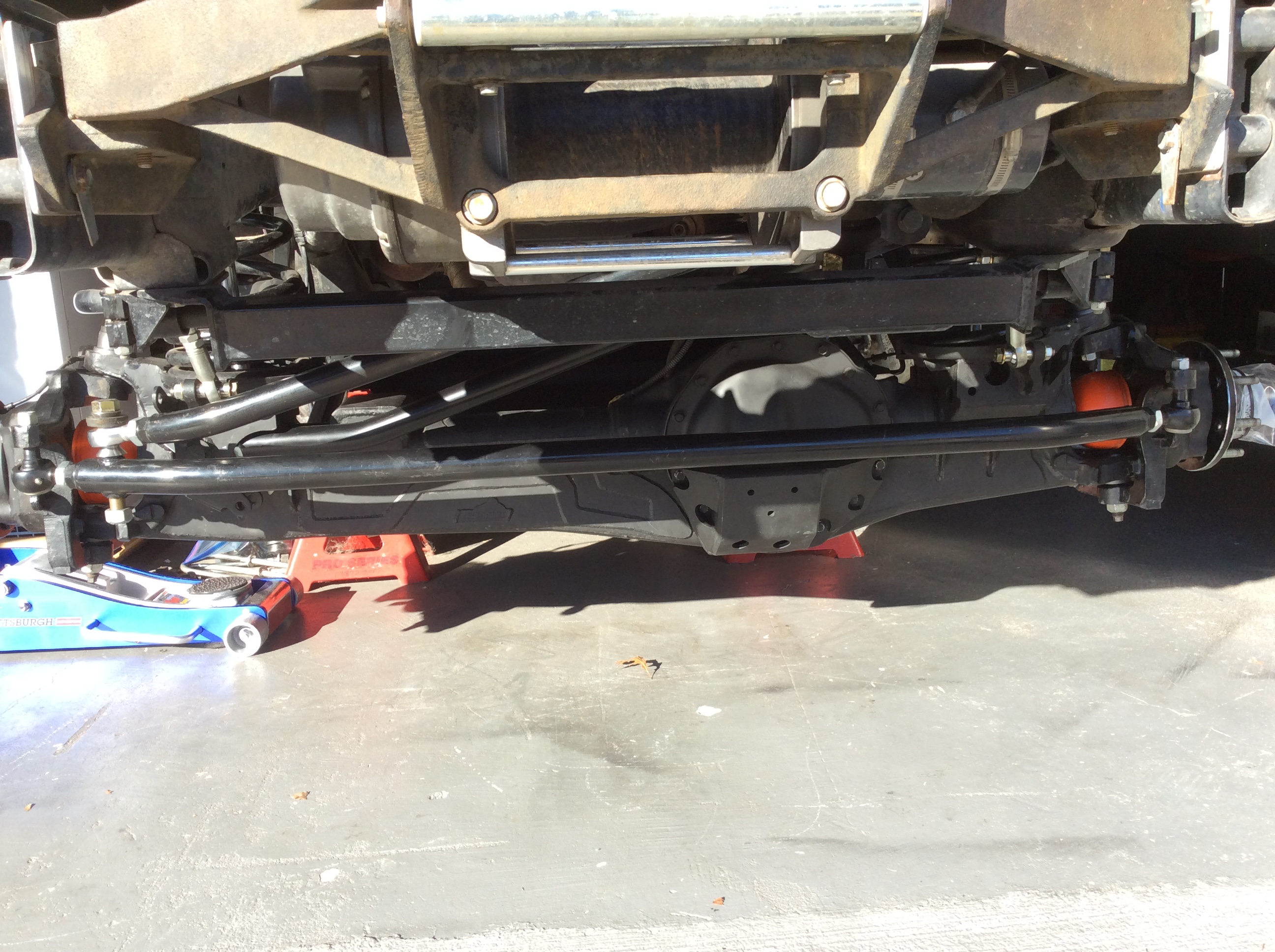

Not sure of any way to accurately measure the c's while the axle is still under the truck. Call the nearest dealership parts department with your vin number and get accurate part numbers for bare housing and complete axle then order for way less online. If you do a Thuren or Carli truss you can weld both on a complete assembly even with the axle in the truck. If you want one like mine it needs to be a bare housing and drop shipped to creative fab in California. Haha I know how it goes, breaking=upgrade time! Shit, mopar discontinued the housing for my 09, it took me months to find an axle. Good luck with whatever you decide to do man!
Thuren truss fully boxed and plated with 3/8" knuckle gussets courtesy of creative fab

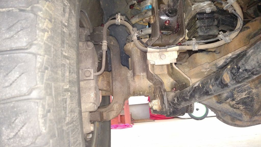

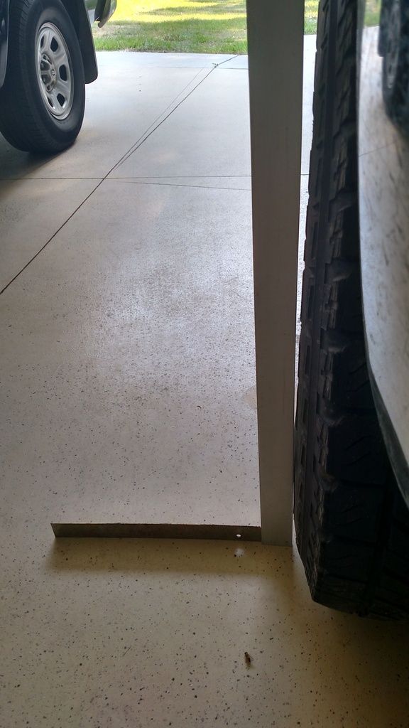

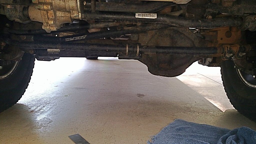

I dont think it's all that bad, not sure why I had scrubbing going on but will find out next week when I get another ride and start stripping it down. I took some pictures yesterday. It's hard trying to get a photo to show it bent, it's obvious when you see it in person though. I'm really thinking they can straighten it and truss it and it will be fine.
Not the best method but I took at square against the bottom of the tire, (in front of the bulge about where the wall straightens) to get a better picture of the camber.
The best I can tell from the concrete, where the passenger long tube meets the housing is 3/8" lower than the tubes on either side.
And a snap of each C in case one of you can tell if they look OK or if they are bent. I was thinking if I could check the distance between the upper C and the coil bucket if I knew what it's supposed to be.

It's a considerable deviation from plumb on the wheels. You'd figure similar drop at the pumpkin. New center sections on 2010 are beefier. Maybe just maybe you bent passenger side axle tube. Get a filler gauge. And see if there is any gap where tube enters housing. Like so: (that is actually first f two front axles I bought. It was bent too, although spun freely).
On good axle it should be tight. Tubes are pressed-in. Any elongation obviously means housing been stretched. Only good for recycle. Why wouldn't you consider used axle. You can put a truss on it before mounting on truck. At $1500 any significant repair on your axle might easily blow past that.
