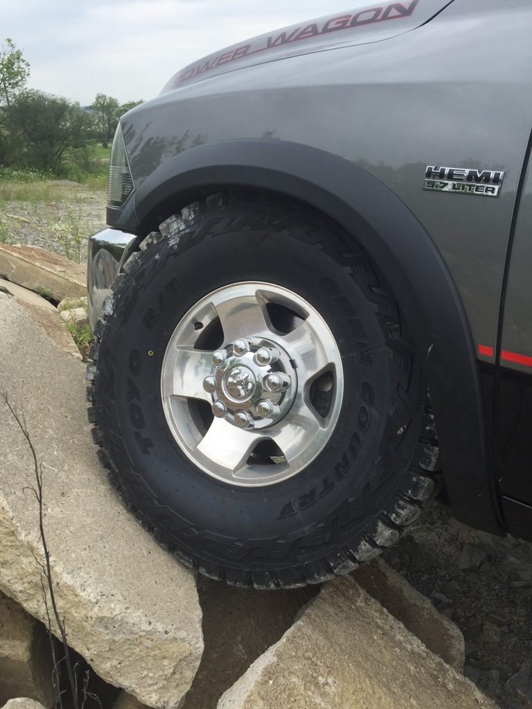

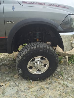

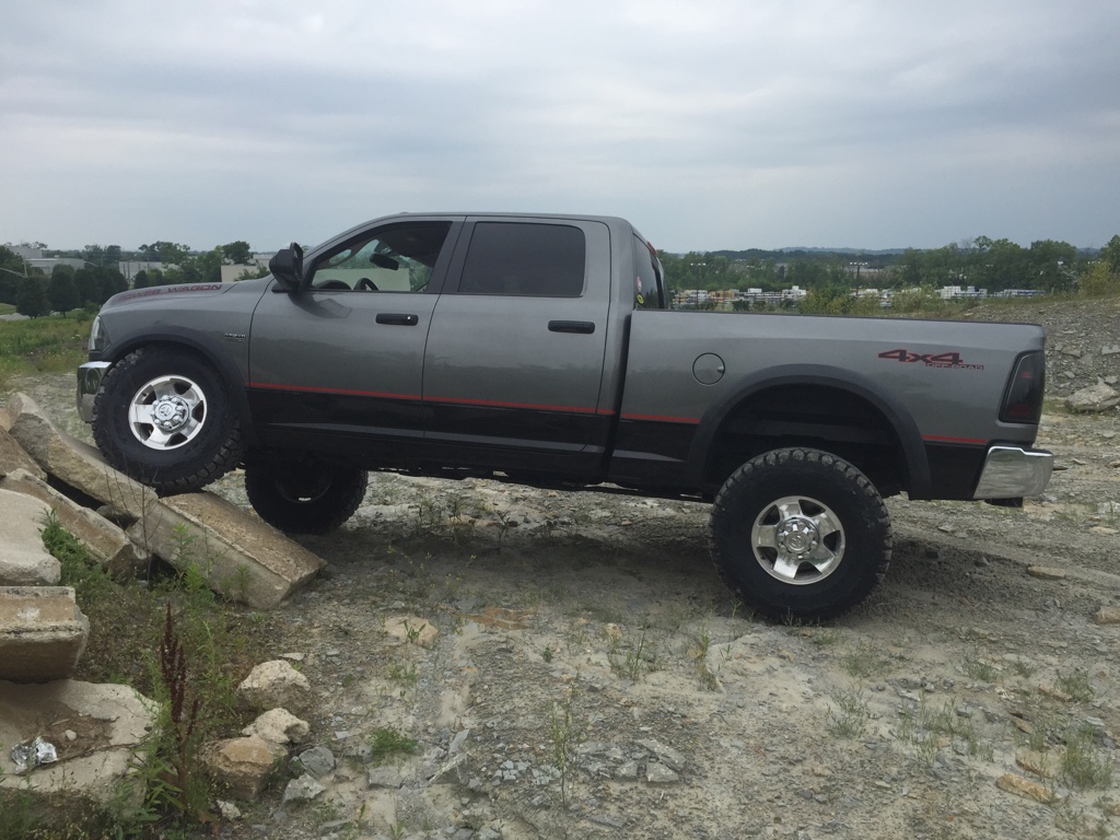

Post by stubiePW » Fri Jul 03, 2015 2:17 pm
So here they are guys. I think the really make the truck look good. I have some rubbing on the upper contol arm on both sides at full lock and some of the driver rear fender line (cut). I am also rubbing a little on the sway bar on both sides at full lock. It flexes great no rubbing from what I've seen
The tires are quiet and behave well for only driving 18 miles

Re: 37s
Post by stubiePW » Fri Jul 03, 2015 2:18 pm
Also the second to last pic is full articulation

Post by w2dodge » Fri Jul 03, 2015 2:35 pm
Nice...those tires don't look too wide..I like that
...give us update on how they perform...

Post by nts007 » Fri Jul 03, 2015 6:29 pm
Beautiful!! Sticking with stock rims they fit perfectly. They don't look stupid sticking out and you can use them!! You get used to the rubbing. It only takes one look over and down at the 6" lifted Chevy on 33's beside you to make you forget the rubbing...

Post by stubiePW » Fri Jul 03, 2015 7:13 pm
Yea. I have to get used to not turning full lock, but that's easy. I have to pull back the liner a bit on the front driver side but so fat I love these tires. I also updated my intune for 37s.

Re: 37s
Post by Bluchalk » Sat Jul 04, 2015 9:58 pm
Nice lookin truck... :rockon:
I'm partial to the color. :cheers:
With Thuren diesel coils and his track bar you will only rub on right side sway bar at full lock.

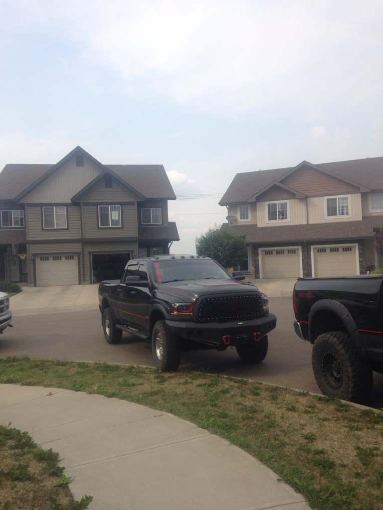

Post by 2wagons1driveway » Sun Jul 05, 2015 12:15 pm
Of just ditch the bar and get a Thuren fab swaybar. Image move your module to around the airbox. So your lockers still work this brings the module up and out if harms way so no more water ingress issues.... Looks awsome man ImageImageImagewe just finished kens truck with 3" overland set up. Pretty swayey with no swaybar and the moderately valved overland shocks but rides awsome on the highway. Used his level shackles to give it a good stance

Re: 37s
Post by Jack187 » Sun Jul 05, 2015 2:33 pm
stubiePW wrote:My tires? None. I'm running stock
Did the tire dealer give you any flack about putting those 37" tires on 8" wheels?
I've been wanting to run certain 35" inch tires on my factory rims but they always start at 8.5" minimum rim width.
stubiePW
Posts: 581
Re: 37s
Post by stubiePW » Sun Jul 05, 2015 4:08 pm
No flack at all. They put them on without question.
