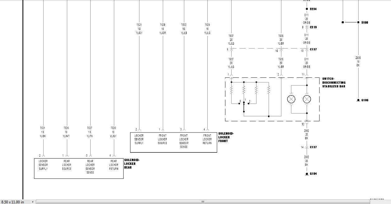

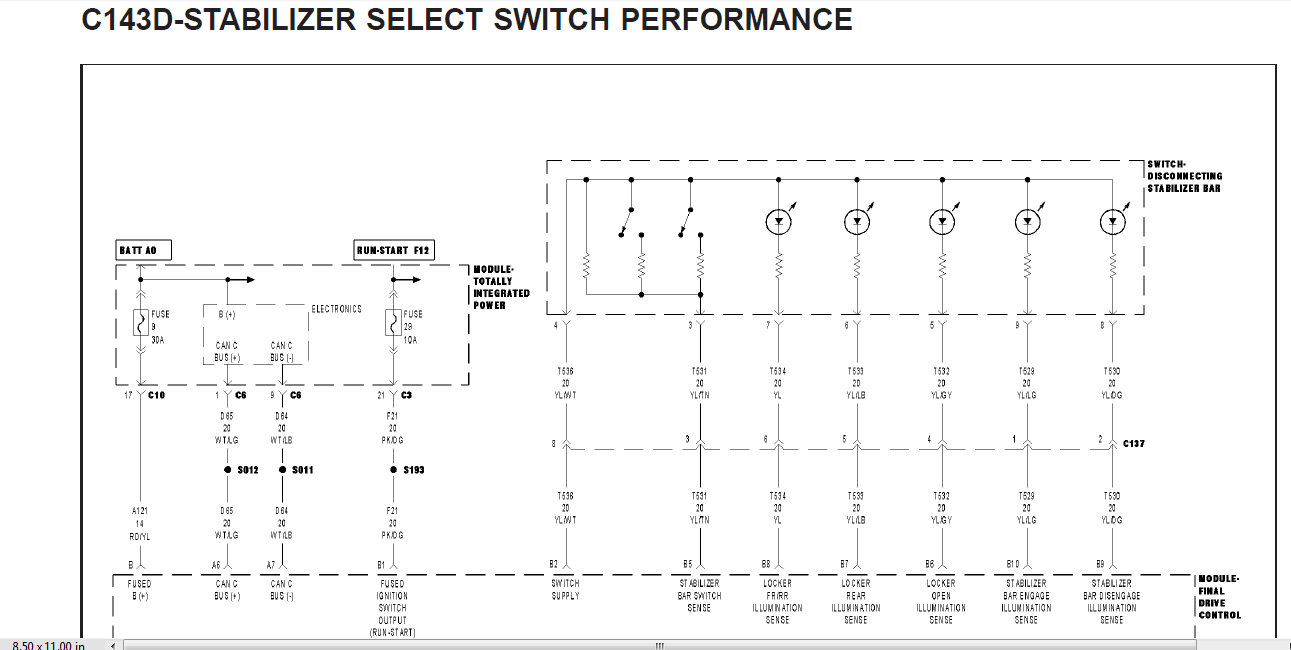

Has anybody come across the factory service manual for the 4th gen 2500s yet? I have it for the 1500. Or maybe the 08 / 09? I can probably figure out the factory switch by looking at the wiring diagrams.
Re: These Damn Lockers Are Going To Lead Me to Drink!
From the 2002-2008 FSM, had to do 3 screen captures to get the whole thing...Dawizman wrote:Has anybody come across the factory service manual for the 4th gen 2500s yet? I have it for the 1500. Or maybe the 08 / 09? I can probably figure out the factory switch by looking at the wiring diagrams.

Thanks for posting that. I have a feeling that the factory switch won't be too easy to make work with hard wired lockers. When I get my truck back from the dealer, I will test it out & see what I can figure out. I'm thinking it might involve a custom circuit board to make things work. It's doable, but might be more hassle than it's worth. Also, the 4th gen trucks might be different than that diagram, making it more complicated. I'll do my best, but no guarantees.

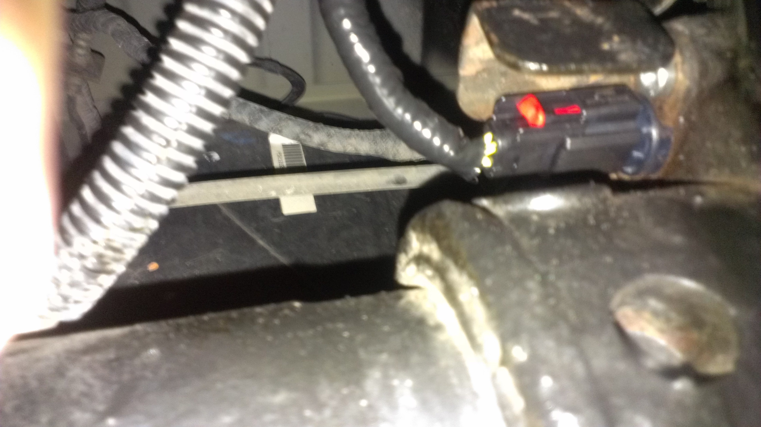

We got our first taste of the white stuff on Saturday night. Was headed home as I was very disappointed because the snow was not sticking and no one needed help
Coming up on the turn that goes into my neighborhood and what do you know, a car is in the ditch
I whip around and hook up to pull them out. I throw "OX" in 4 low and hit the rear locker and what do you know
SERVE 4X4 light comes on
Went outside today drove her in the grass and tried it again, same issue. Sway bar works fine, as soon as I switch to the rear locker the serve 4x4 light comes on
anyone have this issue?
I took the connectors off and cleaned them out, also added dialectric greese with no change

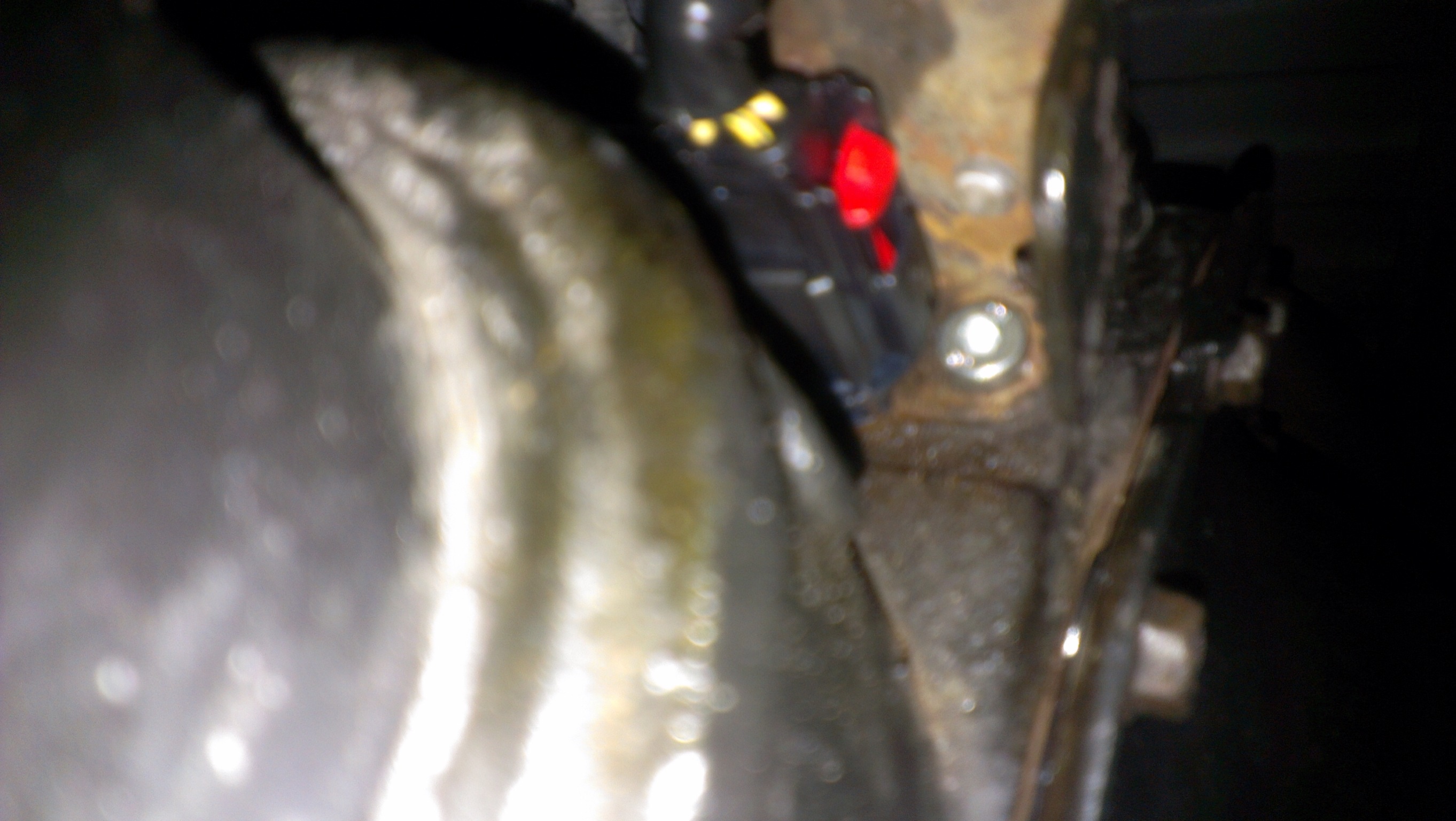

Danny, we have the same year trucks......my locker wires were broke about an inch from where the locker plugs into the rear differential. It was so small i could barely see it. Check yours. The break was similar to how our rear door speaker wires break going from the b pillar to the rear door.

My '05 wires broke in the same place...VA_Wagon Man wrote:Danny, we have the same year trucks......my locker wires were broke about an inch from where the locker plugs into the rear differential. It was so small i could barely see it. Check yours. The break was similar to how our rear door speaker wires break going from the b pillar to the rear door.
Thanks for the help, I remember when I brought "OX" that I had to work on the rear locker. Thanks for reminding me. The culprit was right in front of my eyes all this time.

I bought an extra pigtail assembly from dodge for like $25 and keep it in the truck as a spare.
