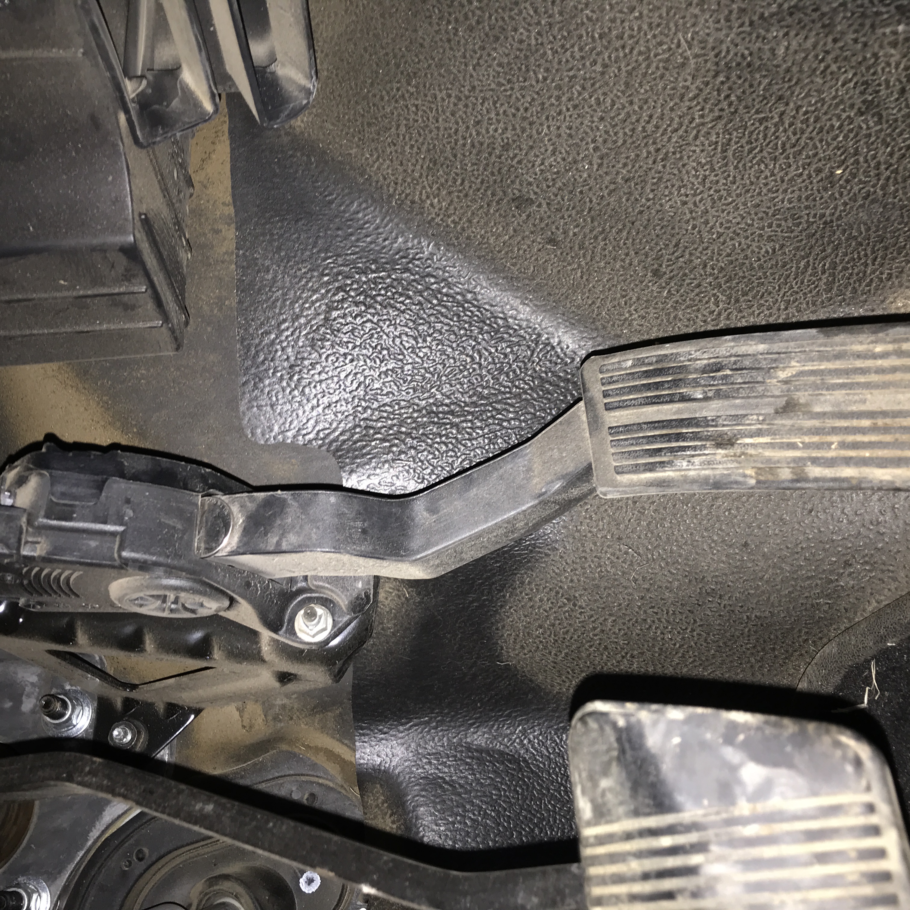

So there was a dead battery on the first responder rig at our volunteer fire department, it's a diesel so it actually had two dead batteries. We had a 120V battery charger on one battery and I had my jumper cables connected to the other battery and I was thinking, "Boy I sure wish I had some kind of idle up feature on my truck, so I didn't have to sit here with my foot on the throttle!"
Well I started looking under the dash to see if I could rig up some kind of old school cable control or something, and then it dawned on me that the answer to my problem was sitting in my cupholder.
In very short order we had the fire truck started and running on its own power. One tap on the throttle and the coin dropped to the floor. Anyhow, that was my solution in a pinch and I liked the results, so I think I'll try to store this in my longterm memory banks. Your milage may vary, use at your own risk.

Retired BLM Rig wrote: ↑Sun Dec 29, 2024 2:04 amReviving an old thread, rather than starting a new one.
Necessity is the mother of invention.

I will be trying this during my next winching.

Thanks for sharing, this is brilliant.
