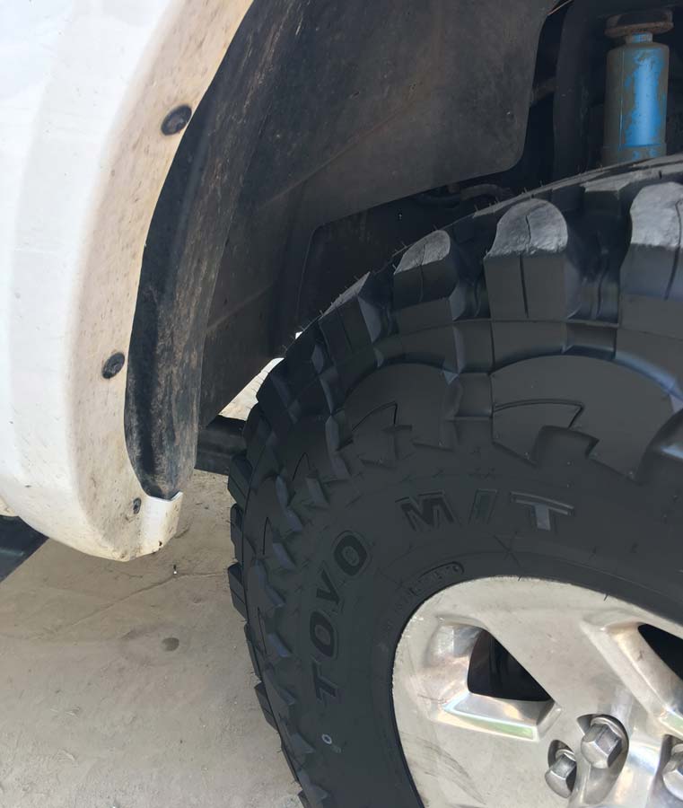

I have no rubbing on fenders lock to lock, haven't done a full stuff test yet. I was going to do that later. I have factory wheels and high clearance bumper so my fenders up front were already cut. I think at full lock the front might rub the sway bar a tad. Have to do some more testing.NickTF wrote:You will probably have less rubbing then I do on the outside rear of the fender; however, I don't think you'll be able to turn lock to lock.

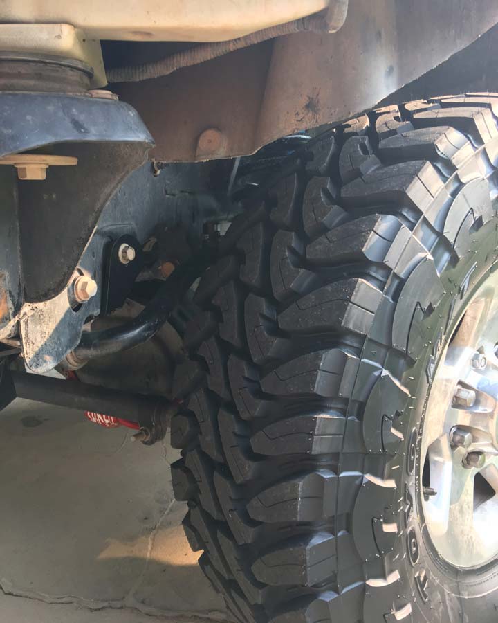

How bad is the rubbing on the bolt at the bottom of the radius arm?

Miles away from ever touching that thing. I wonder if that bolt is backwards on some year trucks, because you'd be rubbing springs before that bolt was ever an issue on my truck.zigsrig wrote:How bad is the rubbing on the bolt at the bottom of the radius arm?

You're going to rub the bottom of the fender flair and the inner fender tunnel over the pinch weld. There is more clearance turned full lock then there is turning partial lock. RA trucks have more clearance at the RA than older trucks with 5 link, the rubbing is at the inner fender, flair, pinch weld, and sway bar (stock wheels only). A Thuren swaybar will give you more clearance at the swaybar.MikeKey wrote:I have no rubbing on fenders lock to lock, haven't done a full stuff test yet. I was going to do that later. I have factory wheels and high clearance bumper so my fenders up front were already cut. I think at full lock the front might rub the sway bar a tad. Have to do some more testing.NickTF wrote:You will probably have less rubbing then I do on the outside rear of the fender; however, I don't think you'll be able to turn lock to lock.

mikekey have you had a chance to stuff those monsters and see about the clearance yet?
