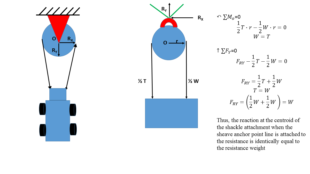

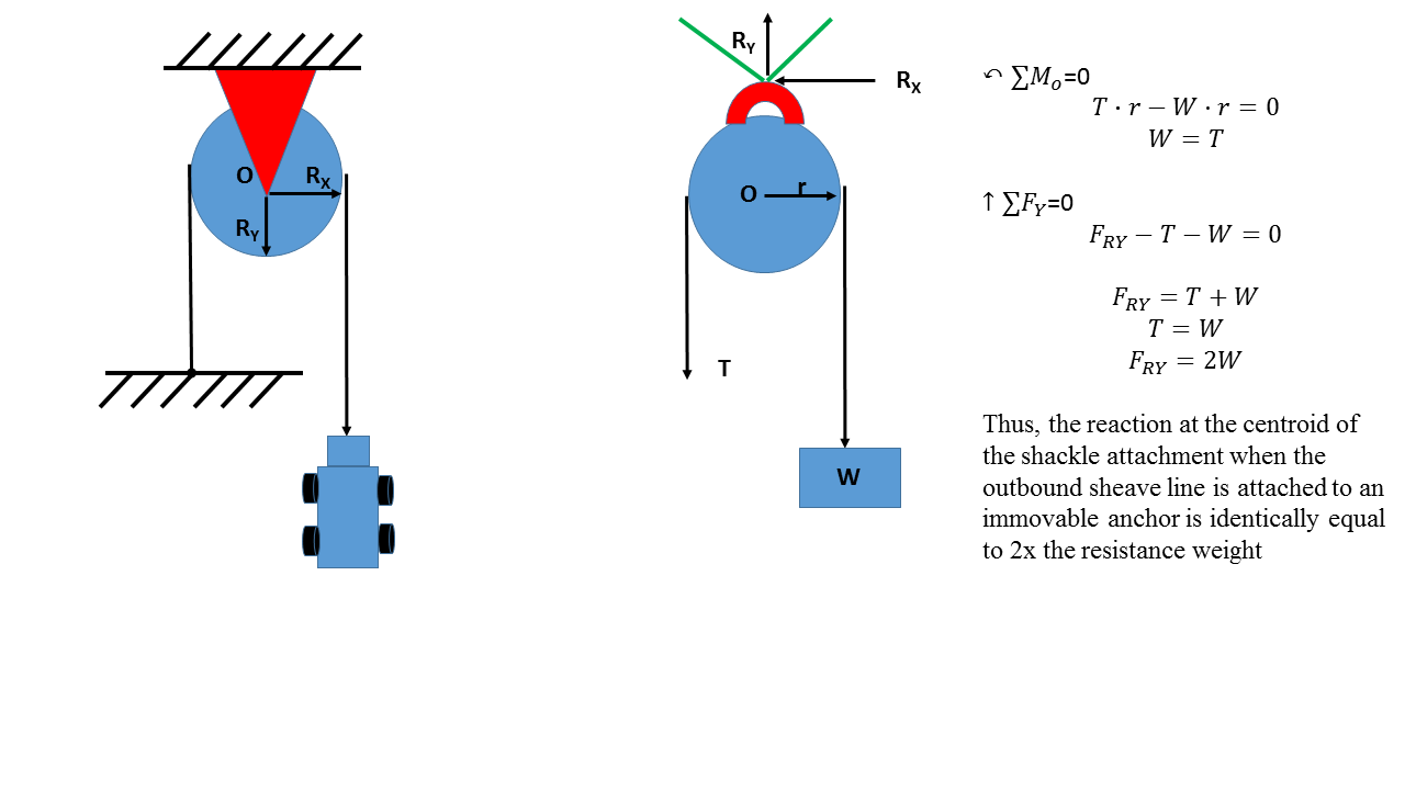

The literature, some even published in the WINCH 101 section on this site, the Army manual for heavy vehicle recovery (AFMAN), and the Air Force manual for ground aircraft static maneuver, plus any undergraduate vector mechanics texts say otherwise. When the line is attached to the vehicle, the outbound line and the inbound line share 1/2 the total load, thus you're winch is doing 1/2 the work, and you get a 2:1 advantage--called a travelling block or movable pulley. When the load is attached to a fixed point, you're getting 1 lb of pull for every 1 lb of resistance, and the sheave anchor is experiencing 2x the input load. I've attached two Free Body Diagrams to illustrate. But essentially you're correct in the Sheave has to be rated minimally for 2x the max expected load and the shackle attached to the winch has to be minimally rated to 1x max expected load. Max expected load is a function of the vehicle weight, surface coefficient, and ground pitch/gradient.DamageWagon wrote:
Negative, good buddy. This is a pure 2:1 system. Doesn't matter where the end of the line is attached, whether to the vehicle or a ground anchor. If the PULLEY moves, it is a 2:1 system, say 30klbs from our trucks. The lines would carry 15klbs each. Another way to view this is to count the feet needed from your line to move the load one foot. To move the snatch block one foot, you must pull one foot from the winch-side of your line and one foot from the anchor-side of your line. Hence why doubling the pull of the system also halves the speed. We used to do this all the time with rope rescue. All of the anchor-side attachments all go to one "bear paw". We were still capable of 10:1 compound systems.
This is from the DODGE POWERWAGON WINCH MANUAL:
In the illustration above, IF the bitter end of the line is *not hooked to the winched vehicle*, but is hooked to a tree or rock next to it, for each pound of winch force applied, the block will be under *twice* the load, while the line strain will be equal to the line pull. So if you apply a full 12,000 pounds of pull, you are putting 24,000 pounds of stress on the block/anchor. If, however, the bitter end *is* attached to the winched vehicle, the block becomes a "traveling block", even though it is attached to a solid object, because the vehicle itself is actually doing the "traveling", and the load on the *line* is halved, since you are using two lines to "support" the load. In this case, the mechanical advantage is 2/1, so you get 2 pounds pull for each pound of winch effort. Now, since you have two lines splitting the load, let's say it's 10,000 lbs. (you're *really* stuck), the line load is halved to 5000 lbs per line, but the *block* load is still 10,000 lbs because of the parallel line angle factor of 2. As you can see, while the load on the winch is cut in half, as is the line speed for winding, the load on the block is *not*, and is equal to the total line load.
This is why using a properly rated and carefully maintained block is of the utmost importance when winching. In most winching situations, "double-lining" is the best method to reduce stress and strain on the lines and winch motor, at the expense of speed, but may be the *worst* thing you can do from the safety or block standpoint, if your block is not adequately rated or is in poor condition or if you don't know the strength of the anchor or the stall-pull of your winch. The block is being subjected to twice the force of any of the other components, and consequently the winch operator may never know he is exceeding the capacity of the block until it parts and takes his head off. This is especially true when using very powerful winches.
Imagine the stress on a block (and it's anchor as well) when the SUV owner with the Warn 12,000 lb winch double lines to pull his vehicle over an obstacle and sticks a wheel behind a rock, locking the vehicle in place. The winch is already rated for 6 tons single line pull, and adding a traveling block doubles the pulling force to 12 tons. If your snatch block is (as many are) underrated for the winch/line combination, and you have a 6 ton rated snatch block, or even a "really big 8 ton-rated" block, which is commonly sold with RV winches, you still have the potential of block failure because you are using a 6 - 8 ton block with a system capable of exerting 12 tons of force under circumstances where you might not recognize the actual pulling force you are exerting, because you are not really stressing out the winch.
http://dodgepowerwagon.com/glovebox/sna ... basics.php

adeluca thanks for putting those up. I was picturing things wrong in my head with reference to the first model. I'm used to systems where the pulley moves and the vehicle would be static. Opposite of what is happening in our case
 you are dead on.
On the second model, the important takeaway is that, if you have a movable load such as an 8,000lb truck, and the truck does move and we don't consider any other multipliers - just say we are moving 8000lbs - then the pulley carries 8000lbs and the line carries 4000lbs each side. Sweet! We must also consider the inverse and danger involved here. If the load is massive, or does not move, your winch capacity of 15,000lbf max is now felt by both sides of the line, and the pulley feels 30,00lbf. Dangerous. This is not shown by the diagram, but this scenario is exactly how we set up our most basic rope rescue system. Single pulley, 2:1 mechanical advantage. You pull 2 feet of rope and the load moves 1 foot. You apply 100 pounds force to the rope, the load feels 200 pounds force. This is the system where things break.

Hey no problem, I'm glad all that Govn't sponsored education can be used for something productiveDamageWagon wrote:adeluca thanks for putting those up. I was picturing things wrong in my head with reference to the first model. I'm used to systems where the pulley moves and the vehicle would be static. Opposite of what is happening in our caseyou are dead on.
