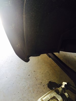

I had a long email exchange with Don Thuren who was extremely helpful even after I disclosed to him from the get go that I was not in the market for suspension parts and understood if he had no time for replying to my questions. In short, 37" tires will fit if you use a heat gun to flatten some of the fender liner, trim a bit of the fender liner, an trim some of the pinch weld near the front of the rocker panel and either: 1) use approximately 1.5" wheel spacers to retain the OEM wheels (was warned extensively to get quality spacers which is a no brainer on a 7200lb truck); or 2) use a wheel with appropriate offset (+18mm offset, the OEM wheel is +57mm offset). I am a big fan of keeping the OEM wheels so when my factory duratracs wear out 37" Toyo RTs are the plan with zero suspension modifications.
14PowerWaggy
Posts: 226
Location: Georgia
Re: 35's fit on stock 2014 and later Power Wagon?
Post by 14PowerWaggy » Thu Feb 18, 2016 1:06 pm
NickTF wrote:I had a long email exchange with Don Thuren who was extremely helpful even after I disclosed to him from the get go that I was not in the market for suspension parts and understood if he had no time for replying to my questions. In short, 37" tires will fit if you use a heat gun to flatten some of the fender liner, trim a bit of the fender liner, an trim some of the pinch weld near the front of the rocker panel and either: 1) use approximately 1.5" wheel spacers to retain the OEM wheels (was warned extensively to get quality spacers which is a no brainer on a 7200lb truck); or 2) use a wheel with appropriate offset (+18mm offset, the OEM wheel is +57mm offset). I am a big fan of keeping the OEM wheels so when my factory duratracs wear out 37" Toyo RTs are the plan with zero suspension modifications.
I spoke with Don quite extensively and this is what he recommended to me as well... I cut about 3" off the bottom of the liner and pulled it back as far as it would go and cut the pinch seam as far back as we could without cutting of the first bolt... I am running 37x12.5 Nitto Trail Grappler MT's on 9" wide Trail Ready Wheels with 5.8" of back spacing... I still get into the fender liner when the wheel is turned and stuffed in the fender... I also rub the heck out of my driver side sway bar at full lock... I haven't found that this rubbing is actually hurting anything but it does make quite a racket when it does...
