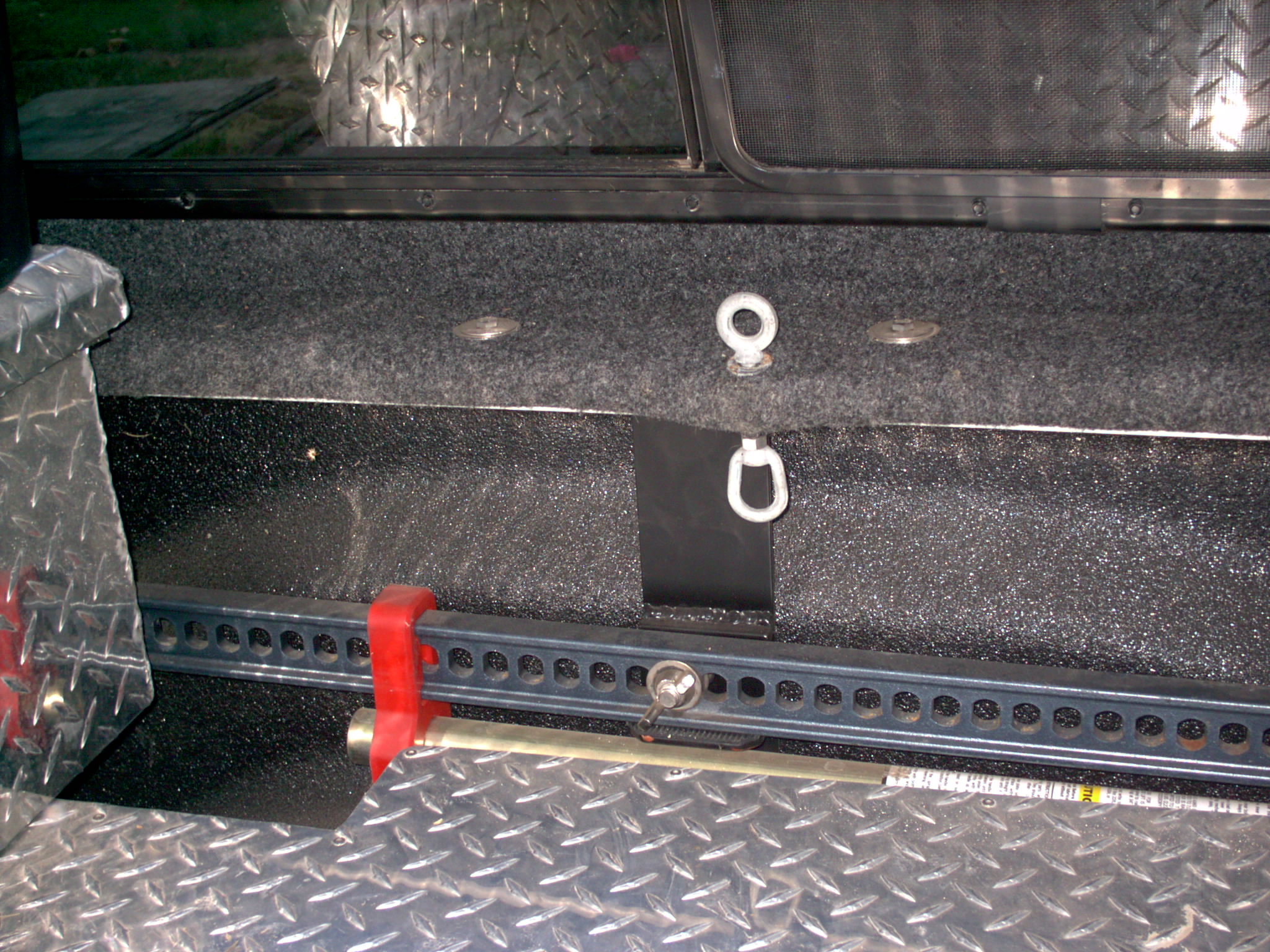

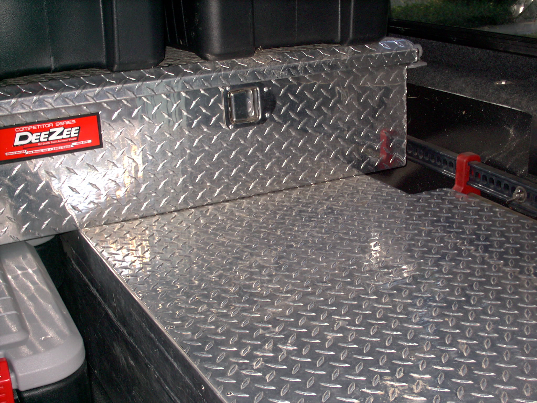

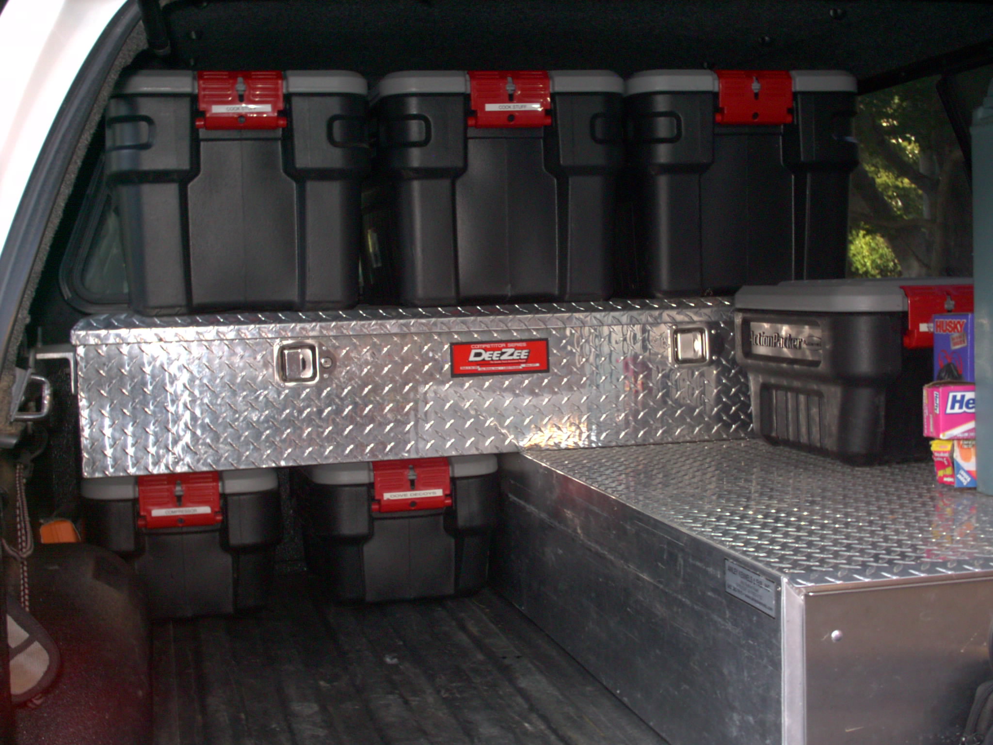

Posting on an old thread, but I had to clear out the back of the truck to get pics. This is the setup on my '05 QC PW. Spray-on bedliner (TuffSkin), covered by a SnugTop cab-high shell with a Conn-Ferr roof rack on Yalkma rails. The Dee-Zee crossbed box is mounted to the rails with heavy aluminum angles and eyebolts for tiedown points. It rests on the front end of a custom fabbed stainless steel and aluminum drawer unit from Ainley Kennels. The Dee-Zee carries recovery gear and tools, including full-size shovel and hoe, straps, chains, ARB X-Jack, etc. The Ainley drawer is five feet long with nearly full extension, even when loaded with hunting stuff; has a keyed lock plus a pair of loops for an HD padlock. The Hi-Lift 60" Extreme is mounted to the right side of the rails, behind the blue insulated jug. The jug is a 5-gal CamTainer (catering grade, lots of insulation) that holds cold water in the summer and hot water in the winter, plus a five-foot hose. The top of the Dee-Zee carries three large Rubbermaid Action Packers with a friction fit against the shell headliner, plus two small Action Packers friction fit under the Dee-Zee. All the Action Packers have loops for padlocks or zip ties. The big ones carry decoys, waders, camp gear. The small ones carry a spare compressor (Vi-Air 400P) plus hoses, chucks, pressure gauge, inflator-sealer, etc., plus miscellaneous stuff for the specific trip. Interior lighting is five Vision-X LEDs. When I need to carry extra gas or water, I can strap jerry cans inside the bed or RotoPax cans (http://www.rotopax.com/)on the roof rack.

Thanks. Took a while to figure everything out, but I think it was worth it for the way I operate. There are a few glitches, such as having to open the sliding window on the shell to fill the jug with ice, but I wanted to maximize use of available space. I could also swap in a 10-gallon CamTainer on the same mounts if I need to carry more water. The drawer unit comes out with two bolts, but you have to remove the spare to get to the bolts. The Dee-Zee box comes out with four bolts. The Hi-Lift comes out with a couple of wing nuts.
