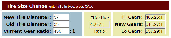

Any change in tire size changes the FINAL DRIVE RATIO, see the example below.Jack187 wrote:I am sure there is some power loss. It is just not very noticeable on the road. i am sure if I was pulling a trailer or doing some rough off roading it would be more evident. The mileage is the thing that surprises me the most. It is showing an improvement of about 0.7 MPG. This is before accounting for the 10% actual increase in mileage since the speedo is still off, so it is likely better than that.

With larger than stock tires it will probably hurt MPG if it's all stop-n-go driving, and probably help during long distance highway cruising speeds.

That actually makes sence lol by goin to a 37" it's probably more like dropping your gear ratio to closer to 3.73 resulting in better highway mileage but far less power off the line
