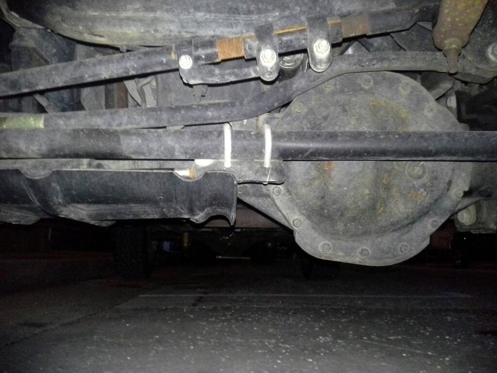

So they are replacing the solid tie rod and stabilizer clamp with a tie rod with a hole in it and stabilizer with bolt on end of shaft that goes thru tie rod to mount... I get the suits saying the clamp will loosen and it isnt as safe but in our world of heavy use offroad wouldn't it not be as strong? Im debating even taking it in for the recall... what if I'm planning on the carli mount down the road?
Re: New massive recall of 1.2M Ram trucks....
Yeah, I got the recall notice in the mail the other day. Anyone have a picture of what it's supposed to look like, so I don't have to waste my time driving to the dealer?
If you have the small u-bolts attaching the stabilizer to the tie rod it is supposed to be replacedJuday wrote:Yeah, I got the recall notice in the mail the other day. Anyone have a picture of what it's supposed to look like, so I don't have to waste my time driving to the dealer?
- jeep_boy02
- Posts: 1098
Like this...
