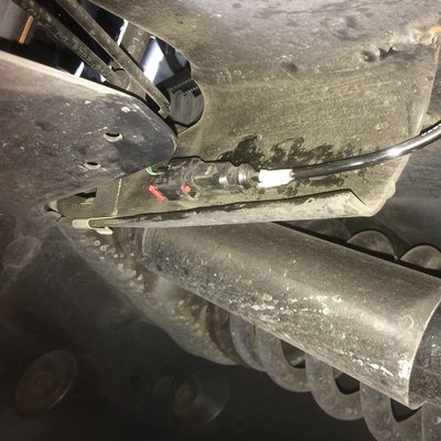

Well it just so happens that a 2016 CTD came in the shop today, so I had the chance to conduct a partial experiment. I disconnected the left front wheel speed sensor and started the truck with one push on the start button. The ABS and traction control lights came on and it set two codes, one in the ABS module for sensor fault and one in the drivetrain control module for implausible ABS data. Plugged it back in and the lights went out, then I cleared the codes. The connector is on the back of the shock mount tower. Slide the red CPA (connector position assurance) retainer up, then squeeze the release tab and pull down on the sensor end of the connector.

Just waiting on one of you nanny encumbered 4.5 gen. hooligans to take a trip to Donut City and see how far you get. Just watch out for the cops, I've heard they like to hang out where there's donuts. :lol: :popcorn:

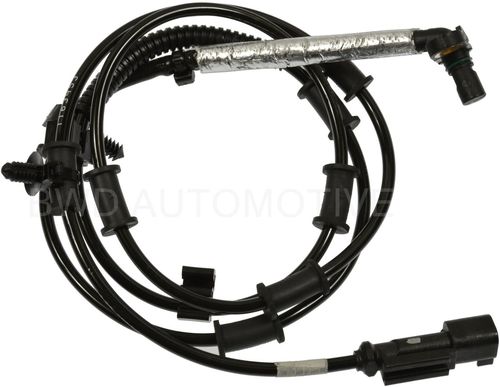

Did the truck start with any additional actions required or just normally? Do you know the part number and cost of a front wheel sensor?

Is that the sensor/wire that connects to the hub bearing?
I ask, because I do know that when that is not connected on a cummins truck the 4wd system will no longer work. Not sure if that is the case on our power wagons.

Reloaderguy wrote:
Sun Jan 28, 2018 11:48 am
The engine started completely normally with no additional actions required. O'reilly's shows Part # ABS3028 for $70.99. I'm sure you could find it cheaper somewhere else. I don't know the O.E. part#. It will be less $ on Amazon or Ebay.
Somebody just needs to unplug it and test the driving results before buying a sensor. It may not work due to yaw sensor input.

Location: State of Jefferson
Re: Kill-switch for electronic nannies
Post by Retired BLM Rig » Sun Jan 28, 2018 12:58 pm
Sun Jan 28, 2018 12:41 pm
Yes, hub bearing wheel speed sensor.
The 4X4 has to work on our trucks because we have a manual transfer case shifter. It may be a different story with an electric T-case or CAD.
So imagine that you're driving on your hilly unimproved property in 4Lo and you snag your harness on a piece of brush and the result is that you lose 4X4 function. That would suck! :angry:
