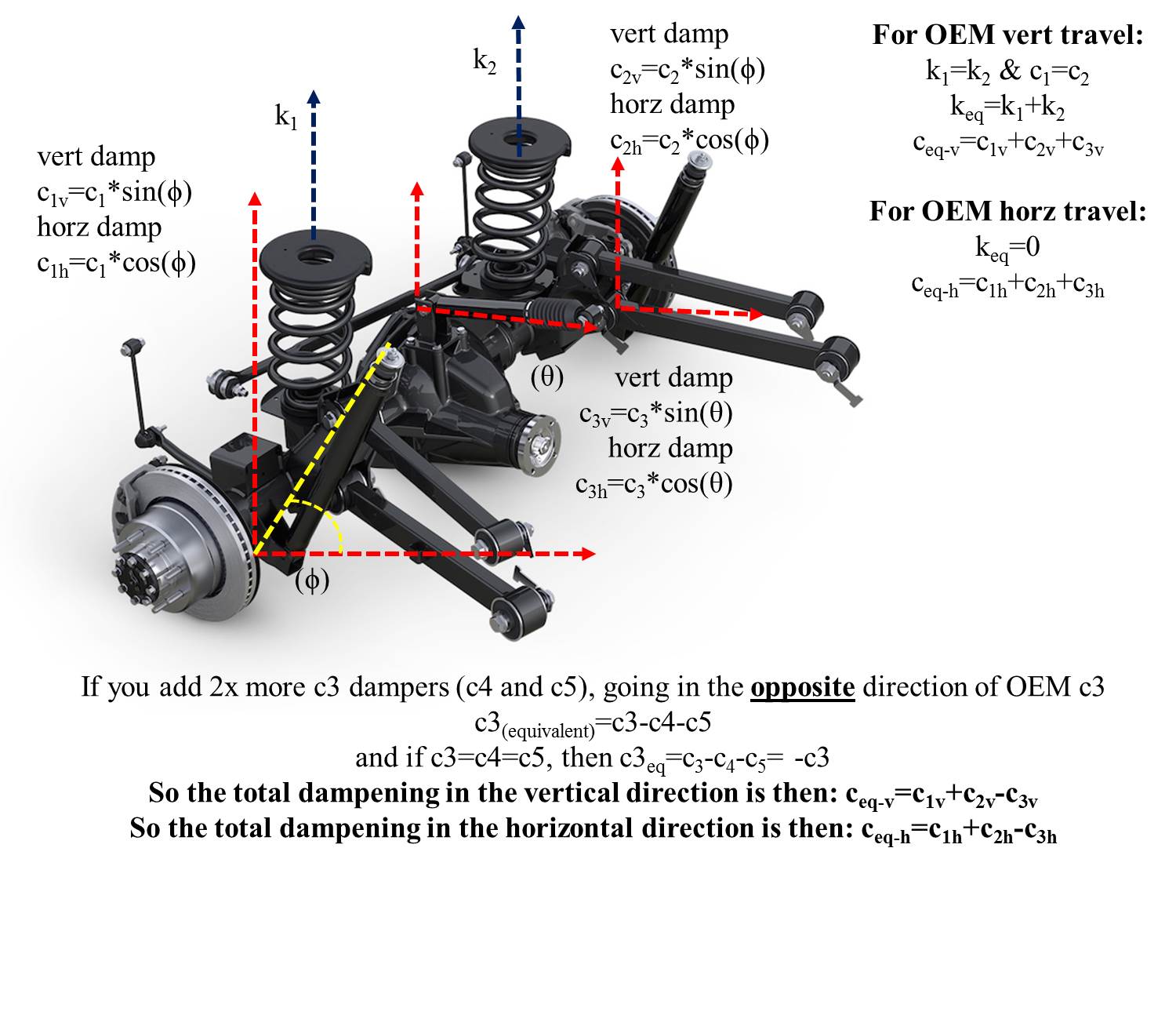

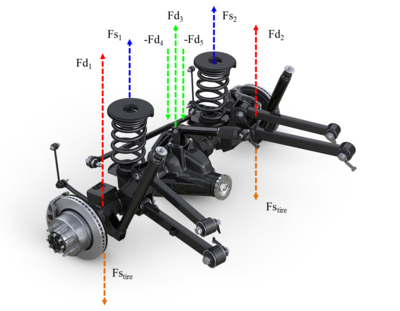

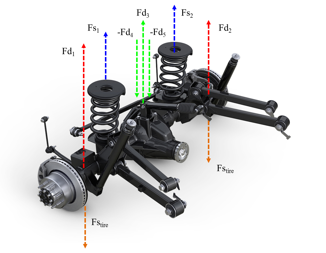

Here you go, just installed what is going to be my attempt at eliminating, or at least decreasing axle wrap/hop on my 2016 Power Wagon. All it cost me was the price of two shocks, and two longer bolts. It drives the same on the highway. Haven't had a chance to get it in the snow or sand yet, but I will report back after I test it out.

That's pretty crazy to me that the coil rear trucks still have hop/wrap issues. I daresay though that we are putting our truck's into situations a bit beyond what a design that has to be compromised enough to keep the masses and the bean counters happy can deal with though! I've managed to get my truck (a 2012) into situations where both front and rear axles are hopping, gotta get off the gas quick in that situation as it is quite violent and likely that breakage is imminent!!!
adeluca73- Thanks for the engineering explanations on the design! Some good reads!
MoparToYou- I hope your triple shock mod works for you! If it does make a good amount of difference, I would think it to be a good idea to do a little fab work to make your outer shocks mount is dual shear rather than single shear to avoid mount breakage! (ie- if they are effective enough to make a difference, they will be putting a LOT more strain on the mounting point!)

Sooooooo, whats the high speed damping like with two additional shocks?MoparToYou wrote:Here you go, just installed what is going to be my attempt at eliminating, or at least decreasing axle wrap/hop on my 2016 Power Wagon. All it cost me was the price of two shocks, and two longer bolts. It drives the same on the highway. Haven't had a chance to get it in the snow or sand yet, but I will report back after I test it out.
Re: Wheel hop, axle wrap...
Man that's awesome. Did you have to drop the rear end at all, or did you just bolt the extra two shocks on in place with a longer bolt?MoparToYou wrote:Here you go, just installed what is going to be my attempt at eliminating, or at least decreasing axle wrap/hop on my 2016 Power Wagon. All it cost me was the price of two shocks, and two longer bolts. It drives the same on the highway. Haven't had a chance to get it in the snow or sand yet, but I will report back after I test it out.

I just bolted the shocks on with the truck sitting in my garage. These gas pressurized shocks are stiff, and I have a rotator cuff injury, which limits what I can do with my right arm. So I wasn't strong enough to compress the shocks to the right length without using a lever to press against one end of the shock to compress it. Other than that, everything went together quite easily. The bolts are m-14 x 180 mm, with a 2.0 pitch so I could use the stock nuts. Hardness is 10.9.
I can't tell any difference in highway ride. These shocks really don't move with normal suspension movement, they only function to prevent axle wrap.
If there is any angle on those shocks, they will compress slightly even when the axle moves up and down. Looks like a good attempt, especially if it has any wrap play in the factory bushings but I wonder if it'll do anything at all for hop. Hurry up and go try it! haha
