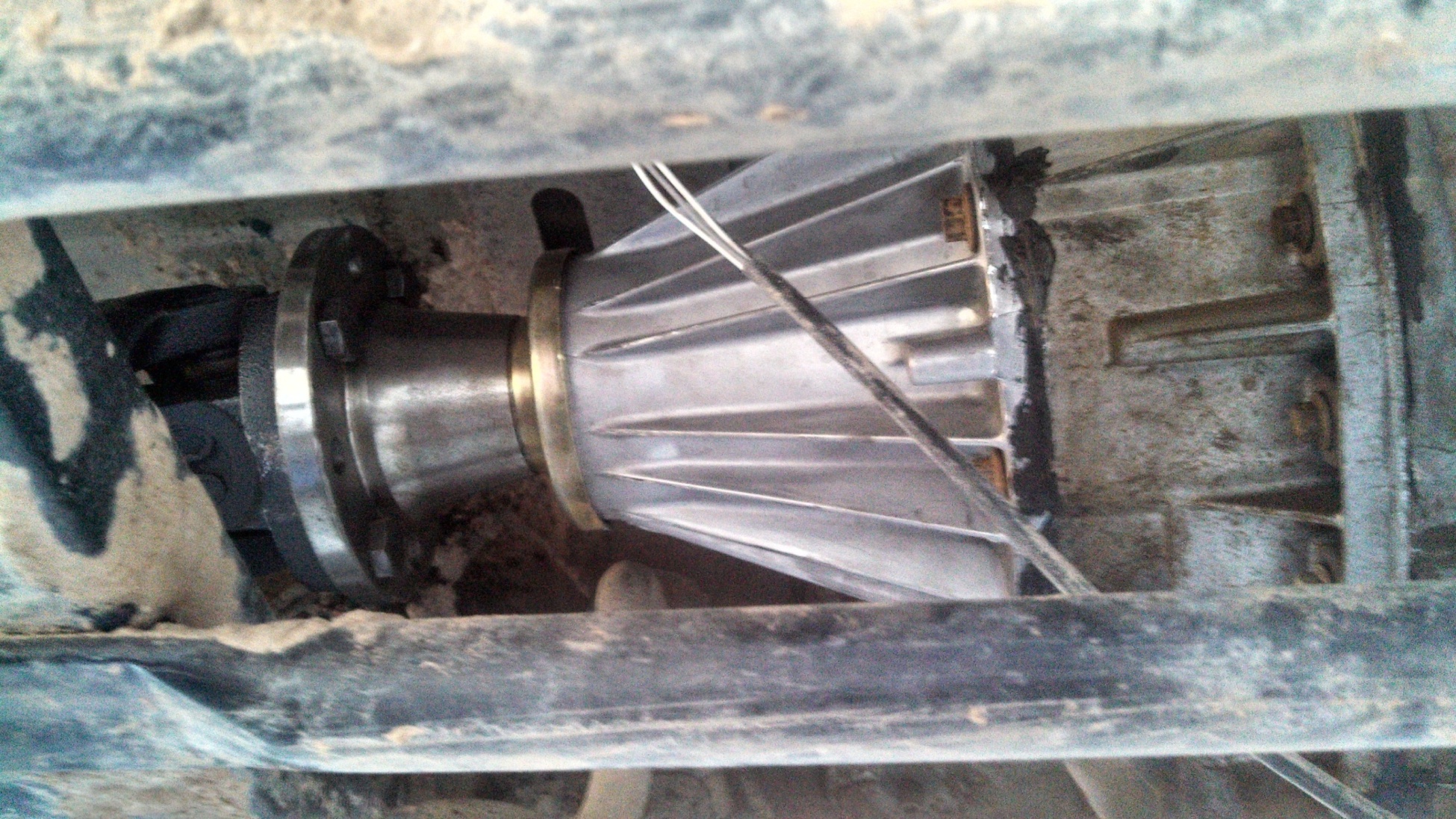

On the topic of the rear driveshaft, I am contemplating a little different of a setup: a two piece shaft with a carrier bearing. I'll retain the stock slip yoke but, it will only go on a short shaft that leads to the carrier bearing, then another shaft will go to the axle. I think this will solve the clearance issue, and will keep me from having issues if I do break a shaft since the shaft portion most likely to break would be the one from carrier bearing to pinion. (the carrier bearing will keep the other portion on place) That way I don't have to tear apart my t-case, I gain a little more clearance under the driveshaft, and I don't have to worry about balance issues with one long steel shaft.
bstefanic- You are definitely right!!!- a new driveshaft is definitely on my list of to dos! But, it's going to be a while, $$$! I saw your driveshaft, mine was not as gouged so, hopefully I will be good for a while. It is definitely high on priorities list though!!! (do NOT want it ripping apart on me!!!)

I think a two piece ds with a carrier bearing will be much more expensive. I did my SYE with a custom tom wood's ds for about $900 total, that was with me pulling the transfer case and delivering it to my local shop...and hell pulling your transfer case is a giant pain in the ass but fun as hell. Tom woods shafts...you never have to worry about the balance, plus their warranty is incredible. It shouldn't run you more than about $130 to have the transfer case parts swapped out at a good shop

bstefanic wrote:I think a two piece ds with a carrier bearing will be much more expensive. I did my SYE with a custom tom wood's ds for about $900 total, that was with me pulling the transfer case and delivering it to my local shop...and hell pulling your transfer case is a giant pain in the ass but fun as hell. Tom woods shafts...you never have to worry about the balance, plus their warranty is incredible. It shouldn't run you more than about $130 to have the transfer case parts swapped out at a good shop
I'm surprised you were able to get done at $900, I was thinking more like $1000. I don't think the two piece shaft with carrier will be as much, the shop that balanced my shaft builds shafts in house and could do the whole setup for less $$$, I'm pretty sure at least. I've had Tom Woods shafts before on my ZJ, they are nice!!! I'll have to talk more with the local shop here and see what $$$ I'd be looking at, I was considering the two piece and carrier route partially for cost savings.
Also, I was looking at my t-case the other day- my tails haft is not removable, it is part of the back half of the case. So, I would have to replace the entire back half of the case or maybe do a transfer case swap all together. For 2012, Ram switched to the Borg Warner 44-47 transfer case, here is what my t-case looks like:

Hmm, no kidding...that definitely isn't the way my transfer case looks. The tail housing is separate from the main rear case.

Ok...yea so a two part ds might actually be cheaper. I know some newer F-350's run a two piece (have crawled around under some at work) might be worth looking at those and modifying them. Also, couldn't hurt to just give tom wood's a call...I couldn't believe a custom ds cost the same as a stock one. They might be able to come up with something for you.

I wish I had a t-case like yours!!!! Looks like I don't have an SYE option, unless I want to go swapping t-case! (Or, could go the kinda questionable drill and tap the output shaft and "customize" the existing yoke as a fixed rather than slip (seen it done on other t-cases) but, seems kinda sketchy to me!) I Googled but, I didn't see ANY slip yoke eliminators for the 44-47. Makes sense though, it's only been in the PW since January 2012 and it is an integrated tailpiece t-case so, an SYE would require either a new back half or a LOT of machining to the existing back half.

bstefanic wrote:Ok...yea so a two part ds might actually be cheaper. I know some newer F-350's run a two piece (have crawled around under some at work) might be worth looking at those and modifying them. Also, couldn't hurt to just give tom wood's a call...I couldn't believe a custom ds cost the same as a stock one. They might be able to come up with something for you.
I agree!- the stock driveshaft for our trucks is CRAZY pricey!!! Getting a Tom Woods shaft beats the heck outta a stock shaft for the same $$$! Yeah, the newer F-350's and a LOT of medium duty trucks have two piece! (saw quite a few laying around the local shop here)
A quick google search yields that I'm probably going to be looking in the $900 range as well. (looking at similar setups)
Looks like Jesse at HIgh Angle Drivelines does a LOT of the two piece F-350 shafts. I had HAD driveshafts in my 87 GMG Jimmy, he does good work too!

I honestly don't know the real differences between the 44-47 and the NV271, other than the tail housing.It looks like they have a little different of a low range ratio- the BW 44-47 features a 2.64:1 low vs the 271's 2.72:1 (IIRC) low. The Borg Warner is supposedly stronger (its introduction coinciding with the upping of the towing capacity of all the HD line) but, that could be coincidence and not the fact some assume it to be.
I'd be willing to bet the input gear and the bolt pattern are different as Ram put the new six speed auto into the trucks in 2012, and I'd wager it was at the same time as the new t-case.
