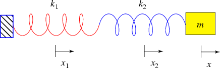

That's not necessarily true. It depends on whether the springs or dampers are arranged in PARALLEL or SERIES.MoparToYou wrote:Whatever damping one shock provides, two shocks should provide twice as much, and three shocks should provide three times as much. I have my doubts it will fix the problem, but it may help decrease the problem. Ram thought it was going to help, so they put a shock on there from the factory. The way the shock mounts are mounted makes it such an easy mod though, that it is worth trying. All I will be out is the cost of a new shock and the cost of two longer bolts and two sleeves.
In parallel, the equivalent spring (Keq) or dampening constant (Ceq) is: Keq= k1+k2+...kn
In series the equivalent spring or dampening constant is: Keq= (1/k1+1/k2+...1/kn)^-1
- Springs in parallel
- image.gif (4.92 KiB) Viewed 4254 times
- In series
- image.gif (5.17 KiB) Viewed 4254 times

hmm, well actually it does, the equations for calculating both the equivalent dampening coefficient and equivalent spring coefficient are the same. I posted pictures of springs in parallel and in series, but the math applies equally for dampeners ( shocks). The "spring rate" is calculated from manipulating Hooke's Law, which is K = F/x, and is how much force it takes to displace a spring 1 unit of measurement, and is only applicable for linearly elastic springs, and doesn't apply when springs are extended beyond their linear region.MoparToYou wrote:The spring rate with parallel vs series springs that adeluca73 is talking about doesn't even come in to play. I'm talking about shock damping. There isn't a spring in the shock, I'm just doubling the damping of the shock by doubling the number of shocks. I ordered the shock from the dealer today, along with a Mopar rubber bed mat. They should be in in about a week, but then I need to get it from the dealer, which is 130 miles away. I may make a trip over to get it, or may just wait until they have someone coming this way that can drop it off for me.

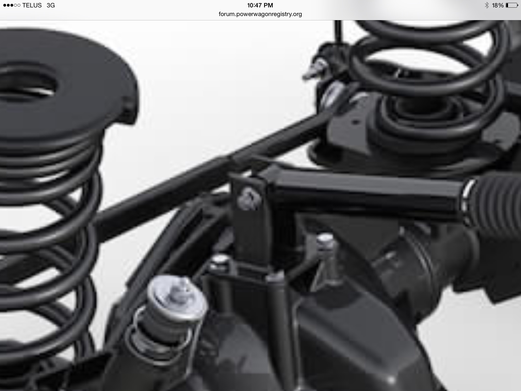

I find it interesting that this picture of the Ram 2500 rear suspension shows a plain black painted kicker shock.
A Power Wagon, however, has a yellow Bilstein shock with a blue shock boot in the same position as that plain black shock. So one has to ask them self, "self, is there any difference in damping between the Bilstein kicker shock and the plain black kicker shock?" Also, is Ram using a steering stabilizer shock here, that is very stiff, and damped equally in compression and extension? Or are they just using a generic Bilstein suspension shock, that will typically have far more compression damping than rebound damping. When I get the new shock I'll at least try and see if it has equal damping in both directions, although I'm pretty sure I'm not going to be able to push the shock shaft fast enough in either direction to be able to say.
Based on that picture, it looks like there are basically three ways to decrease axle wrap with this suspension. 1. Change the mounting points of the control arms on the axle, so there is more leverage on the axle to hold it in place, and not let it wrap. 2. Change to control arms that don't have giant 3" diameter soft rubber bushings. 3. improve the function of the anti-wrap shock absorber to try to reduce axle wrap. The first two are complicated and expensive, so I'm going to try #3. These would be separate from any improvements that may come from changes in tire pressure, etc.
Re: Wheel hop, axle wrap...
Hey here is a thought. A person could easily make up a slightly longer version of this mount. Say 1 to 1 1/2" longer AND could put different mounting holes in it. See what kind of change you could get. This also makes it look like a person could very easily with out welding to the axle install a V style 4 link and remove the upper control arms and make a real 4 link here. Just throwing it out. I'd personally make a multi position mount and try that too. Being able to bolt to the axle
Imagine being able to remove the rear track bar.....
