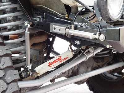

https://www.offroadevolution.com/produc ... ct-jk-jku/
But I suppose if you wanted to get fancy, you could use this one >>
https://www.offroadevolution.com/produc ... isconnect/
And if you wanted to get REALLY REALLY FANCY you could do an Anti-Rock Sway Bar >>>
https://www.currieenterprises.com/unive ... -sway-bars
I know one guy with an Anti-Rock on his Power Wagon. Going to check it out next week.

Re: Locker Bypass
im really debating going evo air disconnect...
i keep on feeling like i need in cab control, so i can flick it off for daily driving on torturous florida highways and back on before i take the exit ramp at 80.
my hold up is the fact that no bar is way to soft with body roll, thurens requires you to tie it up if you want to disconnect, and the stock bar has too many holdups with the computer.
an on demand in cab evo disconnect with no computer faults just seems like the best option.
how reliable should that coupled with an air system be?
why dont more people utilize the evo air disconnect when it solves so many issues... an air system is just the kicker.

AIr would be nice. The only reason I didn't do that, was my smartbar went bad literally two weeks before we left for Power Wagons in Moab last year, so I ordered the manual one to just get it put in and be done with it in the amount of time I had to get stuff done.
I've seen a lot of Jeepers with the air version. Although even more run an Anti-Rock sway bar which is a torsion based bar.

I Am Going on board air for my tires, so it only makes sense to throw a solenoid and air line on....
ill get this all done at the next oil change. air disconnect it is.
Re: Locker Bypass
Like I was saying...
So Chris did the rear sway bar, I told him to do the front... The report so far is good. We're going wheeling this week. I've been in Moab since Sat, Chris will be here later tonight.
