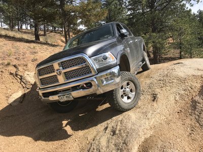

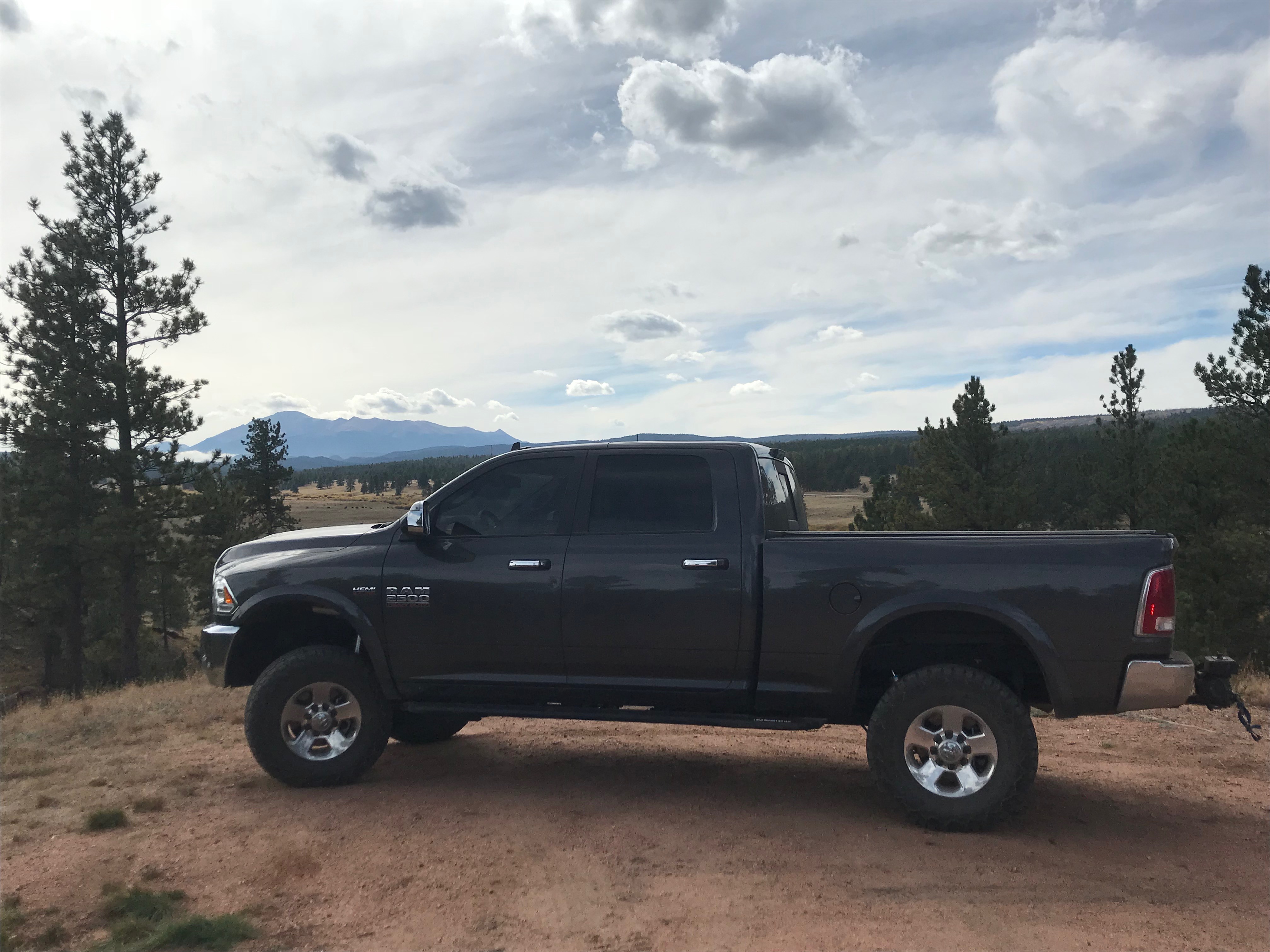

Did about 150 miles today. Over half dirt.
This with the Thuren PW 2.5" King kit. stage 3 valving. Front Boogie Bumps BFGs at 46 psi front/39 psi rear
First dirt roads had some snow. Lots of elevation gain. Narrow, tight. Washboard. Faster was better. Didn't hop but definitely knew you were on washboard. A little harsh.
Next was a downhill section, smooth with big erosion berms. Started to push. Truck never bounced. Never pitched. Never kicked. Went faster and faster. Finally hit one a little hard. Front soaked it up. Boogie bump rocks. Used most of the shock travel. Rear was a little harsh, guessing I hit the bump stops in the Airlift Ultimate bags. However, stayed straight. Stopped due to the smell of gas (my spare gas can split on the impact...)
On to some more technical trails. Truck did well, always enjoy the lockers.
Goal was to get from the end of the trail back to town in 2 hours. Made it in 1:45. Suspension did great going fast. Low range climbing out of the trail, on hard dirt roads, wen to 4wd Hi with 2 Lo kit engaged so I could disable the ESC and unlock the sway bar below 18 mph.
Good day!

Doing it over, I would probably do Stage 2 but I haven't towed or hauled with it, and I'm guessing the stiffer valving will help up with 3000 lbs...
