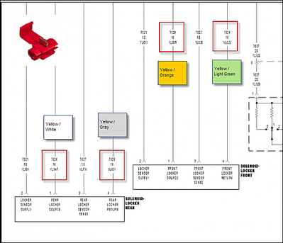

Here is the wire coding for the front and back lockers you will only need two wires per locker, all are Yellow/** with a colored stripe on them. Source is HOT, Return is Ground.
I used Quick connects (supplies pic) to splice in my wires, that way I did not have to cut them, and I could remove for warranty issues. (I do not have a warranty any more). If you are new to Quick Connects, there are different sizes, get the ones for your wire.
I used 12 ga. Wire and connect. One of the sides to the quick connect goes all the way thru, the other one goes half way. The one that goes all the way thru should be on your locker wire. I used the below switches for I had two in the tool box, you can use what you want, but I wanted a Light switch, to know I have them on. note: these switches will not tell you when you are engaged, only that power is going to the locker. But..you will know. when they are locked. Refrain from locking on dry concrete or asphalt, you lockers can take it but your tires may not.

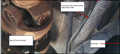

Your Rear locker wires are right below the floor board on the driver side. I just opened up the wire cluster and pulled out the two I needed.

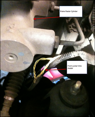

Your Front locker wires can be found just under your Brake Master cylinder.

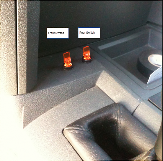

I drilled two holes to mount my switches. I ran both Black wires from the lockers to a ground bolt just under my transfer case shifter. I ran the Power wire (Red) to the inline fuse and the split it so I could hook it to both switches. Then I ran a Ground wire from each switch (for lights) to a another ground Bolt in the same area.

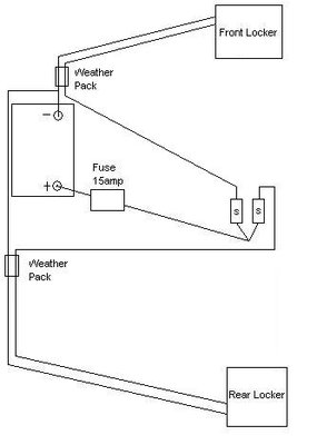

And here is another simple diagram I've saved that someone else made.
