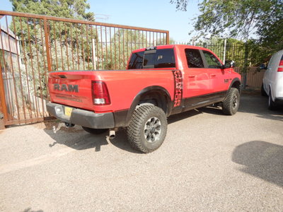

FordyceCreekTrail wrote:15K on Duratrash is about max. I bought 35 Inch BFG KM3s and they really run small, no rubbing and they work great. 37s dont seem to take much work to fit, however things like gearing will come into play.
Can you post a photo or two of your truck on 35in KM3s? I’m in between those and the Toyo MT at the moment.

Post by FordyceCreekTrail » Tue Sep 11, 2018 8:53 am
Here is the 2 photos I took.

FordyceCreekTrail wrote:Here is the 2 photos I took.
That looks great! How are you liking them?
