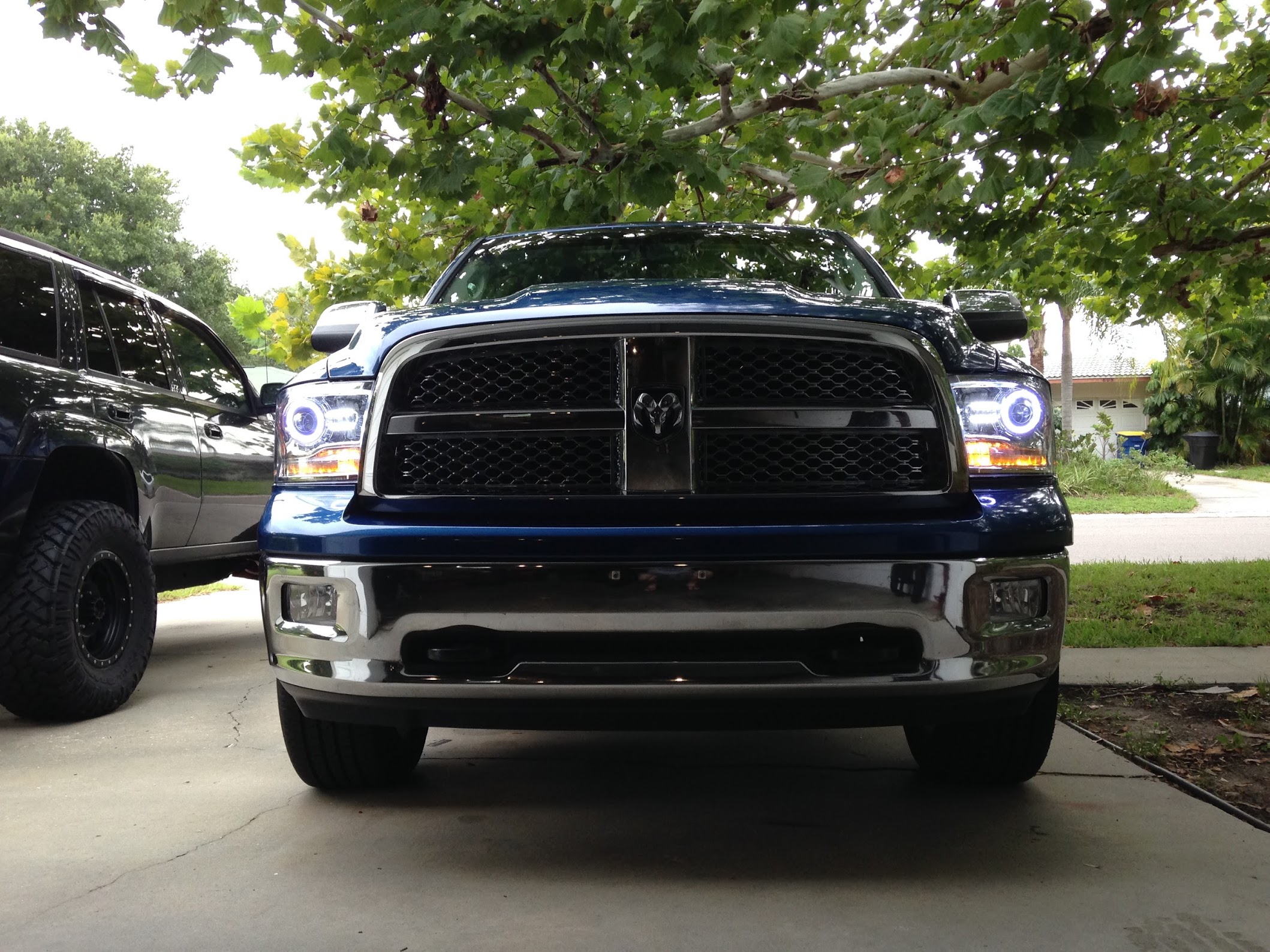

So I have owned the Morimoto FX-R's. They are amazing, light output is superior to the factory projectors. From my experience with ebay projectors, they are worse than the factory OE projectors.
I had Morimoto FX-R projectors in my 1500 in lights I had built by the retroshop.us - and I used DDM Tuning HID's in them. Fantastically bright, excellent beam pattern with sharp cut off. Much better than the factory which is washed out. Even with my DDM HID's in them.
The only thing that has kept me from doing that all over again is the cost. It was substantial the first time, and when my LED's halos failed like 5 months later it really ticked me off. And I decided I was done with those kinds of mods.
