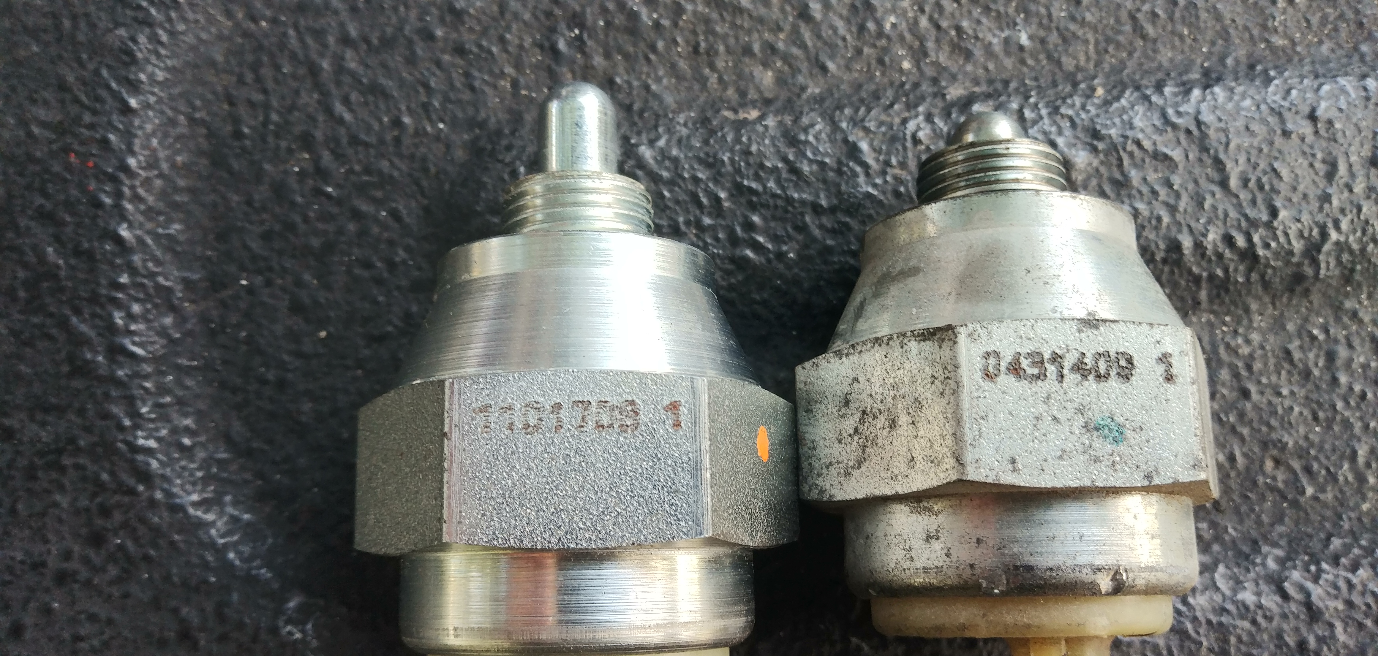

Fixed:
I was able to resolve my issue with part number 68211454AA - 4WD Switch with Magnetic Assist. This is simply a switch that sits on top of the transfer case and sends a signal to the computer that the transfer case is in 4WD.
This is for the manual shift transfer case. Mine is a BW 44-47.
Assuming you have a bad switch, the "4WD Shift in Progress" message is just the beginning of your problems. It only gets worse as the plunger is sucked further and further up into the switch housing over time (can no longer protrude far enough to indicate 2WD).
Symptoms:
  • At first it was just intermittent "4WD Shift in Progress" - Dealer could not resolve issue on multiple attempts.
  • Then a few months later the ESC light illuminated and the 4WD light flashed - Dealer flashed the computer but did not resolve issue.
  • Then a month later, the dash lit up with ESC and 4WD lights, the front axle actuator engaged while I was rolling off a stop sign. I had to crawl under the truck and unplug the front actuator so I could get home.
  • After I made it home - the dash light started flashing "4WD" and "Lo". The ESC light was on as well. The back brakes then engaged in traction control and the inside wheel hopped when I turned, as the computer thought the outside wheel was slipping.
I did not go back to the dealer, I did my research and determined this is the only thing it could be short of a bad computer or a wiring harness.
Test: Unplug the connector on the switch. Start Truck. The Shift in Progress message and any 4WD light will go away. You will see "Serv 4WD" since you unplugged the connector.
Note: When the computer thinks the T-case is in 4WD, the ESC light will illuminate on the dash.
Note 2: When this switch is bad it will not generate any codes as long as it is connected. The CPU simply thinks the T-case is in 4WD.
Bottom line - fix this before if breaks completely. It can leave you stranded. Unfortunately, the Ram engineers didn't think to have the truck return to a steady state of 2WD when this fails. Rather they had it send a signal that 4WD is engaged even though it isn't. It is engineered backward in my opinion.
Good news is that this is a cheap part and is a 30 minute fix. You will need a 90 degree pick to remove the connector and a 1.5" socket to remove the switch. Switch is located on top of the t-case on driver side.
In the picture attached, the switch on the bottom is the old one that failed. The plunger will not stay protruded so the signal is sent that the T-case is in 4WD.
TIP - don't forget the O-ring when you put the new one in.
