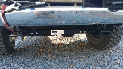

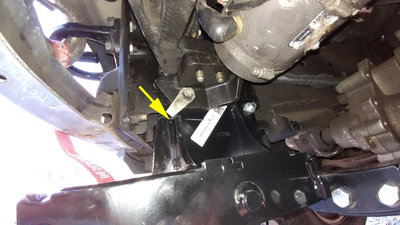

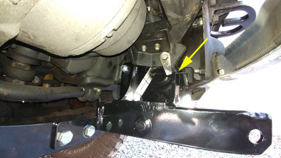

Just in case anyone wanted to see how its mounted with no winch removal. 2013 PW, 8.5' Western ProPlus with the Ultramount II system. I don't see any modifications other then cutting half of the ears off each of the Western brackets (pictured with yellow arrows). It looks like they may use a new cast part for the winch mount?

Sorry to revive an old thread... The Western looks like it fits nice. I'm going to be installing a Boss on my '13 within the next couple of weeks... Thinking the passenger side support bar may interfere with the smartbar, and require some cutting/welding (not a huge deal, but a PITA nonetheless).
How difficult was the wiring harness to install (if you did it yourself)? Without the Plow Prep, I guess it's tougher (not even an option on the PW). Couple thread's I've seen on it look like most guys just wire up the plow lights totally independent from the factory headlights, which might be what I end up doing.

I did not do the install myself, there is a local shop that is familiar with PW's and does them in less then a day. I don't think there are any issues without the plow prep, I think everything is still plug and play, at least with the Western harness it is.
