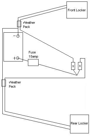

Anybody have a wiring diagram of how to wire the lockers on an 05 PW so that I can use them in 4HI? I know there's lots of info on this topic, but I haven't been able to find a diagram anywhere. Thanks for the help!

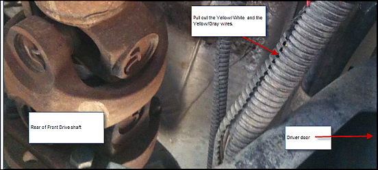

There's also the option of hardwiring your lockers. Here's some diagrams and pictures I've saved for my own future reference.
Here's a thread that discusses it with a link to another forum where I saved some of the pictures from.
This is the connector you would need if you wanted to plug straight into the axle housing without damaging your factory harness.
Now you have two options to consider, however this one would certainly cause your "Service 4X4" light to come on, but it also has no restrictions as to your speed limit or throttle mapping.

Probably better to use low power wires from the switches to relays, then bigger wire from the relays to the lockers.
The switches should be powered by a source that only comes on with the ignition and you should have a way of cutting power to the relays(eg: pulling a fuse) to avoid activating the lockers if you hit a switch accidentally.
I insert my locker relay fuse as I am airing down and pull it when airing up.
