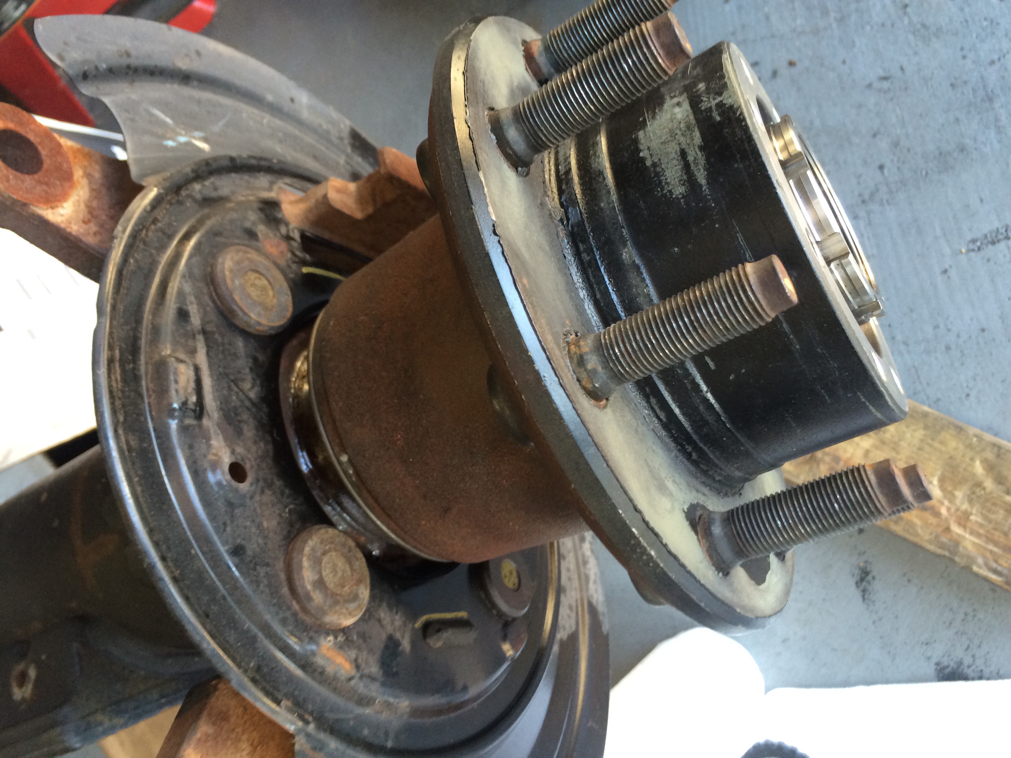

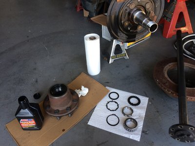

Re: Diff fluid change? Rookie help.
Post by Colibri » Sun Jul 30, 2017 7:45 pm
if you jacked up to drain the hubs did you also jack up to fill them? How high did you lift? The bottom of the hub is lower than the bottom of the axle tube, so you have to get it pretty far up to drain fully.
Pics for reference. I think you're fine, probably just overthinking things a bit. Good work getting out there and tackling it yourself sir!

Post by Hammerballs » Sun Jul 30, 2017 8:08 pm
I guess I didn't drain them. I didn't lift the axles until I was trying to refill. Damn it! just bugs me when things don't go to spec. It's the OCD. Lol! I only have about 9500 miles on the truck total. The old oil was still pretty clean looking. There wasn't much of anything on the magnets. Definitely wiped some fi hine metal dust off the cover. I just don't want anything to go wrong because I fucked up. Will be towing a little 2000lb trailer through the mountains for 10 days starting Tuesday.
