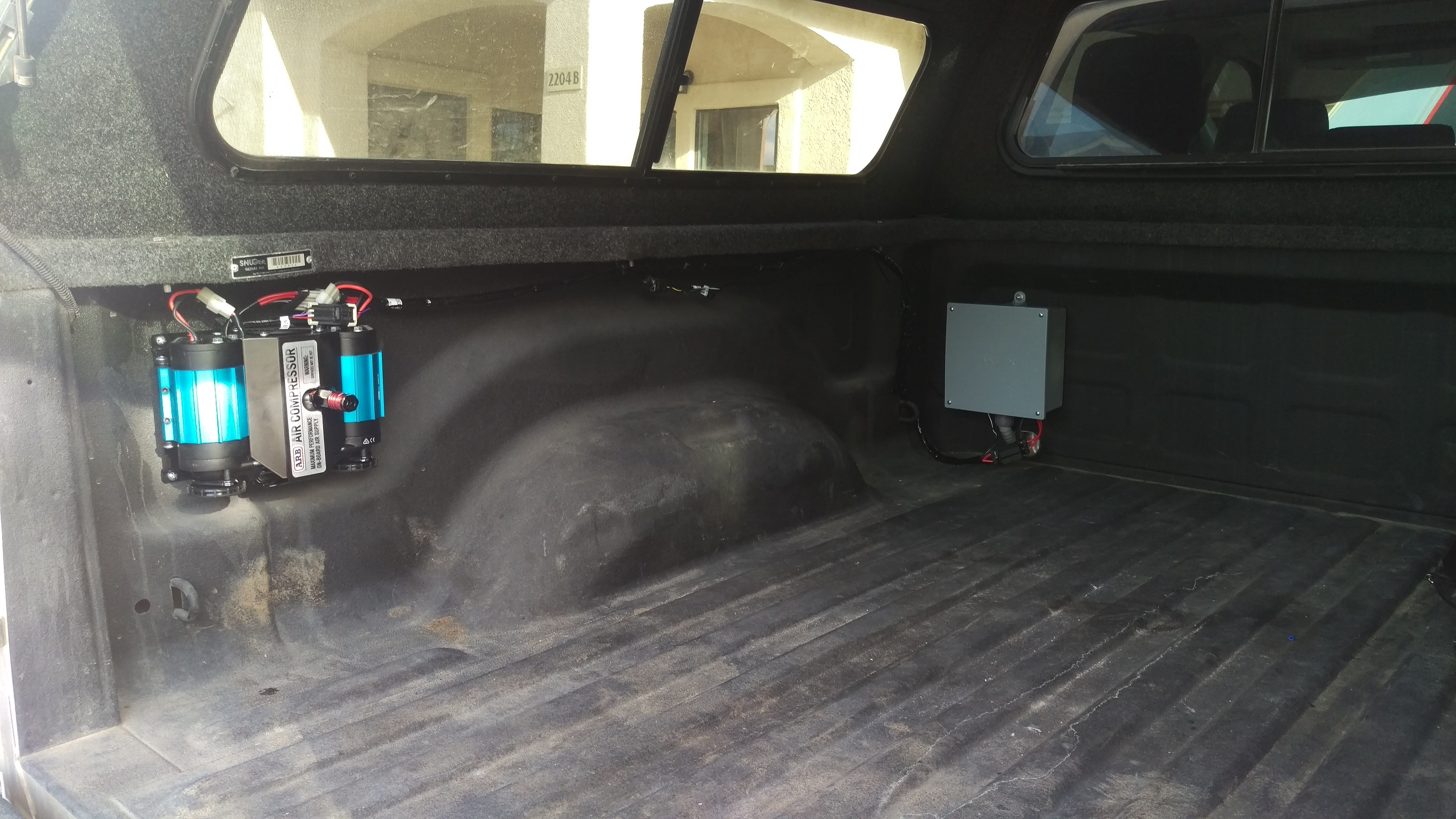

Ultimately I went with a permanent mount, and will add a 5 gal tank in the future. The ARB twin supplies 6.16 CFM at no load and 4.65 at 29 psi per ARB, and is 100% duty cycle.
After I got the compressor, first step was to figure out where to mount it. Lots of ideas on the interwebs. Most mount it in the engine bay or under a seat. If I could find a spot in the engine bay I would have thought of mounting it there. As for under seat option, access to the air connection and having the compressor noise while in cab ruled that out.
As I stated earlier, I will be adding a tank in the future, but wanted to be able to run a hose directly from the compressor now. I decided on a bed mount.
There is a company that makes a universal mounting bracket for the compressor. That fits perfectly between the wheel well and rear of the bed, over the upper recess in the side. Unlike most of my other projects, I only took pictures after the install was complete, so I’ll do a quick description of each step I took.

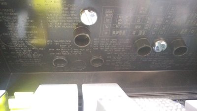

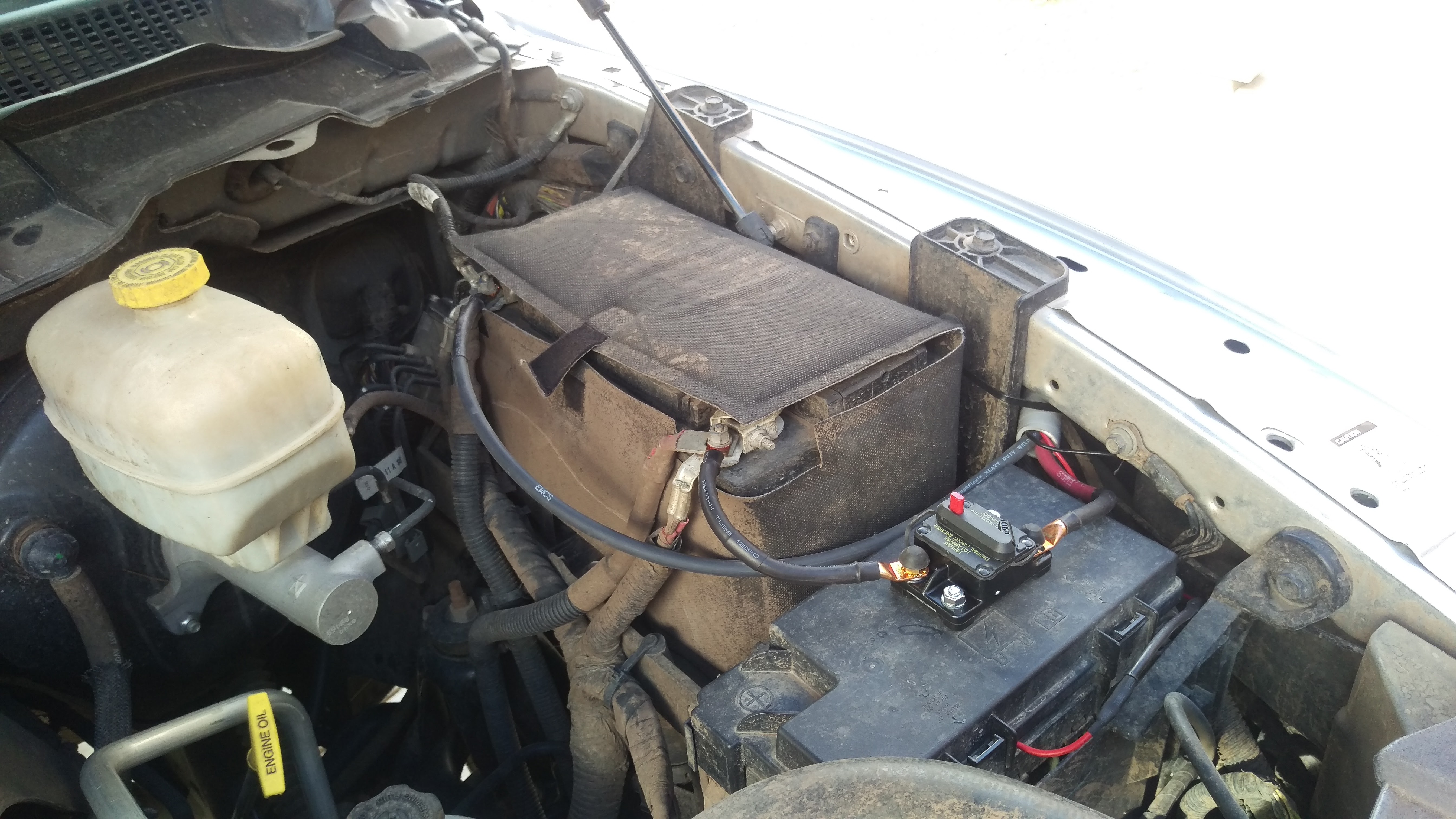

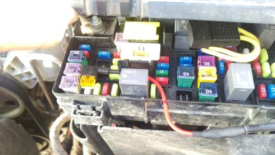

Starting up front, I installed a 100 amp 185 series blue seas systems circuit breaker. It fits perfectly on the fuse box, with hole drilled the where you can still see the legend underneath. I ran 4AWG welding cable, red and black from the engine bay to my bed via liquid tight electrical conduit from any of the DIY home repair stores. I wanted better protection than the cable insulation or the light weight corrugated wire covering.

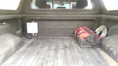

In the bed of the truck, I mounted an 8 inch electrical box from the same DIY home store. I had seen so many awesome looking mounting plates/brackets for JEEPS or Tacos. Makes you wish you had one, but then your like, um no, my PW is the bee’s knees. The though only crossed my mind due to the fact that they make everything you can think of for install on those two.
This is where I also mounted my Switch Pros that I bought over a year ago and hadn’t got anything after that until now.----the Switch Pros is awesome by the way.
I ran the positive to the switch pros unit, and the negative to a Blue Seas common busbar. Now I have a power source in the bed of the truck. I’ll also install a dual battery setup in the bed at some point as well. I connected all my leads from the switch pros to a Blue Seas terminal block. Makes for super easy install of future switched accessories. The 2 power leads from the compressor run to the box, as well as the 2 ground wires. For the switch, just connect the black and purple wires to the busbar and respective switch on the terminal block.

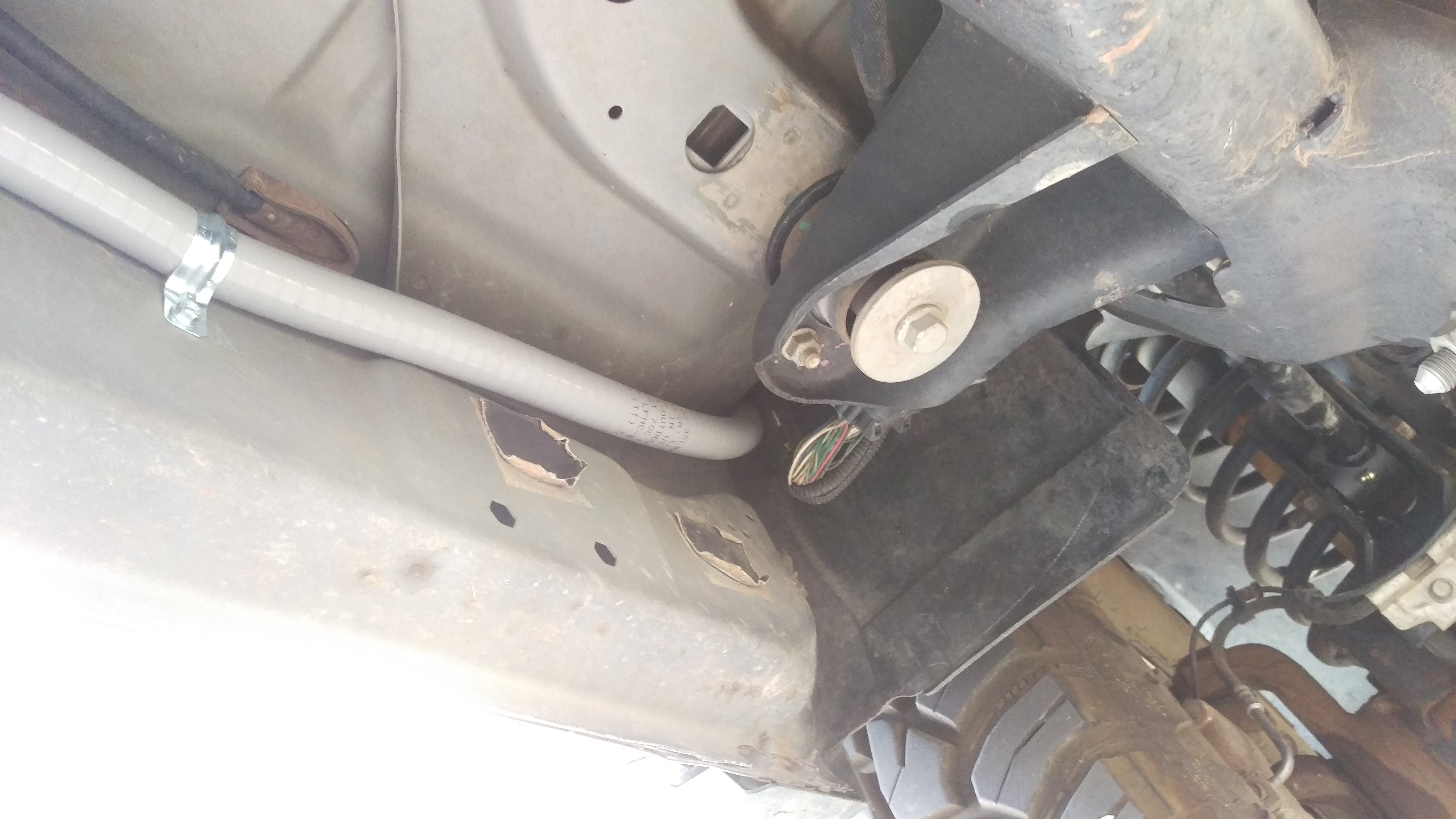

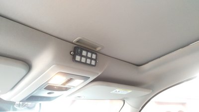

As for the location of the switch pros switches. I ran the cable above the headliner and out the rear of the cab behind the driver side rear seat (yes I drilled a hole, and used a 1/2” rubber grommet)

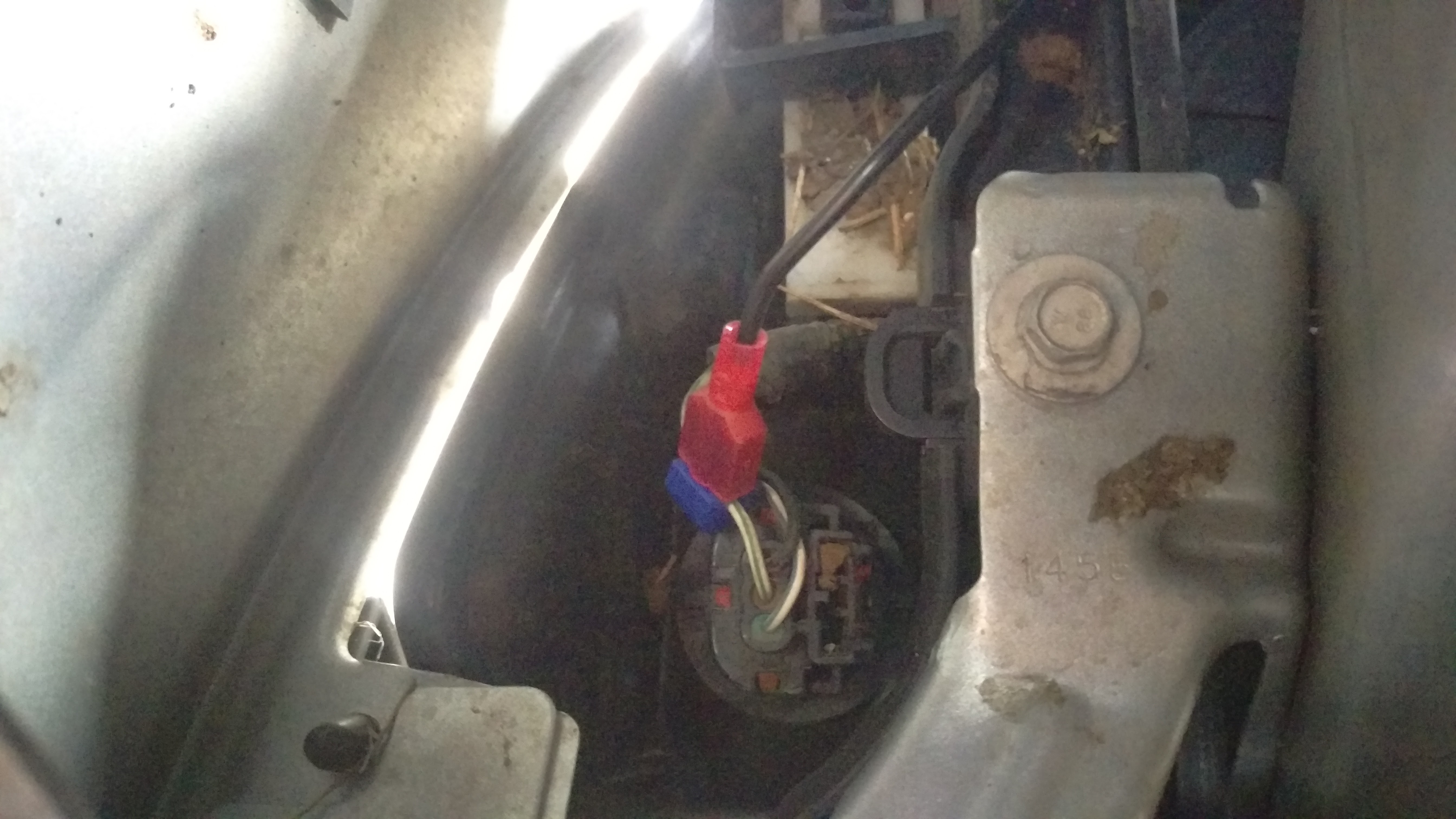

Back up front, I ran the blue wire for the switch pros harness to an add-a-fuse at M7. The yellow wire from the switch pros goes to the white/green stripe wire off the side marker light, driver’s side. I ran red and black wires for the acc and light wire as seen in the box. Well that’s the basics of the install. Pretty simple. I’m no electrician, but I think I did a damn good job running the wires/cables.

Nice write up sir, I really like the clean install of the switch panel.
