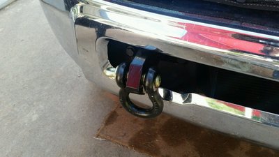

Has anyone replaced their front tow hooks?

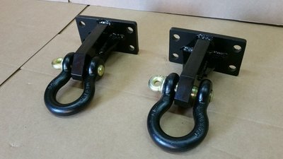

I was browsing Ebay yesterday and came across a guy selling some pretty beefy shackle mounts that replace the factory tow hooks: link
Has anyone installed these? I'm thinking about swapping on mine so I can use in conjunction with a D-ring Hi-lift adapter to safely lift the truck when it's on 37s.
Those welds don't look amazing but I think I might order a set and see what they look like in person. I'll keep everyone posted.

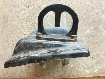

I believe they have been discussed. I like the looks of them. I do, however, wonder about off- center pulls. That could be alot of leverage to the side, since they are so long.Let us know how the gussets are set up.

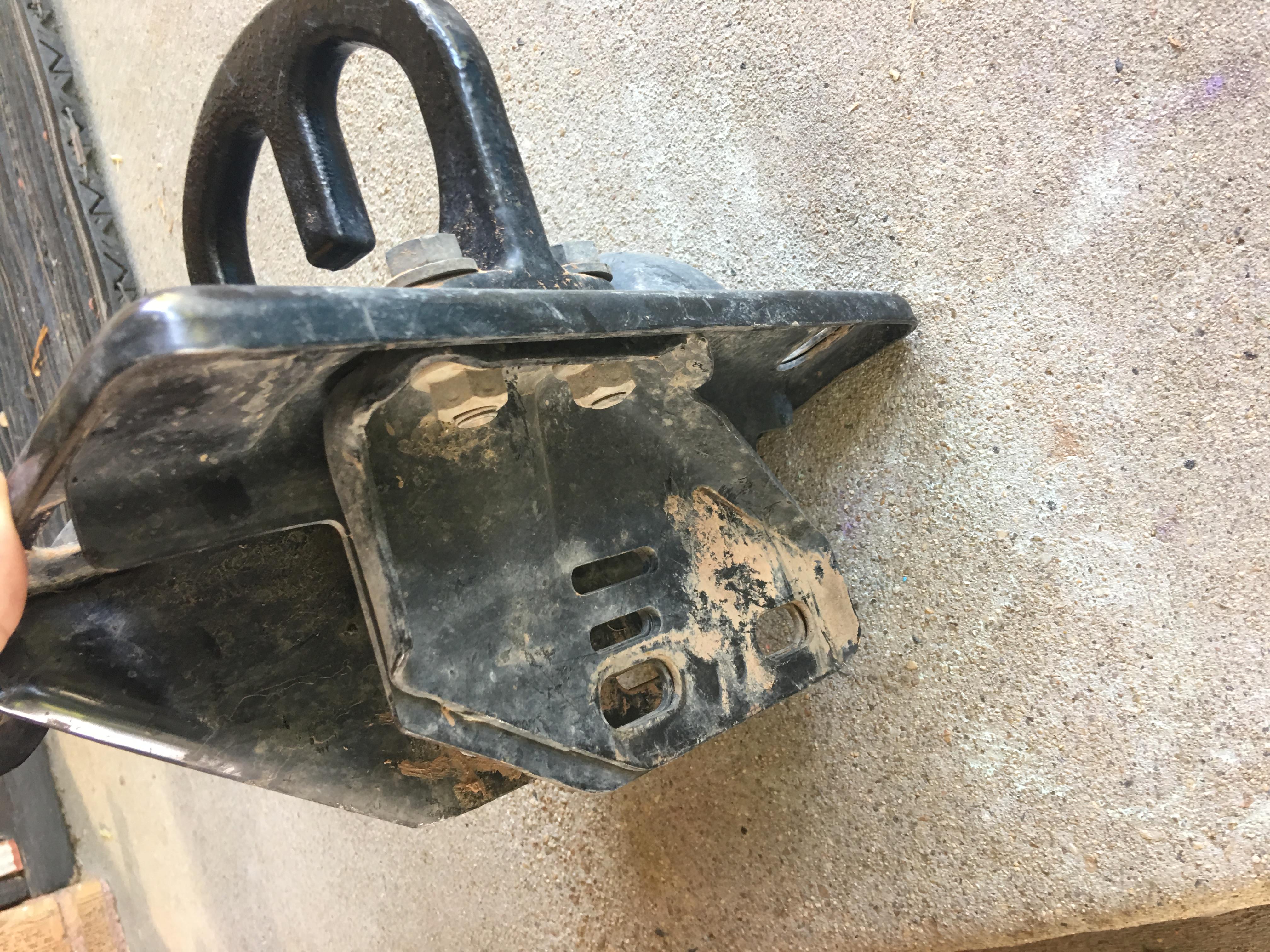

Another thing to consider-is everything just set on the surface of the plate and then welded? If so, you are completely dependent on the weld strength. If the square stock is through a hole in the plate and welded on both sides, that would offer a little more strength. That is how I would do it.
Our OEM hooks are cast as one piece, so the integrity is in the material, not a weld.

The stock tow points are pretty beefy and are more suited to off angle pulls than those. Plus, you can hook the winch directly to them without a shackle thereby eliminating a point of failure.
Re: Has anyone replaced their front tow hooks?
I agree. I've used the stock hooks as recovery points and hooked the winch back to them when using a snatch block. The only reason I was looking to change them is I wanted a way to safely lift the front of the truck using a high-lift once I am lifted and on 37s. The stock tow hooks don't really stick out far enough or engage well enough with a high lift. I can lift the rear using the receiver hitch with a shackle mount in it (although far from ideal).Colibri wrote:The stock tow points are pretty beefy and are more suited to off angle pulls than those. Plus, you can hook the winch directly to them without a shackle thereby eliminating a point of failure.
I went ahead and ordered these. I'll get my calipers out and take some measurements and inspect the welds as best I can. I also wanted to make a little more room behind the bumper so I can mount some Rigid XL lights on either side of the winch. The stock tow hooks interfered and I needed about 1/2" more clearance which got me looking in the first place.

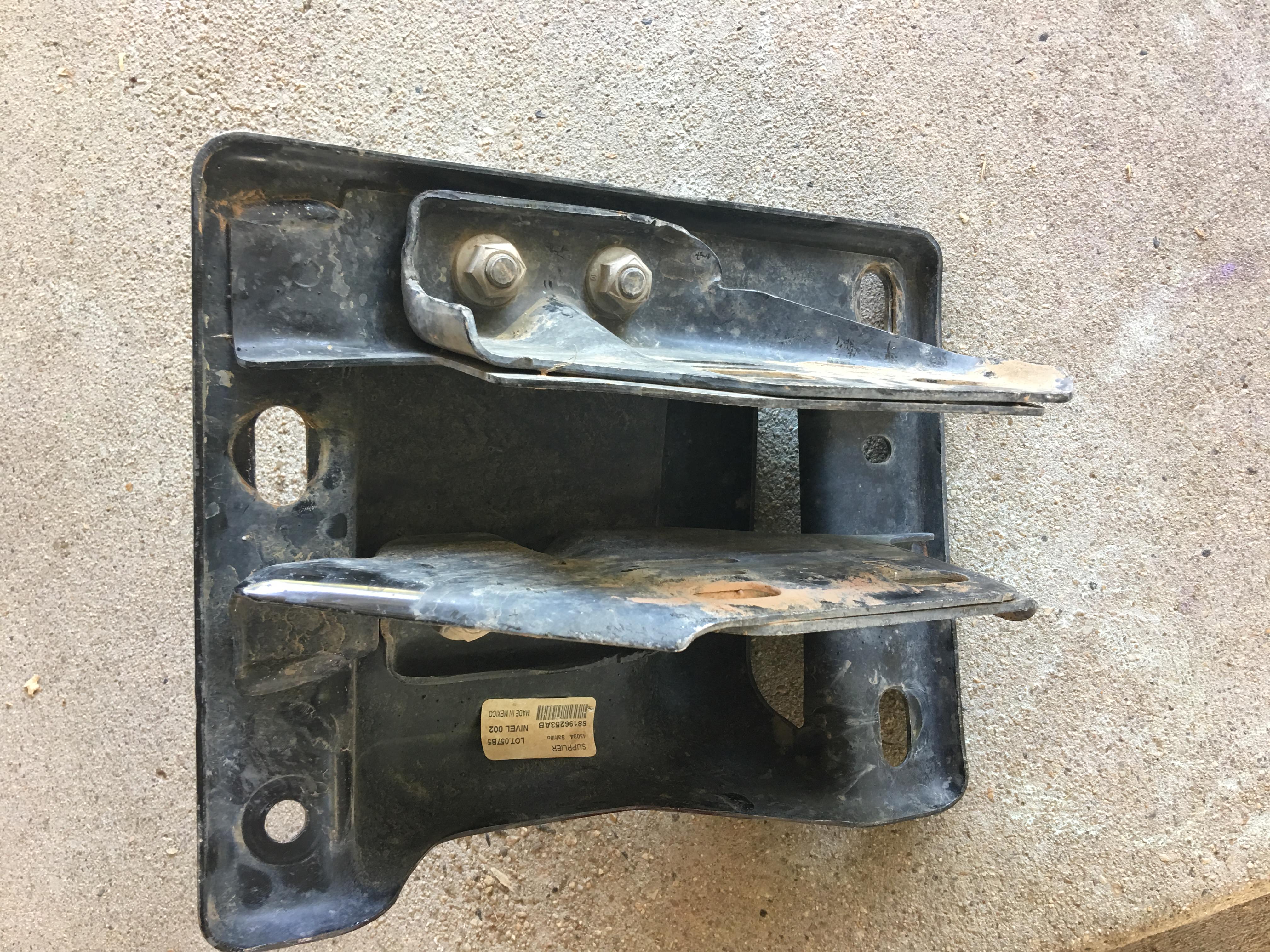

The tow hook isn't the problem, it's what they're mounted to that needs to be stronger.

The tow hooks mount to sheet metal. Look under your bumper. If you get pulled by your tow hook you will likely bend your bumper.

I took the risk and ordered them. I'm *hoping* that it's just because it was stick welded which would be appropriate for the thickness of material. My fear is it's crappy MIG done by a blind man. If so, I can return it for the cost of a USPS flat rate box.

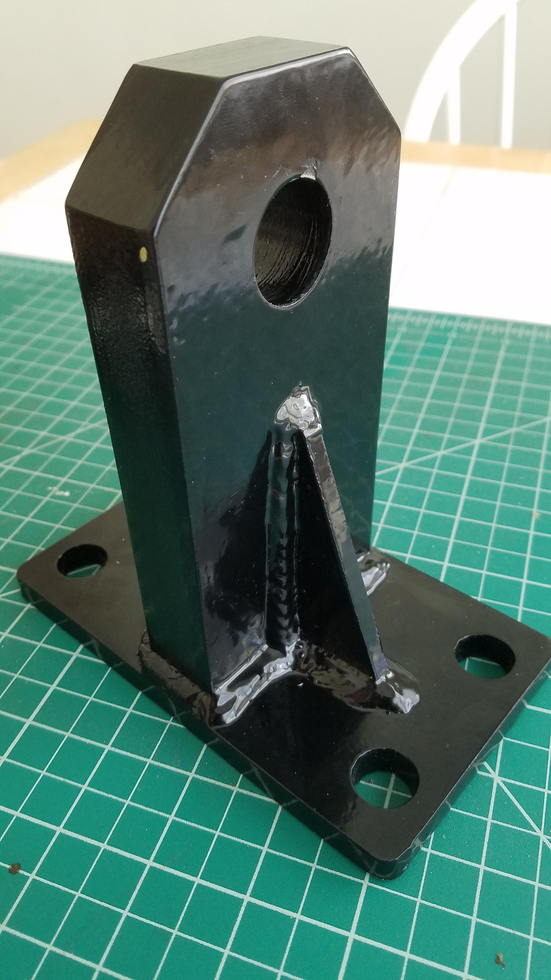

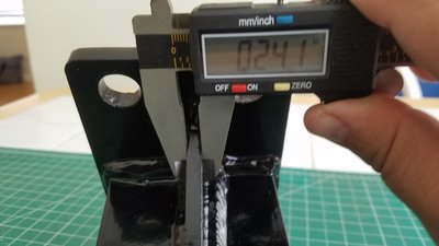

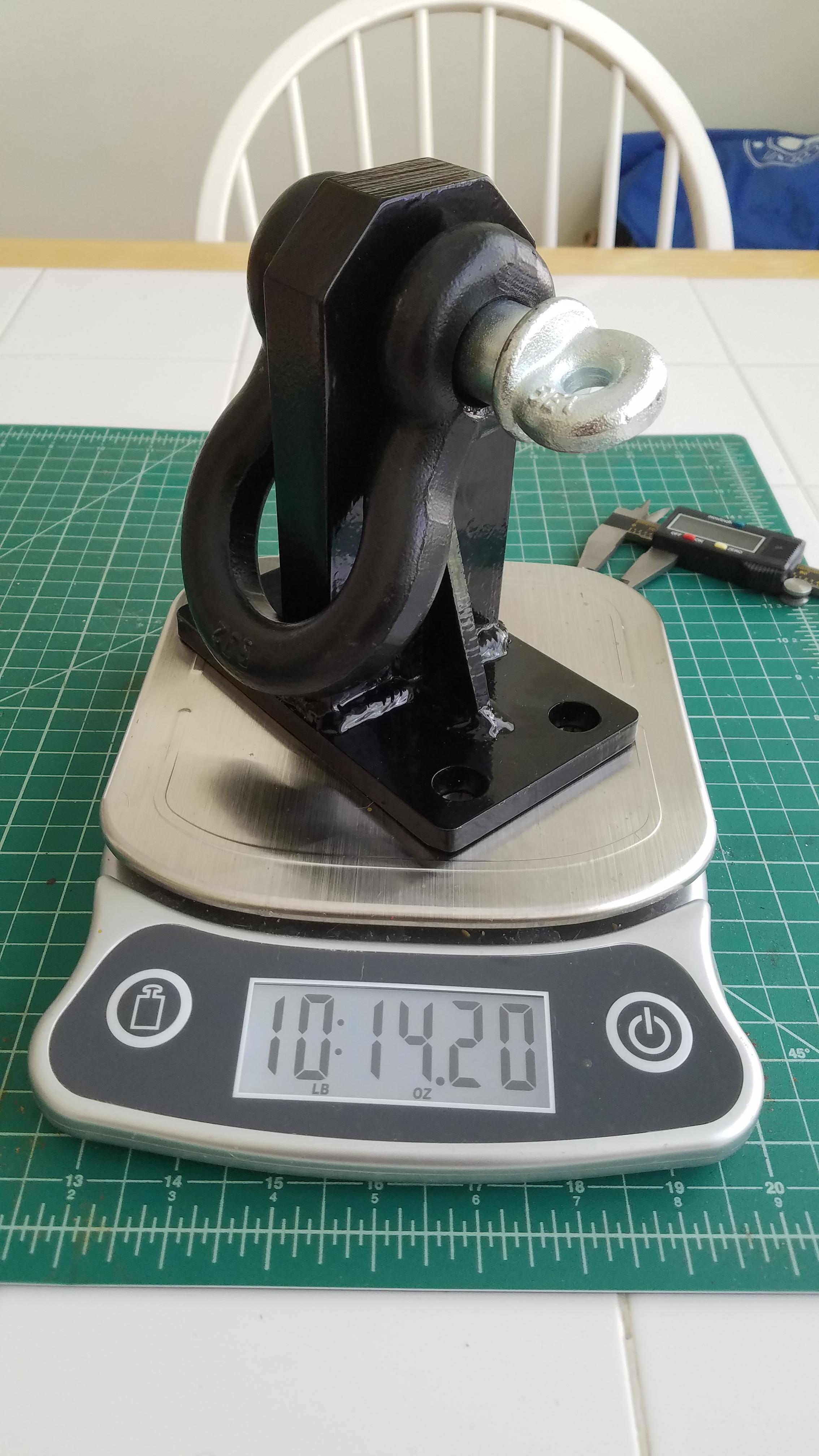

Well, I received the new "tow hooks" from Ebay today. First impressions? Well as my favorite youtuber says, she's definitely got some gravity to her. Nearly 11# with the shackle hanging from it. It feels incredibly solid.

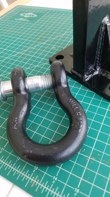

According to the seller, it is fabricated using A36 steel 1x3" bar stock welded to 3/8" plate. The gussets are 1/4" and fully welded. The welds were done with the hot glue gun of welders (MIG) and are not amazing looking but seem sufficient. There was definitely a lot of heat put into the part because the 3/8" base is warped across the long axis ever so slightly. I'm curious why they didn't use the holes to fixture the plate flat before welding. I suppose this is encouraging from a penetration standpoint, but as FirerescuePW had noted earlier, it would have been better to have the bar go through the plate and weld both sides.
I'm on the fence about mounting these in place of the factory hooks. While they would definitely give me the extra width I am looking for to mount lights inside the bumper and provide high lift points in the front that stick out a little further, I don't have a warm fuzzy about the strength of these though it is probably sufficient.
Worst case scenario - I got two 6.5T WLL shackles for about $100 bucks.
I'm not so big of a fan of how much leverage that shackle has. Maybe it's needed, but that hole would be better more towards the base.
The welds are strong but there should be more passes on the main bar coming out of the 3/8".
Cutting a hole through the 3/8" and welding the back side would probably weaken it rather than strengthen it. You would be taking away a lot of the meat of the 3/8 plate and replacing it with another member, and then even when you weld the back side you still have to grind it flush again. This still adds some weld bead but I wouldn't want to eat away that bolt plate too much to allow that big bar to fit inside.
That setup is probably stronger than factory in a straight pull. Factory is cast steel and very strong, great design, and I love that the Mopar "M" gives you a tow strap hookup... On the other hand, cast steel just brittle fractures rather than giving you some warning. That new bar will bend a little bit and deform the gussets/base plate before failure (if you see it in time).

Thanks for your comments. I agree on the additional passes on the main bar to 3/8 joint. I seem to recall the rule of thumb is a fillet the thickness of the thinner material being joined. As far as leverage goes, the hole needs to be that far out so the shackle can hang straight down past the bumper and doesn't rest on it. As far as construction goes, I'm inclined now to agree with you. I was thinking about a 1" square peg (cut shoulders on the bar) going through the plate and then ground flat after welding both sides to give some lateral rigidity but either way, that is more machining operations and cost. I think it's pretty beefy as is.DamageWagon wrote:I'm not so big of a fan of how much leverage that shackle has. Maybe it's needed, but that hole would be better more towards the base.

None of that even matters, the factory tow hooks exceed the strength of their mount. It only looks like they are frame mounted, the tow hooks and bumper mount to two sheet metal boxes. A high lift under the new shackle mount will pretzel the bumper and mount.DamageWagon wrote:I'm not so big of a fan of how much leverage that shackle has. Maybe it's needed, but that hole would be better more towards the base.

You're basing that on what?Reloaderguy wrote: None of that even matters, the factory tow hooks exceed the strength of their mount. It only looks like they are frame mounted, the tow hooks and bumper mount to two sheet metal boxes. A high lift under the new shackle mount will pretzel the bumper and mount.
![Popcorn :popcorn:](./images/smilies/icon_popcorn.gif)
However, based on how they mounted, I do agree they could shift and pretezel the bumper with applied force.
