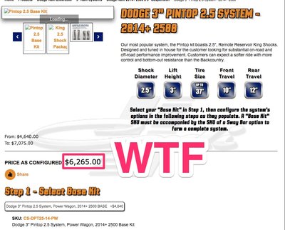

:rant: WTF? Why are there no good suspension options for the new trucks that aren't worse than factory? And don't tell me Thuren. His coils provide NO LIFT and are 20% softer than factory. So maybe a little more downward travel, but you're not gaining much.
Carli, oh man. Who the F do they expect to buy this system?
For $6265.00 you can have even less suspension travel than stock. (assuming stock is 13 inches each side) :doh:
It makes so little sense that no one is offering anything for PW owners. And the 3-inch and 6-inch kits for diesel guys aren't much better in terms of flex.

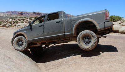

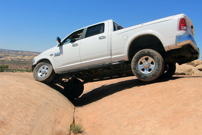

BTW, let's just answer the AEV Lift debate once and for all, shall we.
This is what happens when you go back to regular 2500 springs.
I'll let the pictures do the talking. Same obstacle, same line.
