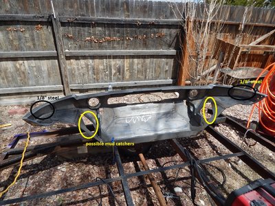

I don't want to post this, but I'm pretty upset about the overall quality. My high from Moab has come down. I left a few exchanges I had with Kye out of my original review in an attempt to be fair.
But the fact remains, the bumper is not production quality. The MIG work lacked proper penetration like the person didn't use enough gas.
I mentioned in my first review about the back of the bumper not being welded. That was a serious concern of mine. And I DID DENT THIS BUMPER in Moab because of a lack of rear reinforcement on the back lower half of it.
That being said, I am paying someone else and getting a lot of the welds fixed. Most of the welds on this bumper are of low quality with zero penetration in some places. Some places like the backside as I stated earlier weren't welded at all. I'm sorry, but THIS IS NOT PRODUCTION QUALITY.
Did I mention all the scratches in the metal? It's as if he used a hard abrasive disk to sand it.
The other thing I learned is that the owner doesn't actually build these. He hired someone else to do the work, and just designed the bumper. And doesn't seem 100% interested in growing his own business. There are some business end issues I had with my purchase. The main one being that when I asked about delays, I was treated like I was a hassle.
Evidence supplied.
Note, the person fixing my bumper had already begun grinding on things when I took these photos.
My final verdict, DO NOT BUY FROM KINZER OFFROAD.

Now as for the bumper itself, the finish work, needs A LOT work. It was welded and then the welds were ground down, but there are a lot of noticeable scratches in the metal that will have to be reworked. That being said, it was GOOD ENOUGH FOR ME. I already put a dozen +++ dings and scratches in the bumper while in Moab over the past 10 days.
The other problem I have is that the back side of the bumper was not welded. With what I want to do with this bumper, a couple good hits and you could get cracks in the welds and have a plate separate. Not good. I'd recommend and hope that he starts having the back side of the bumper welded as well as the front. That should increase the strength of the bumper.

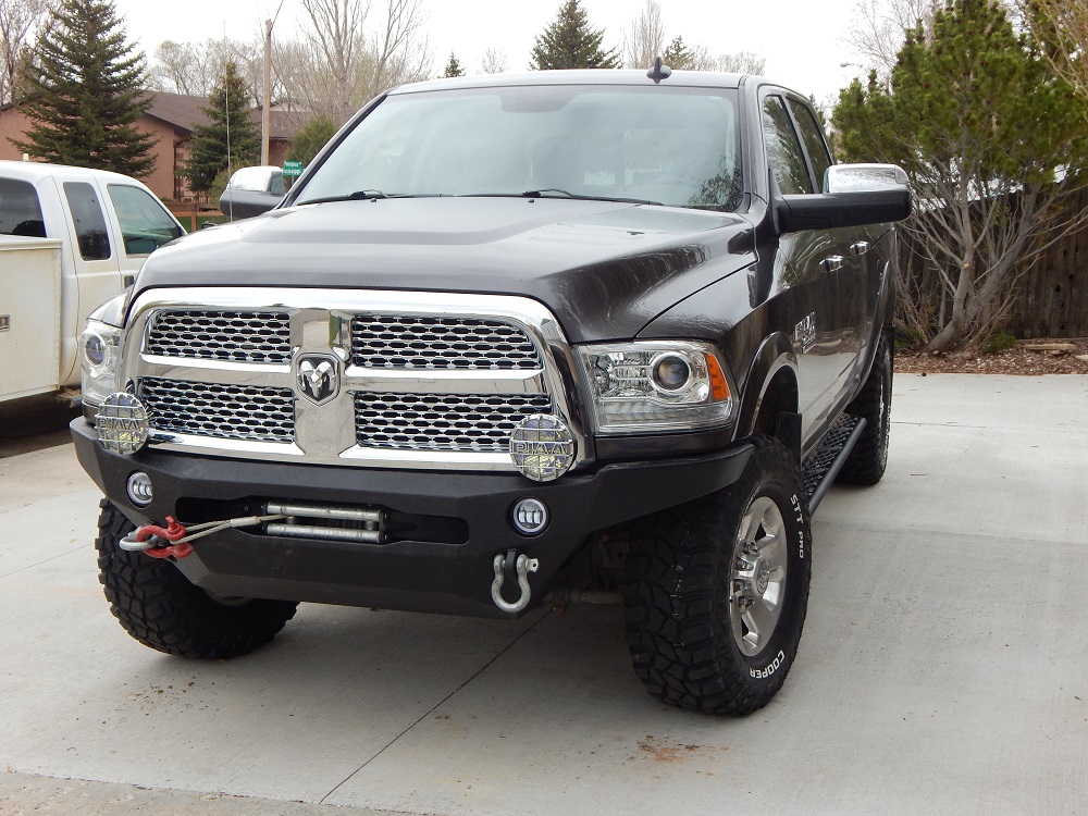

As for DESIGN, this bumper is EXCELLENT. THIS IS A REALLY GOOD LOOKING BUMPER. This is a truly great design. I have ZERO complaints and tons of PRAISE for the design and the ease of installation. Kye didn't provide instructions in time for my install, he did send an email. But it was so easy, I had it installed before he could reply to me. It's really self-explanatory. And very secure.
The bumper works as intended as a high clearance bumper. It will take you some time to learn the new approach of your truck. I have smacked mine a bunch. With your factory bumper, you're usually afraid to get up on things. So there is a learning curve since now you have a skid and high clearance in learning where the front of the bumper is when approaching.
Another nice touch is the full wrap-around protection the skid offers. The bumper wraps down and around the back. Really, very nice design overall.
One area that could use improvement is maybe to weld supports on the back side of the lower plate. I managed to put a good size dent in the bumper already.
Overall I have no complaints about design or functionality. Really, this could be the best aftermarket high clearance Power Wagon specific bumper. All that really needs to be improved here is business end process stuff. And for Kye to maybe, deliver on his promises with regards to lead time.

So as far as finishing the bumper, I'm going to get the back side welded. Then I'm going to get it blasted and powder coated.

And a few more showing off the approach, so nice.

Awesome review. Awesome bumper. It's hard for someone to have a fantastic design or idea and get it into production. The fact that he has made some and gotten them out albeit delayed speaks of his integrity. Being a small business with a good product puts you in a horrible uphill battle. Especially when it comes to startup costs. If he can get his business organization together and get his net costs down he will have an easier time. Get his costs below 60% retail and he will be able to improve the product and build his business.
I really like that bumper!! And it's costs are fully justified

Like that bumper. :rockon: As for welding the back side. I would do it. With proper settings for a mig. There would be little spatter to clean up. If the bumper is 1/4", 1/8" thick. Warping wouldn't be a problem. The reason for not welding the backside is cost of labor.

RustyPW wrote:Like that bumper. :rockon: As for welding the back side. I would do it. With proper settings for a mig. There would be little spatter to clean up. If the bumper is 1/4", 1/8" thick. Warping wouldn't be a problem. The reason for not welding the backside is cost of labor.
Bumper is 3/16” steel. About that welding the backside, my biggest concern for anyone thinking about it, is that the attachment points to the frame are in fact the shackle mounts. And they are only welded on the front it looked like. I'll be pulling the bumper off again when I get home. We are still in Moab for another week. And I will take photos of the backside.
I would think doing it himself might reduce the pay someone else costs. But if you can't weld, then ¯\_(ツ)_/¯
I can barely weld, not good enough to make a bumper, that's for sure. Up to Kye to decide though. If he sells more, I think you will be happy with the purchase. I am.

Is the whole bumper 3/16"? Most are 1/4" front plate, and the rest is 1/8". Some are 3/16".

I had mine sent to me bare steel so I got to look it over a little better that Mike plus I wasn't in a hurry to get it mounted. I had mine Line-x'd .
The bumper is 3/16" steel all around except for the part that curves(just the curve) around by the headlight I believe it is 1/8" steel. He also added pipe on the winch opening to make a rounded edge instead of a sharp edge in case the rope contacts it.
I did think it should be welded on the back side also (which I discussed with Kye). I also had a cracked weld on the front when I received it. It was on the top piece. I talked to Kye about this and he was not very pleased having used a certified welder to do the job. Due to the crack I pulled out the angle grinder and Mig repaired it and welded up the back side. The frame mounts are welded front and back. speaking of the frame mounts the factory bumper uses 4 bolts where the Kinzer bumper uses 6. He utilizes 2 of the existing factory bolt holes and the 4 bolt holes where the " factory fangs" are mounted . Very secure and strong mounting point. Again the engineering on this bumper is impeccable!!!

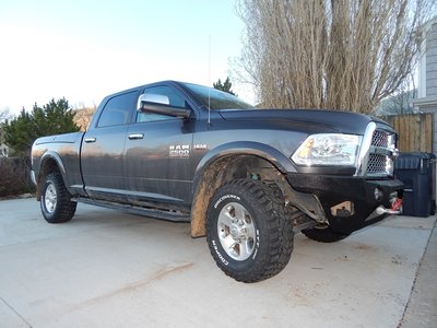

130lbs, I was able to simply deadlift the bumper into place. I held it up, wife slide bolts in. Boom, done. Surprisingly easy to install.
For as strong as it is, it's not real heavy. I do not know the exact weight of the factory bumper, but I'd say the Kinzer has about 30-40lbs on it when you factor in that you remove the factory bumper, lights, brackets, and the factory tow hooks. But that's just a guess from picking up the factory bumper.
I have Rigid Duallys right now. Not sure what I plan to do for the Kinzer bumper. I do like LED's, but I've been looking around and might find an OE 4 inch fog and install something like a Morimoto FX-R Projectors with HID's.
I also have a Rigid light bar that used to be mounted on the bumper. Still thinking about that. I'll experiment when I get back to Boise. We're in Moab until tomorrow afternoon.

I recently came across another option, but I see a few design flaws with it for that are shopping.
http://www.775fabrication.com/shopbumpe ... -2014-2017
I do see a few design flaws though, like how do you access the clutch lever for manual release of your line? And the plug cut out is... mhem. My plug died, this bumper would require removing to replace if yours went bad. With Kye's I was able to replace without removal of bumper.
I do like the angles on the lights, but it looks like it lacks some of Kye's protection. But it's another option for those wanting a bull bar too.

MikeKey wrote:I recently came across another option, but I see a few design flaws with it for that are shopping.
MikeKey, I have emailed 775 about this bumper. It is hard to see in the pictures but there are two diamond cutouts on the top face of the bumper to access the plug and clutch lever. Probably fine for accessing the clutch lever but you are right about the difficulty to replace a plug if it goes bad. It also requires a Hawes fairlead and switch to synthetic line. I'm considering this bumper too because I like the bull bar look but it still doesn't quite check all the ideal boxes. Haven't found that bumper yet.
