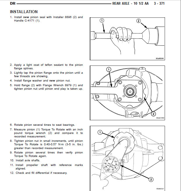

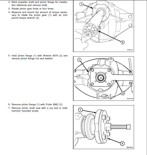

Does anyone have the factory torque specs from a service manual if I was to re-use the old crush sleeve?

Re: Rear Pinion Seal Leaking...
If you have a good dealer, they will be able to tell you both specs.
MSparks909
- Posts: 429
You da man Cruz! Thanks!cruz wrote:From FSM...
