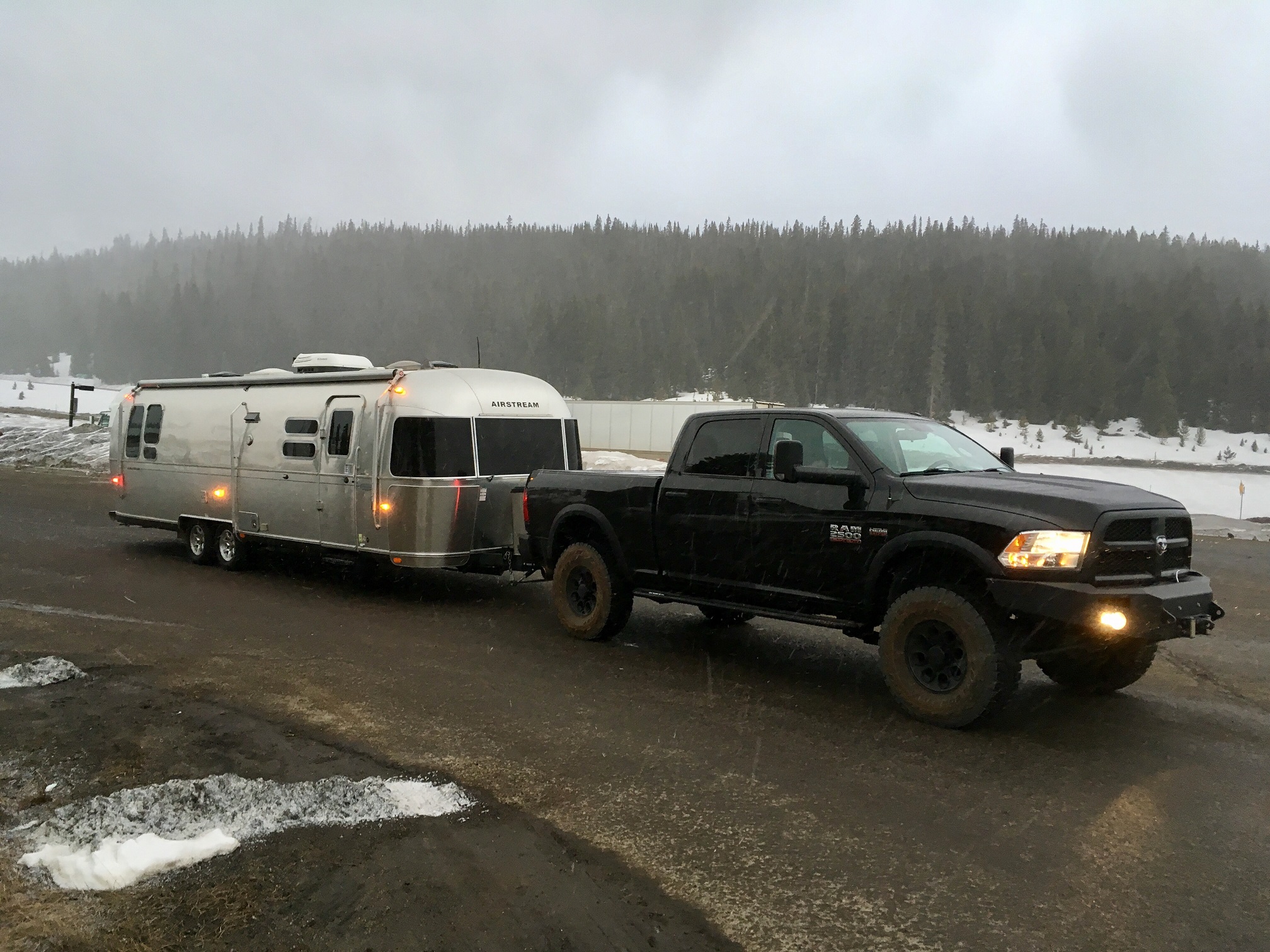

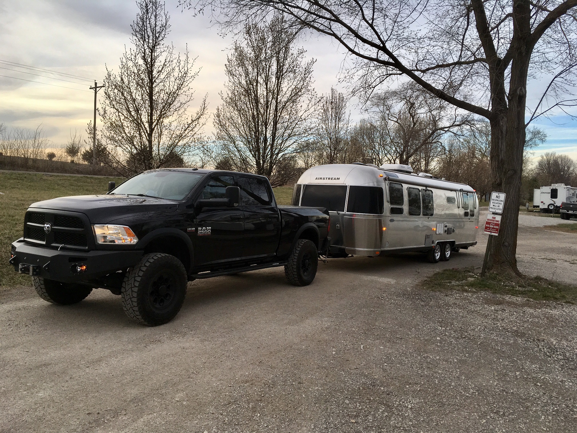

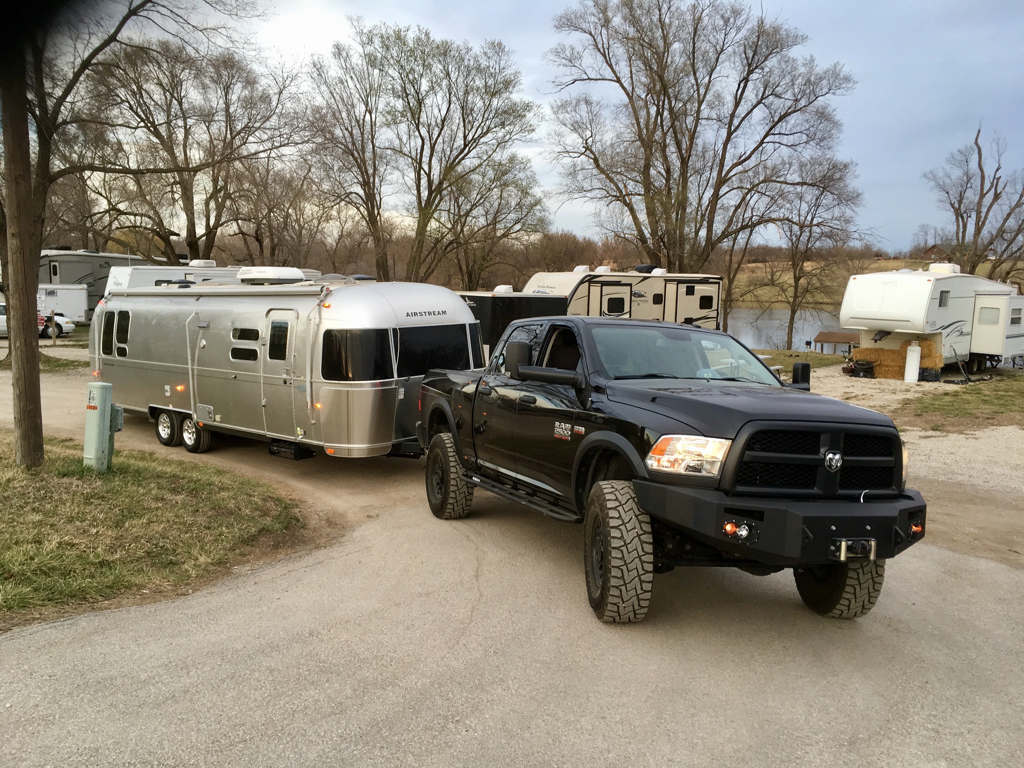

Here is an update to my experiences towing an Airstream with a Power Wagon:
1. I added the 3" AEV Dual sport lift kit. This kit puts the standard OEM 2500 coils on, and tosses the PW coils. This was a substantial improvement. I highly recommend it for safer towing. The squat in the rear went away. You can see in the pictures the 800lb tongue weight no longer compress the rear like it did stock. Additionally, the front end is no longer effected by the rear squat. The stock set-up made my steering very light (un-weighted), which wasn't safe. However, the: handling, driving, cruising, hitting bumps, and undulations all improved after the lift was installed.
2. The lift also came with a 37" tire upgrade. This was great around town, and even good during flat towing, but it sapped energy when climbing hills like the I-70 "Vail Pass." The stock 4.10 axle ratio is intended for 33", and works. I got away with 34" tires for a while. But, 37" tires require at least a 4.56 axle ratio. My transmission overheats (i.e. goes above 200 degrees) during heavy hill climbing.
So, that is where I am at now. I either have to re-gear to 4.56. Drop my tire size back to 285/70 R17, or purchase a giant transmission cooler...MTF.
8,800lbs loaded 30' Airstream
AEV lift kit significantly improved vehicle handling while towing.
Going over the I-70 Vail pass a couple of weeks ago. I learned that the 4.10 axle ratio is too high when towing with 37" tires, and a 6.4L V8.
2015 RAM Tradesman PW: White Knuckle Sliders, FAB FOURS premium bumpers front and rear, Magnaflow #19200 exhaust. K&N cold air intake.
Suspension: AEV 3" lift w/ OEM 2500 springs.
Tires: 37x12.5R17 Toyo Open Country R/T, mounted on AEV 8.5" wide Katla wheels. Corrected Ring and Pinion gears: 4.88 Yukon (front), and 4.88 AAM (rear). AEV differential covers (front + rear). Thuren XHD swaybar endlinks.

So, I guess that I should clarify on the overheating issue. I only had two incidents where the transmission lagged on shifting, and the throttle got strange and mushy. It has only happened twice in the 42,800 miles life of the truck (got 37" tires just this fall). It is also important to note that the automatic transmission fluid was at the end of its lifespan. I just had the transmission serviced and ATF fluid flushed at about 42,000 miles. It felt brand new afterwards. I also replaced the ball joints, which were worn by 40K (you'll get there too-FYI). I have learned that the fresher the ATF fluid the less frequent these incidents are. It also is true that the more incidents like this that you have also decreases the lifespan of the ATF fluid, and most likely the lifespan of the 66RFE transmission as well. So the two incidents were:
1. Driving the trails around Moab in 4-high all day. I was finishing up the Gemini Bridges trail after climbing up the little canyon trail with 4 adults in the truck (probably 50 miles off-road), and the transmission got temperamental as I was driving back down the highway to Moab.
2. And then going back over the Rockies (I-70) on the way home the same thing happened. And of course this was my first trip since installing 37" tires. They do seem to heat things up. The ATF flush resolved it all. But, I would most likely have those issues again if I repeated the trip now. Currently I am commuting around town in the truck, and of course it works perfect. I have plenty of power when unloaded, and I have the AEV procal with spot-on shifting. Also driving flat across lower Colorado and Kansas had no issues.
